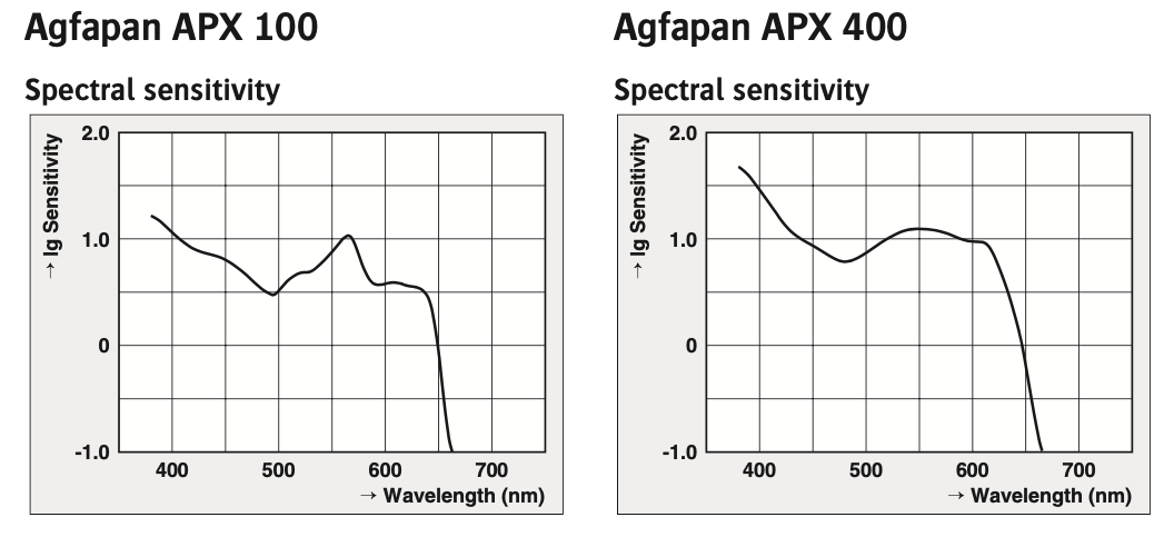

This is Rollei RPX-100 which is reportedly the same film (not a great/full chart):
Here is RPX-400
EDIT: See thread below, these are NOT LEGIT CURVES

Hmm, actually I am wondering now if those are legit at all. They sure look like they are copied from the original Leverkusen Agfa APX-100 and APX-400:
There is a lot of film flam in Rollei including the name. I don’t see why they keep it up and not just call it Maco, or buy back the right to use the Agfa name (can’t be more expensive than Rollei).
The bitter truth is that you cannot trust Maco Photo (Rollei-Film brand) at all concerning "data-sheets". They don't have any technic staff there, it's a pure distribution company. They just publish what they want and fits their marketing ideas. You can completely forget it.......
For my clarification, relistan: 1. The above are the sensitivity charts for former APX 100 and 400 made by the now defunct Agfa company?
2. What is the connection between these films which I thought belonged to the new AgfaPhoto company who do not make films and the now defunct Agfa films made by the former Agfa company?
3. Who makes the "new" APX 100 and 400 and whoever that is, has it copied the former Agfa films spectral sensitivity
4. Is this the same spectral sensitivity as the Kentmere 100 and 400
I am thoroughly confused by the whole thread in terms of who does what and which films have the above spectral sensitivity
Any clarification on the above 4 points is much appreciated

Sorry I was attempting to say that I think the original charts I posted, that Maco put on the RPX films, are not legit. Those films (Kentmere, RPX, AgfaPhoto APX—NOT the Leverkusen version) are made by Harman (they are all Kentmere) and there is no way that their curves should match the original, actual Leverkusen AGFA APX-100/400 curves.
SO: ignore those charts, they are not legit. Maco has put some untruths in the spec sheet.
I got suspicious looking at the charts I had posted, thinking they looked familiar. And they do. They are from a completely different film that has no relationship to these films. But Maco put them in the spec sheet.

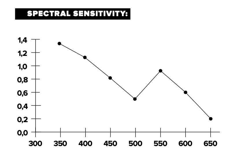

Andrew. here's the Greg Davis review of Kentmere 400 in casethis helps inwhich he shows a comparison MacBeth type chart I can't find any review by Greg on the 100 but it may exist The chart is shown after about 3 mins 30 secsI'd have thought that the spectral sensitivity of both the 100 and 400 are the same but I may be wrong in this
