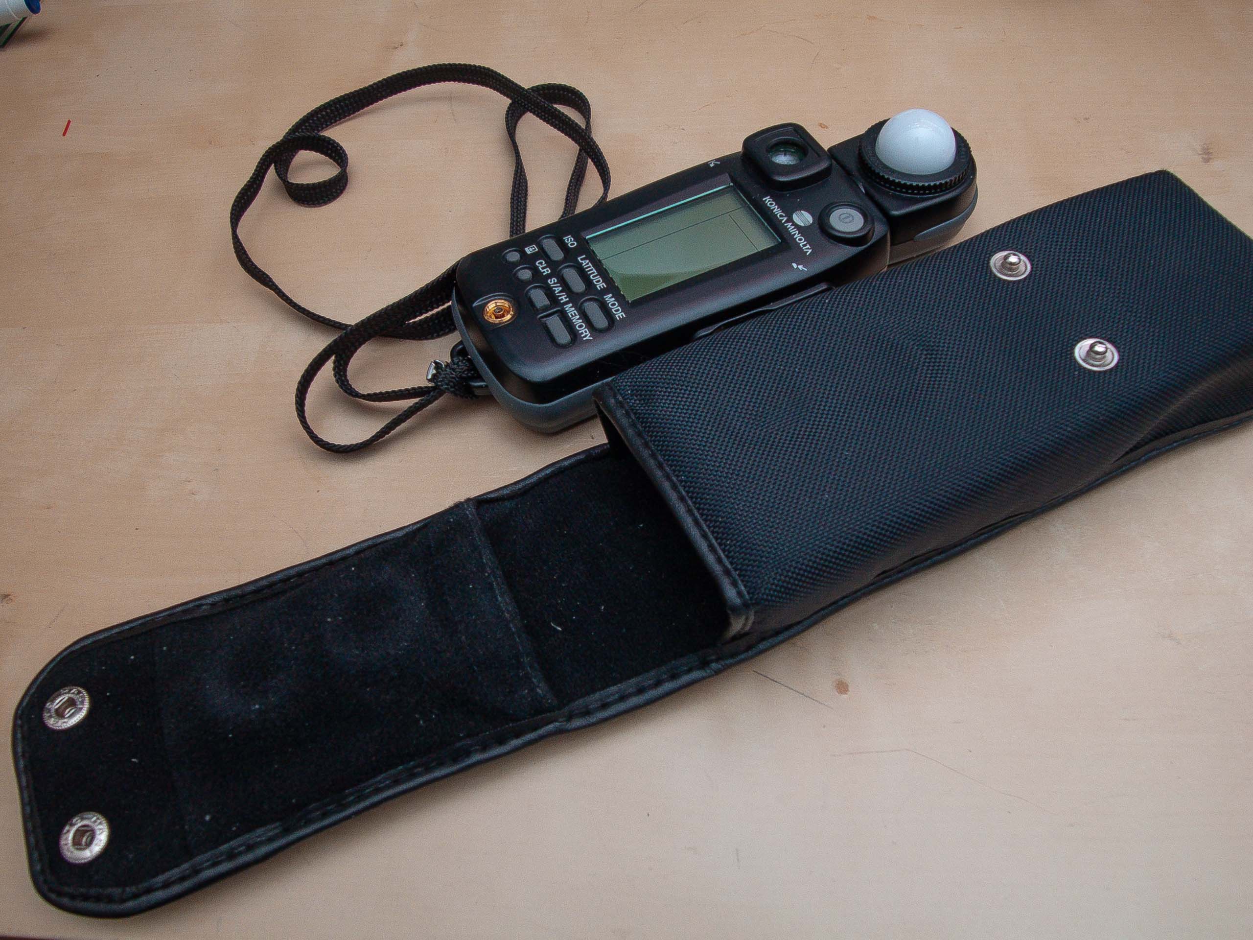

I:m confused. Your first post said Minolta VI, your second post indicates a V1. If you had the VI I assume that would be better than your other Minoltas. The V1 appears inferior.
As you can see my Minolta Flashmeter VI looks like the Kenko KFM-2100. Minolta never made an Autometer VI nor Autometer VIf. It has a pocket in the flap which I could store the flash diffuser and the reflective attachment there. However, the meter is not designed to use the reflective attachment.
