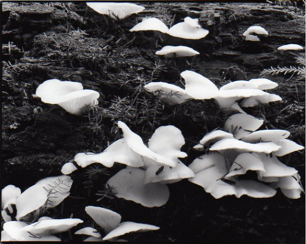

So to print something like this, do you need masking? Looks very Ansel-like.
The purpose of masking is to bring out local contrast? Lets say to separate the shades in the shadows. But this will flatten the overall contrast right?
never mind about the color, it was another picture.
I believe that one was printed before I started masking. I would leave that one as is...the dark areas retain enough detail, but are dark enough for the fungi to 'float'.
As I recall, the fungi were nowhere near white, but were a milky light yellow. The exposure was long (more than 5 minutes?) so I placed the shadows were I wanted them, saw the fungi fell around somewhere around Zone VI, then developed the negative normally instead of adjusting development for reciprocity law failure.
This was something I often did in deep, dark, rainforest scenes because it sort of resulted in normal development for the dark areas, and because there was nothing even close to white in the scenes, all the tones around Zone V and VI effectively got something like + development.
That's what lifted and separated the high tones in the fungi in this print.
