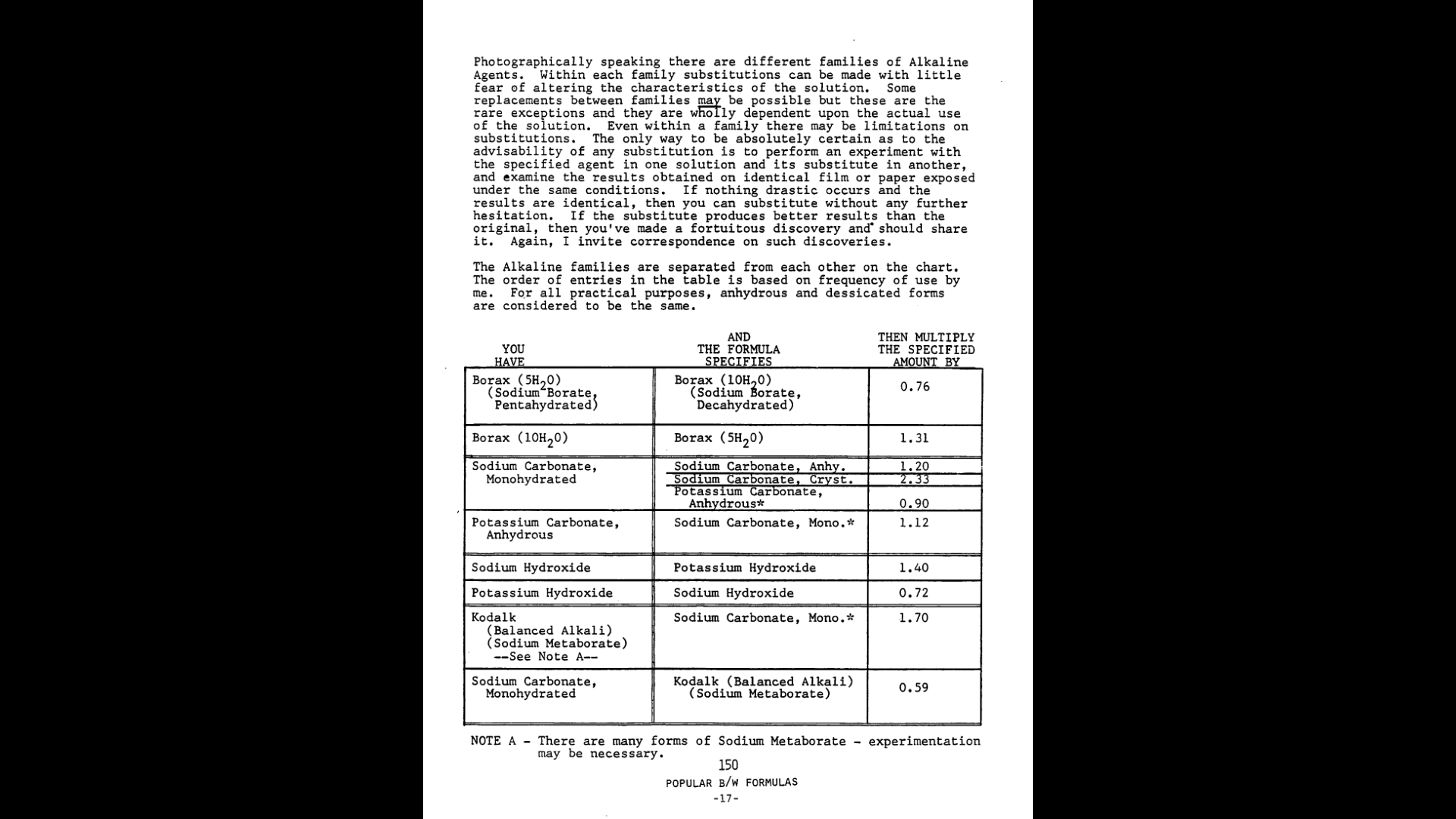

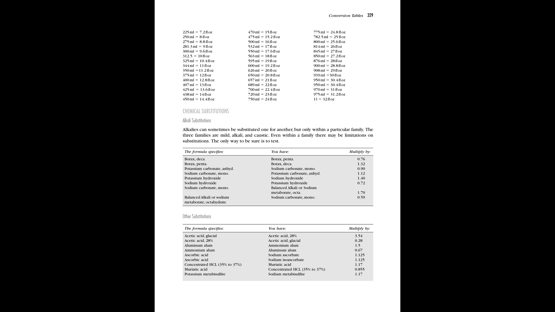

it says: you have: potassium hidroxide, the formula specifies: sodium hidroxide, multiply the specified amount by: 0.72, quoting dignan, but cookbook is the same...

Multiply by 0.72 to convert weight of KOH to weight of NaOH, divide by 0.72 to go the other way.
22.5 / 0.72 = 31.25 which is basically the same as Raghu's result (31.5).
The ratio of molecular weights is 0.7128 (NaOH weighs less) so if you have KOH you need to use more to get the same amount of hydroxide ion, which is what does the work.
Getting precise weights can be a challenge because both chemicals are hygroscopic.

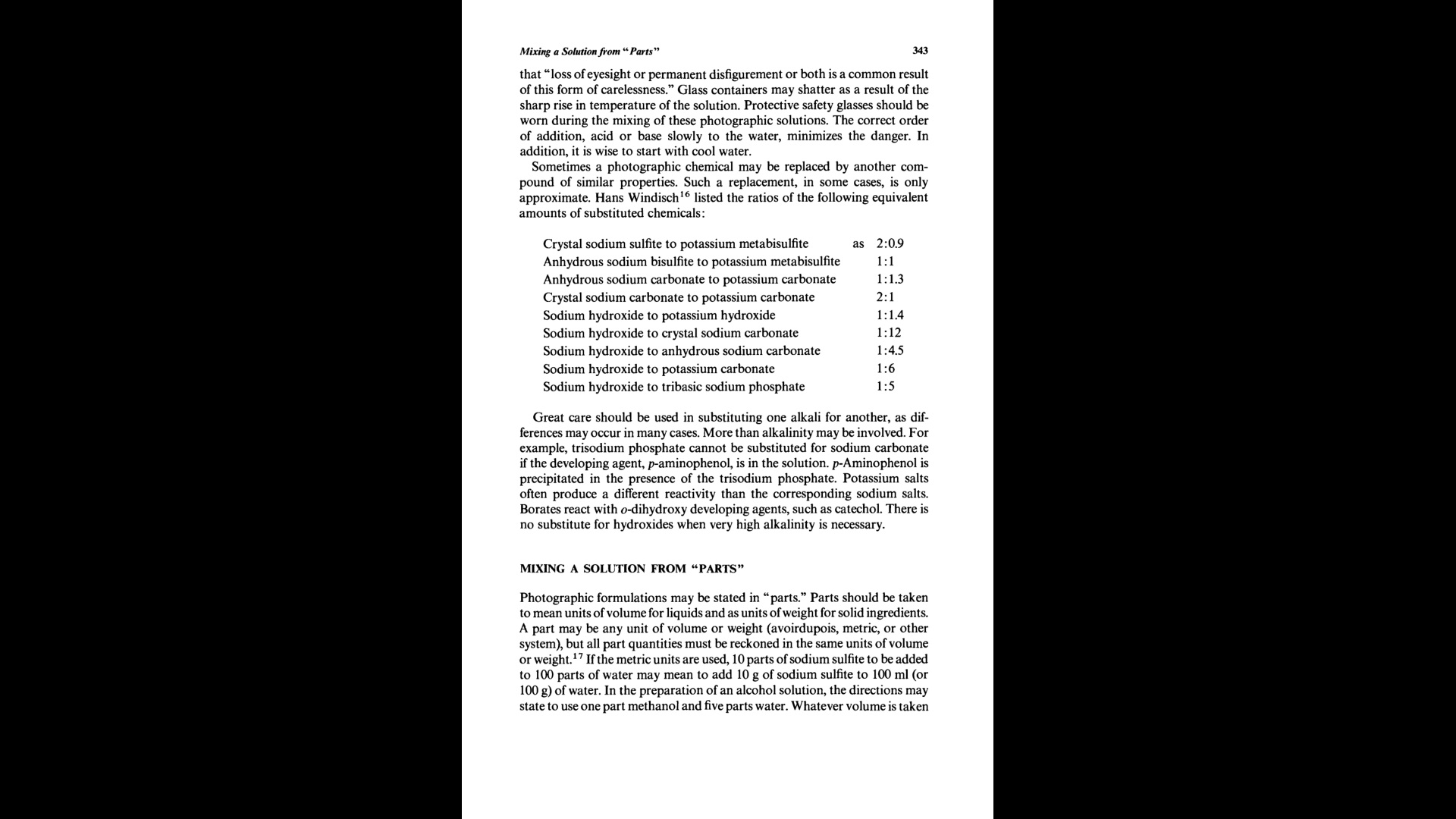

i have been checking in other sources and some are correct, but darkroom cookbook has it wrong in the two editions i have...Grant Haist quoting Hans Windish in the first volume o modern photographic processing, has a correct equivalency table!

1 mole of NaOH = 40 g of NaOH
Therefore, 22.5 g of NaOH = 22.5/40 = 0.5625 mole of NaOH.
You want to substitute 0.5625 mole of NaOH by 0.5625 mole of KOH in the Kalogen formula.
But 1 mole of KOH = 56 g of KOH
Therefore, 0.5625 mole of KOH = 0.5625 * 56 = 31.5 g of KOH.
You need to use 31.5 g of KOH as substitute for 22.5g of NaOH.
