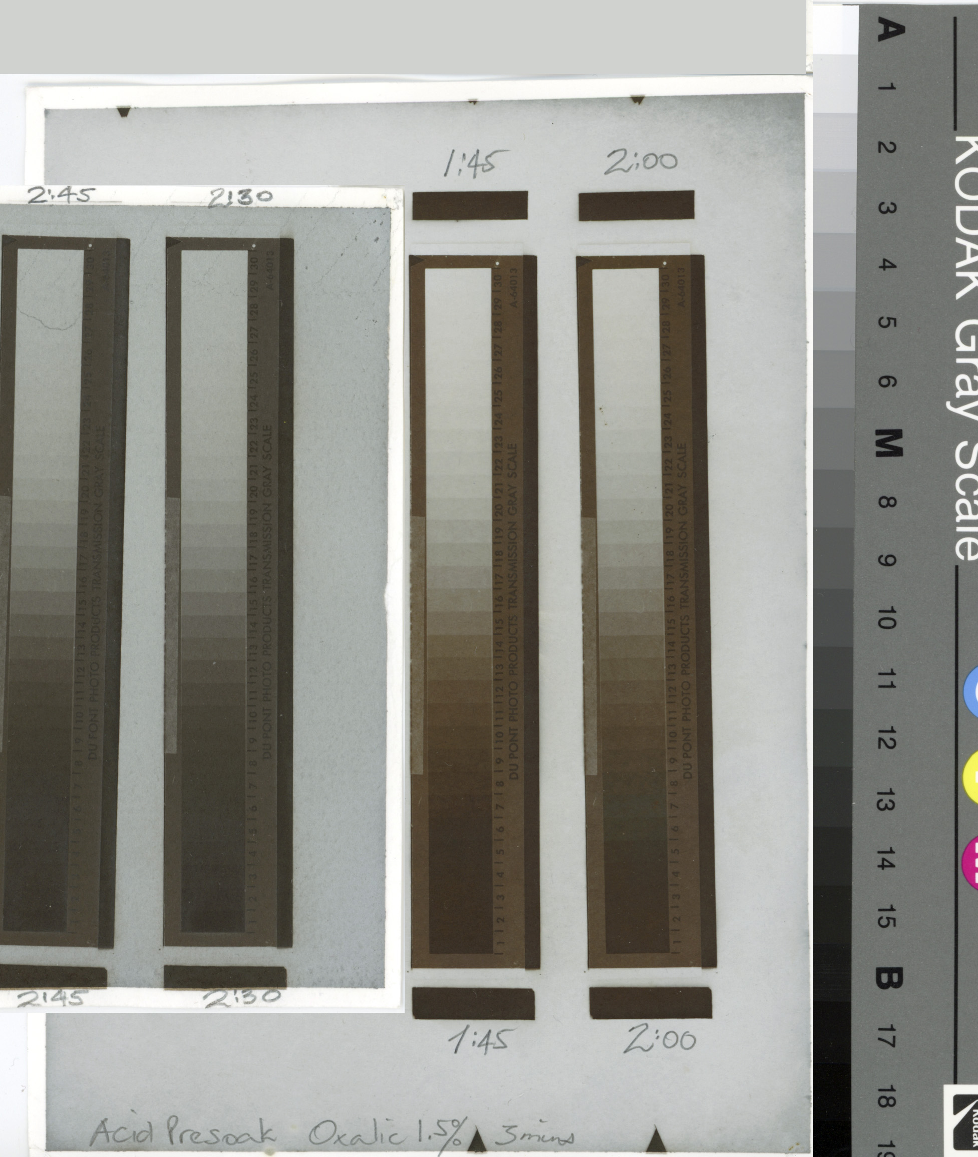

On going search for solution, here attached new test after 3 min presoak in oxalic 1.5%.
Improvement but still quite high "fog" level in unexposed areas into the highlight region.

What paper did you use? Where did you get your sodium acetate, ferric oxalate, and silver nitrate? If you mixed the solutions yourself, did you use distilled water?
Looks like a chemistry problem. I'd mix up a small amount of everything and retest. Replace one solution at a time so you can isolate the problem.

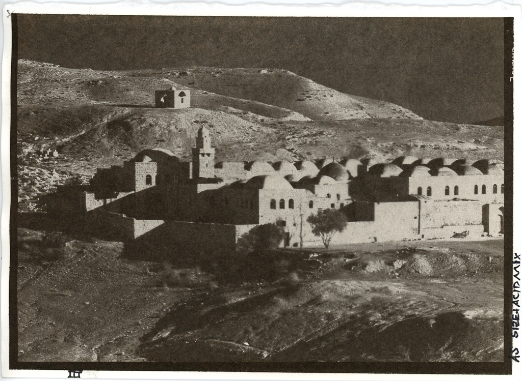

Update on the grey background problem I had. This was due to the Ferri-Oxalate and getting it into solution.
I eventually (4-5 attempts) figured the best way was to grind down the crystals till almost a powder in 2 batches, with addition of oxalic acid slowly added the powder without heating and stirring continuously into the water & it went into solution without difficulty. Now I just have a very faint yellow stain which doesn't bother after what I was getting.
Attached first decent attempt, now can go ahead an fine tune.
Thanks all for the input!
