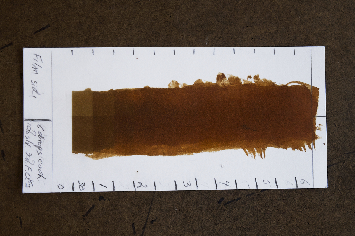

Last exposure on the max black test should be done by now.
As far as using TF3 goes, it looks okay. Abrupt darkening as people have been saying, and lighter tones don't bleach. Dimroom lights test okay too.
Getting a satisfying black, however, is turning into a baffling exercise.

At about 45 seconds of exposure mine are going squirrely.
My led light strip UV light source was giving a minimum max black time of 12 minutes for salt prints. For some reason my test strips are only getting to about a print value of about zone IV, then with more exposure the strip actually goes lighter in tone to about a print value of zone VI. The colour is what I'd call mushy plum.
Too many moving parts. The dried coat was a suspiciously lighter yellow than what I've seen on yoo-toob. Will probably dump all the solutions and mix up new ones tomorrow. I'm 99.99% sure everything was mixed right, but to remove all doubt it's probably best to start from again from scratch.

Earlier in this thread you called Kallitype's a "voodoo world" and I'm beginning to understand...some of the max black test strips I thought were horrible yesterday darkened up quite a bit to a nice chocolatey brown after drying overnight. and lost their mushy plum look.
Things got pretty dark at 45 seconds, appears to stay about the same tone for a while, then goes quite dark at 6 minutes.

Here is the max black test strip I made this morning at 30 second steps and a zero exoposure to make sure it was clearing. Not toned because the gold chloride I had was made into a 1% solution for salt prints. Also, added some extra ferric oxalate (15g instead of 10g in 50ml) to solution B last night.
The first one is straight out of the final wash.
The second one is after being dried by a fan for a couple hours. I expect it to get darker by tomorrow.
Was not expecting that much of a change!
Murray, it's hard to say from an online scan but it looks like your max black is somewhere around 2 minutes.
