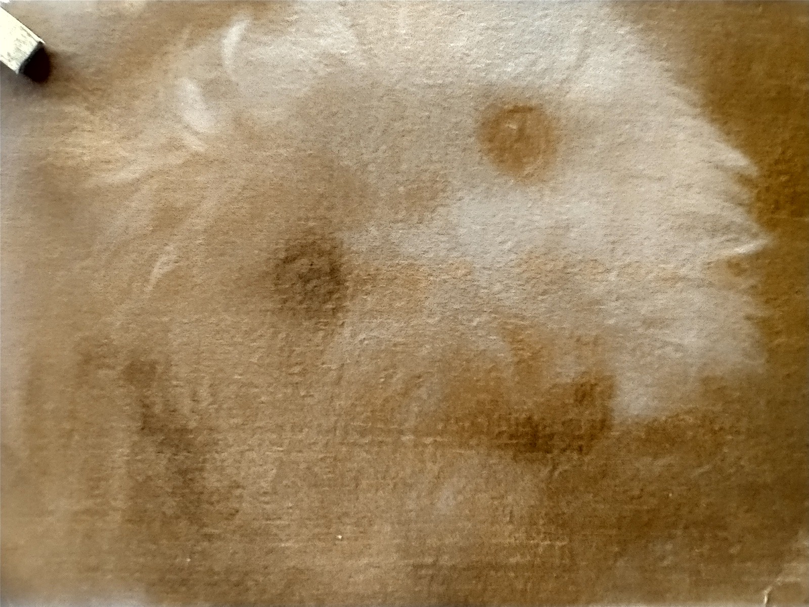

Update.
I got a negative that I use for testing (without a curve), cheap canson paper and kept the solutions in a warm water bath because last night was too cold.
I developed with a solution of 48gr Borax/36gr Sodium Potassium Tartrate in 500ml of water. I washed the print before clearing (this is something that I skipped last time) and put it in a very short clearing bath of 3% citric acid. Image still there without any major changes, only slightly lighter. Washed thoroughly and put in 50gr sodium Thyosulfate/12ml ammonia fixer for 5 minutes, then washed again. Image still present!.
The variables I changed were the washing before the clearing and the temperature of the solutions. The problem now is that the print is too orange but I am using a black developer. I'm sure this happens because of the dichromate. The image I uploaded is actually darker and more orange.I'm going to get rid of the solutions unless there are other creative possibilities. The good thing is that my city takes care of hazmats even during the pandemic.
Thanks.

I never had problems with dichromate, but in the developer! Fixing bath I think is too longer! it is always advisable not to exceed 1 minute due to fading problems that thiosulphate normally causes on the print. Certainly the addition of dichromate in the sensitizer did not help. So basically I will redo the solution and it should be fine.
