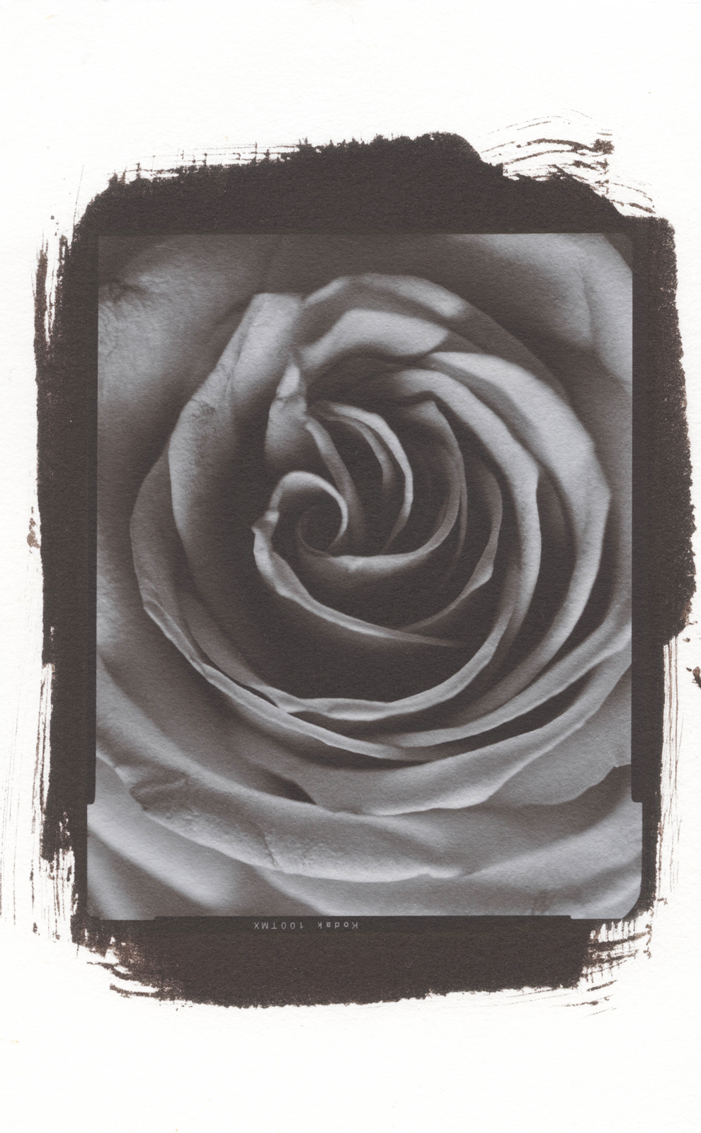

Since you all helped me so much getting started, I wanted to share my first ever kallitype with you. It is far from perfect, but it is recognisable :wink:
I liked it enough to apply gold toning before fix. Thank you all so very much, I am definitely in love with this process. Just need to learn how to enlarge negatives now I guess
since 4x5 is the max size I have for now.
Andrew O'Neill
Jan 16, 2004
13,054
Coquitlam,BC Canada
I asked some questions about it in the Standard Gallery… I'll ask them here, too. Which developer and paper did you use? How did you find printing with TMX? I was under the impression that it was not a good candidate for alt printing due to its UV blocking layer… or maybe you just have to extend the printing time? Very nice first print, by the way.
