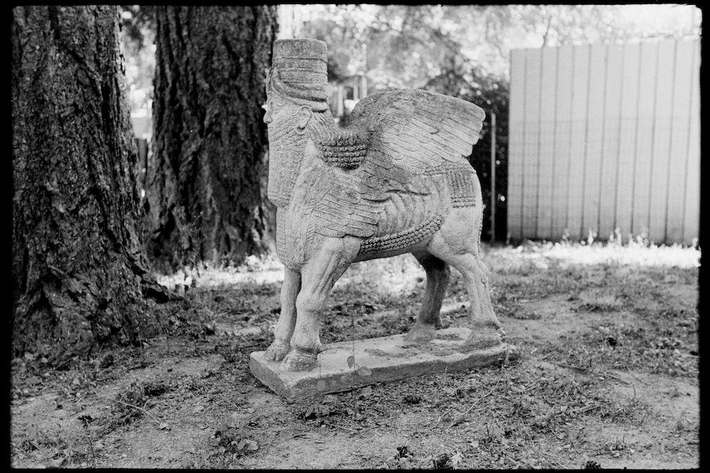

Knew something was up just from looking at the negs hanging in the bathroom. I've never seen negatives like these. These sorta glow, as if lit from inside, and talk about sharp! N8008s w/ 90 Leicaflex lens, Y fltr, shot at f2.8-f4 (EI 64, the camera takes off another f stop for the filter)) dev in F76+ 1:8 for 6:15 minutes. Time to break out the Ilford FB papers.

This is a fun film, for sure. It won't work for everything, I still like the looks of Tri-X, the Foma films, etc, but what's surprising about the Delta 100 is the tonality. It's really good, w/ clean highlights and deep blacks. I've tried Tmax a few times and didn't care for it (probably didn't shoot/develop it right). The Delta 100 looks nothing like Tmax to my eyes. I'll try the Delta 400 now, which some people like to shoot at 800 and higher.
Of course, this 1 roll cost almost exactly what 2 rolls of Foma would cost. Is it worth the double price? I'd say that it certainly is at this point.

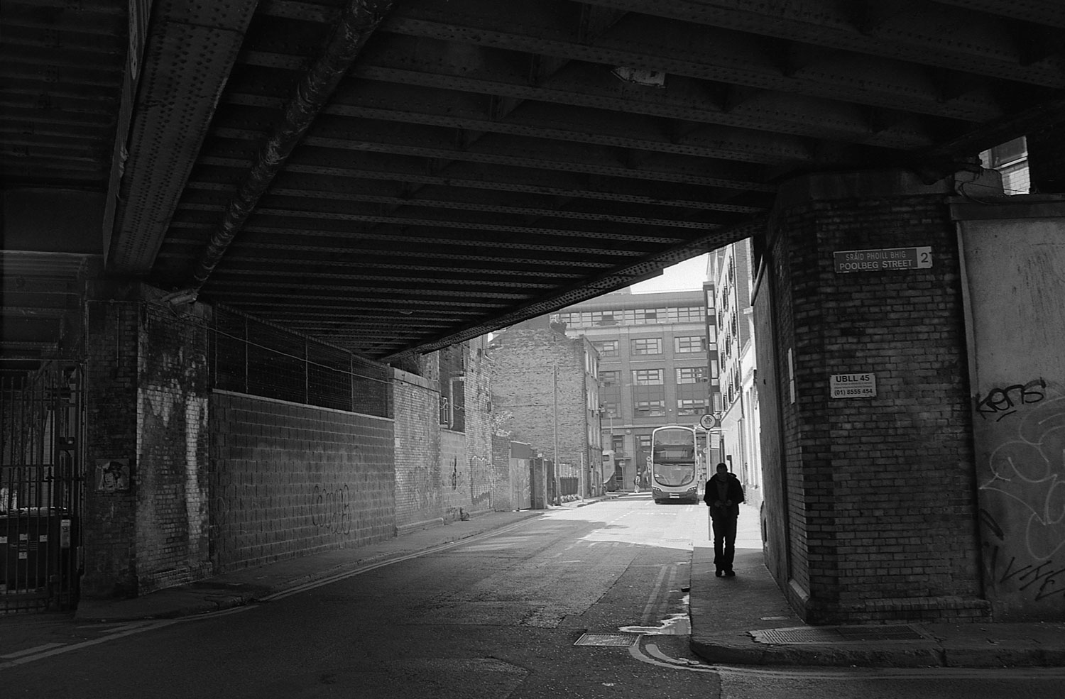

I've been using T-Max forever but when Kodak changed the formula for HC-110, I decided to try some Ilfotec HC. I bought ten rolls of Delta 400 to give it a try and once the T-Max is gone this may be my go to film. Here's a not too exciting example from a Kodak Retina IIa using a Reveni Labs meter. Exposed at ISO 320 and developed in Ilfotec HC diluted 1:15 and developed for 4 minutes. Scanned using a Sony A7II with the FE90G 2.8.
