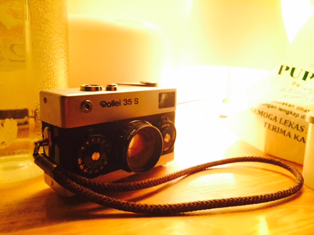

Hello everyone,
This is my first time posting on APUG Forums, although I have read many articles and threads on this forums before. Anyway I am a student who just received his grandparent's cameras, including a Rollei 35S. When I received it firstly I tested the shutter speeds and all shutter speeds seems to be quite accurate (based on my young knowledge on analogue cameras), except the 1/2 second might be a bit long (although it now sounds more accurate, probably due to exercise).
Anyway, I checked on other parts of the camera and finally noticed a few problems:
1. Viewfinder is hazy
2. Sonnar lens is contaminated with fungus (I live in a very tropical country)
3. Filter is stuck on lens (with fungus and haze on the other side of the filter!
4. Light meter probably not working

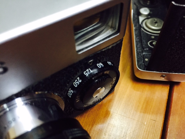

5. (Just discovered this a few days ago) When the film advance is cocked, I can't move the shutter dial from 1/60 to 1/125, except after shutter is fired, then I can move the shutter speed past 1/125.

Fungus on a lens cannot be "cleaned". This is because the fungus actually etches the glass. So even with the fungus removed, the lens itself has been physically damaged. Just killing the fungus is very easy - open the shutter and aperture (and the film door), then put the camera in direct sunlight (with light shining thru the lens). UV light kills fungus almost instantly.
That doesn't look like fungus, fortunately. It's probably oil from the aperture blades. If you pry the black outermost front trim ring w/ the serial numbers off w/ a small screwdriver or a knife (it is just glued on), you should see 3 screws under it. Carefully remove them and set them someplace safe (best to work on the camera on a towel on the table w/ good light and a magnifying glass). Carefully remove the focusing ring, and from there it should be evident how to get the lens element out and clean it w/ alcohol, then wipe it off w/ lens cleaner solution or just a very clean cotton cloth. Reinstall the focusing ring in the same place you took it off w/ the 3 screws, and the trim ring goes back on w/ a dab of non hardening glue. If you don't want to do it yourself you might try these folks

You have to cock the shutter, press the lens unlock button on top of the camera, extend the lens, then set your shutter speeds.
