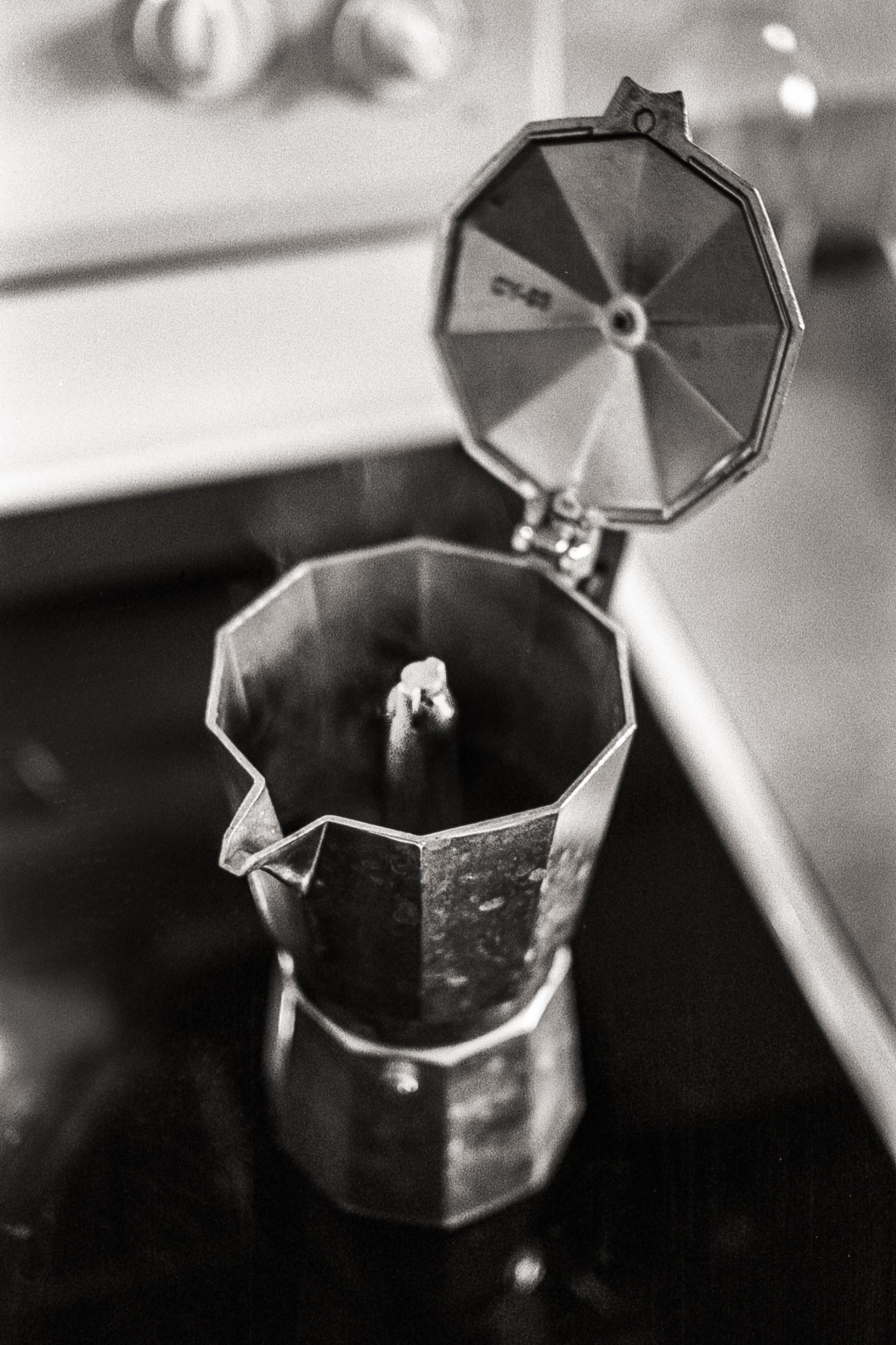

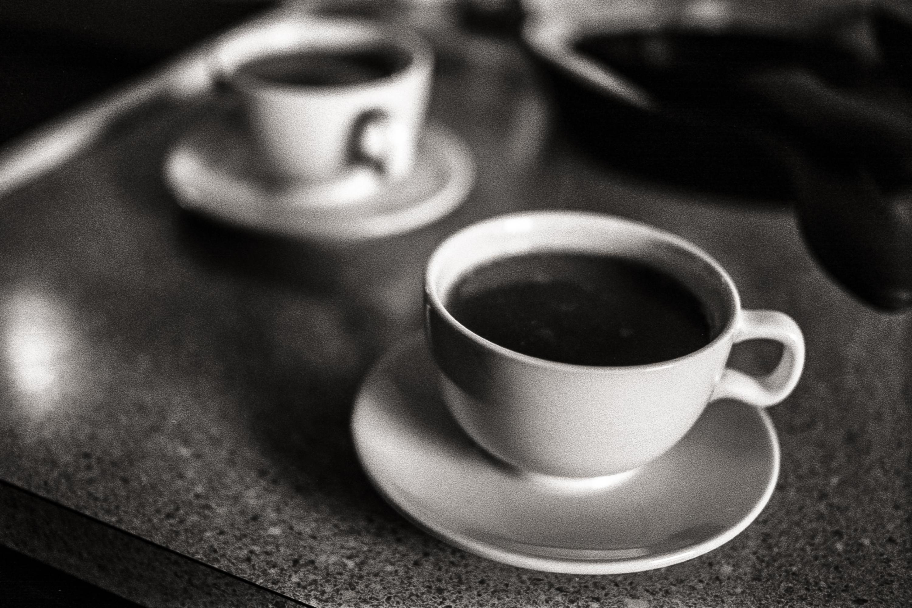

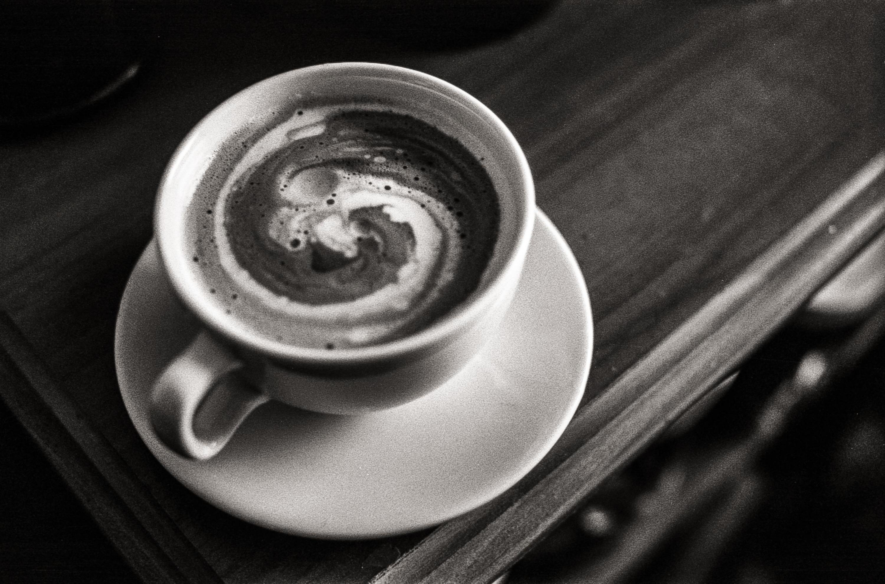

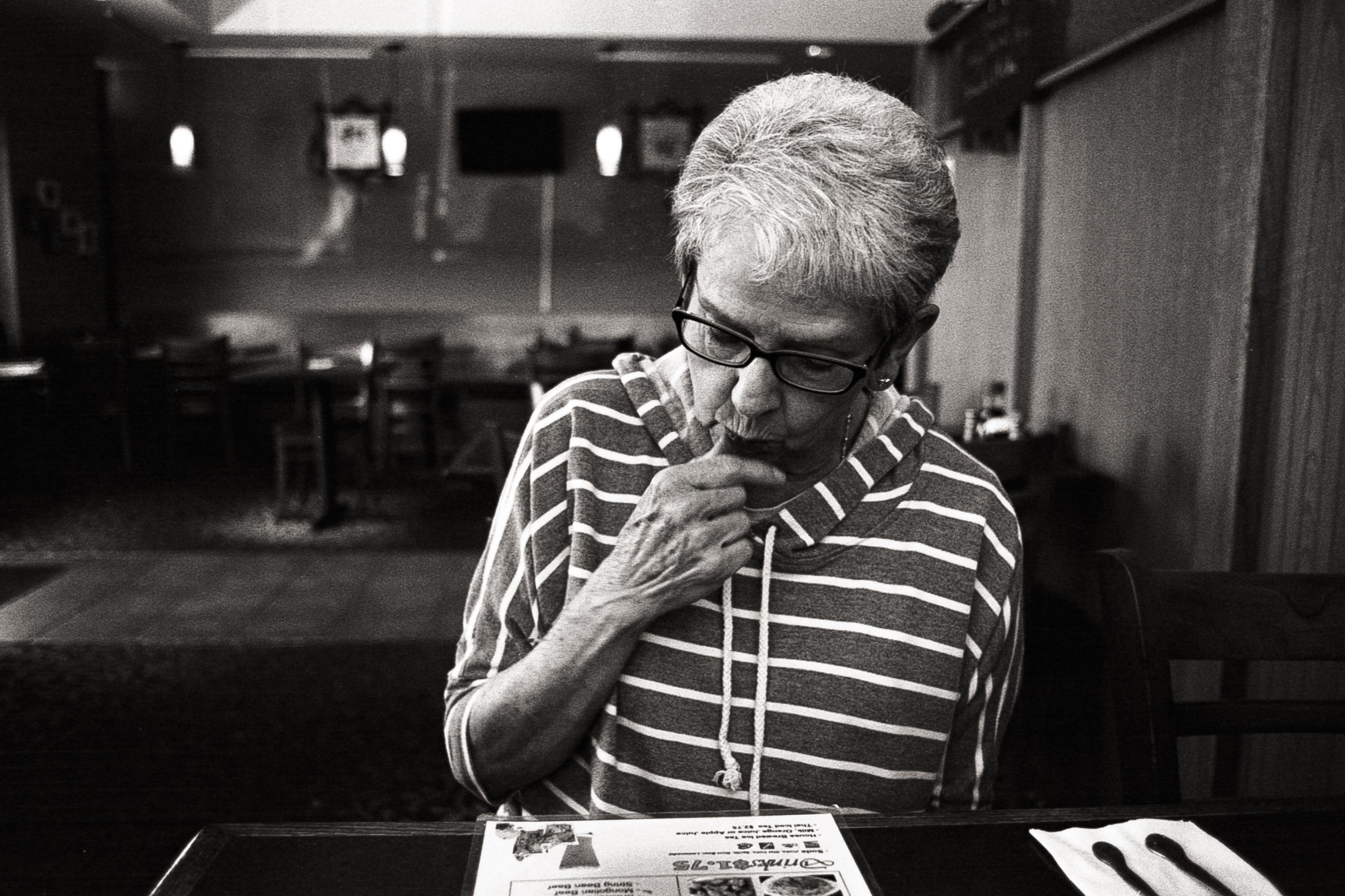

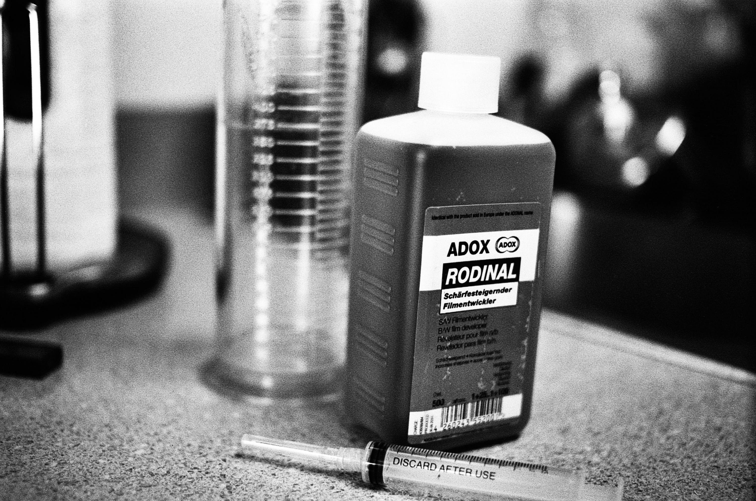

I recently purchased some of the so-called private label XP2 from Ultrafine. There's finger prints, scratches, and dust on the emulsion side. Rather than spend the money on developing in C-41, I thought I'd give semi-stand developing it in Rodinal a try. The results are far from perfect, but I like them well enough. Negatives shot at 2/3 to 1 stop over came out much better than those shot normally. Current roll in the camera is rated at 200 instead of 400.
I hadn't developed anything in years, using DD-X and T-grained films (except for some Neopan 1600) the last time I shot in 2007-2009. Any thoughts on my process below? My next few rolls will be Arista EDU 100 shot at 50. This was all for 1 roll in a Jobo 1520 tank. Any thoughts on using more developer if I am putting two rolls in the tank?

I love this look!!!
What is it about color film (and apparently C-41 B&W) that look so cool in standard chemicals?!!? I love the very dense and right grain pattern, but it seems as if the grain is still very small....which is why I like it. Tonality on these is nice as well.
is there an orange mask on these? I've never tried using the C41 B&W film before, only color in DDX and HC110, which of course DO have the dark mask.

I should mention these were shot with a Nikon F3. All were shot with a Voigtländer 40mm Ultron ƒ/2, except for shot of my grandma which used a Tamron 28mm ƒ/2.5 Adaptall.

You've inspired me to go pick up the cheapest 120 color neg film I can get my hands on and make a (more) serious study of mis-processed color film! I really like the tones and structure in the two coffee shots especially. Very cool and keep 'em coming!
