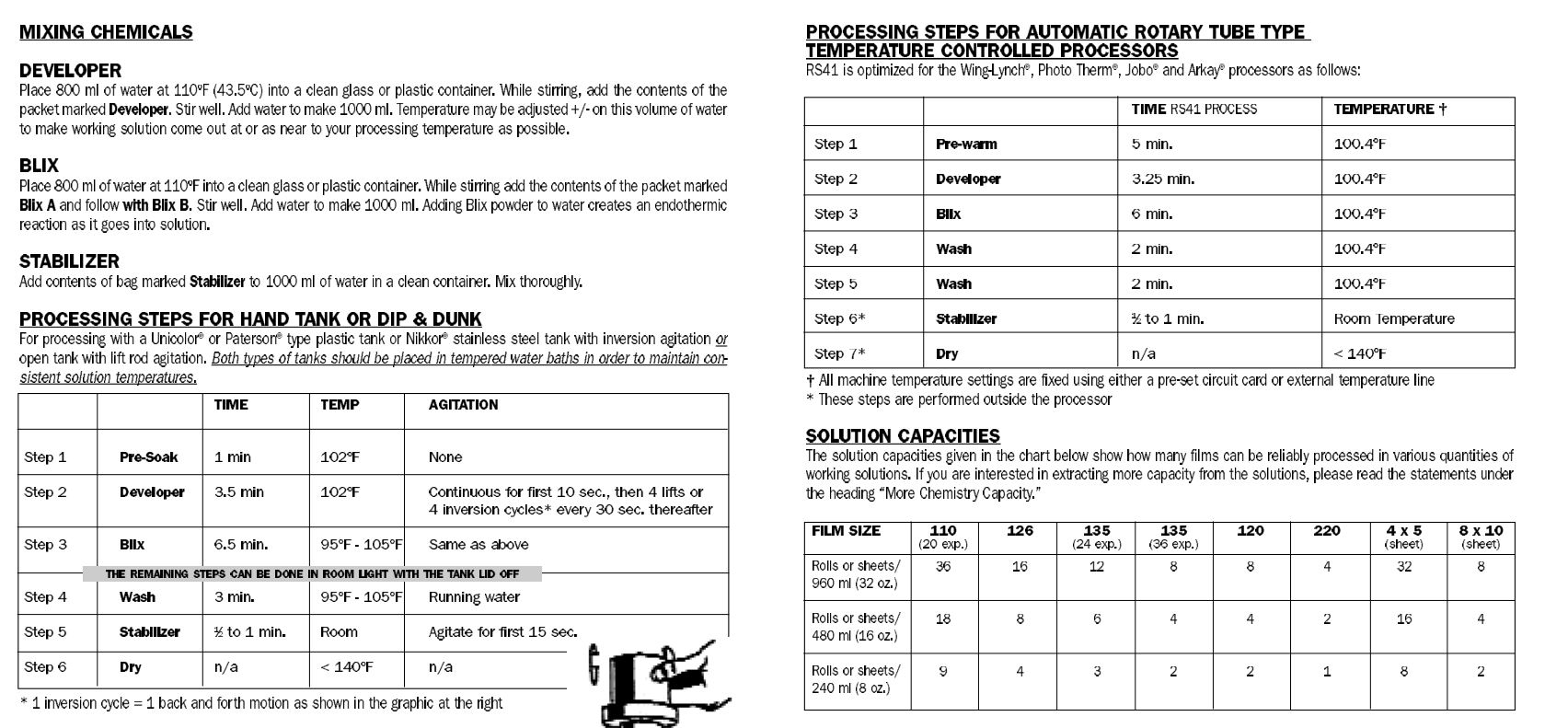

Just did c41 today Unicolor powder kit

I have not done c41 process in about 25 years. I never did a lot back then either. Much easier to let the good labs do it, then I could have fun making enlargements.
Developed 2 rolls of 120 color film. First was ektar, second portra.
I used the obnoxiously stupid Rube Goldberg machine made by a company called JOBO...lol. God only knows why they are so obscenely expensive......STILL!! I have to say, that their film reels are terrible!!! They do not ratchet when you wind them, and there was NO way I could get 2 rolls on there. You know that little red plastic stop thingy that separates the rolls so you can spool 2 on a single roll? I lifted the red tab, but I could not get the first roll loaded all the way in. I could not even get a developed roll in there with the lights on. Gave up and processes separately. My temperatures and times where dead on. I followed the unicolor instructions for jobo, and they where way overdeveloped...a strong magenta cast to the negative....even at borders was indication.
Then I did it the old way i used to. A paterson tank..cheap, and it loads negatives like a charm! All chems in a water bath. Tank in water bath. Processed according to unicolor directions for a tank, and PRESTO...perfect!!!!
I tried black and white on that jobo and the constant rotation overdevelops even though times are cut down. There has to be a formula, but then again..that machine is not fun to use.....Made like crap...plastic pieces not seating right...magnets falling out.....ugh.

C41 colour developing process first bath, is 3’15” nothing more nothing less.
I would suggest you use a 2% stop bath after your colour developer to stop everything at or as near as possible to 3’15”. This is something I started doing with C41 process about 30 years ago.
C41 process does not have a Blix, it uses a bleach bath, then a fixing bath. I am aware of Blix baths, but they do deliver a slight difference which I know from using Kodak control strips, process C41. Blix shouldn’t really be an issue, but it is a variable away from the standard C41 process.
The magenta mask you are referring to, may in fact just be the orange mask that is in the case of the films you have processed, along with the chemistry you have used, and, how far away from the standard C41 process you have processed, and possibly given you a more magenta looking mask to your eyes.
There are a squillion variables with C41 process and in most cases you can bend, stretch and manipulate the process and still end up with printable negatives with correct colour, after colour head corrections are done.
I have processed C41 in Dip ‘N’ Dunk machines that were processing 135 format up to 8x10” sheet film all day and evening. I have done C41 in roller transport machines that could also handle up to 8x10 sheet film, and I have done C41 in rotary processing, in a Jobo machine, with my own CPE2 units (I have two now).
Running Kodak control strips, process C41, through all of the different machines, we found the Jobo with rotary processing and one shot C41 developing, produced the best actual development of the control strips, as adjudicated by using the Kodak supplied densitometer at my work.
I would suggest you may wish to spend a bit more time learning how to use your Jobo more accurately, as for magnets falling off, something isn’t correct there. It also tells me you don’t have a lift on your Jobo. The lift on the Jobo makes it really easy to be within one second of correct developing time, which is about as good as it gets. Using a magnet held drum is not as easy, nor in my opinion as accurate, as using a Jobo with a lift.
The C41 process is about the shortest standard developing time I know of, this means you really have to be on the ball with regard to the processing time of your first bath. 3’45” is a one stop push, although to ascertain if you do in fact get a 1 stop push with that time, you need to monitor your push process, it may be plus minus about 5 seconds either way past experience has shown to me. For what it's worth, a 2 stop push is 4'15". You may wish to avail yourself of this possibility if you process your own C41.
With regard to your film loading, which model of reels are you using?
