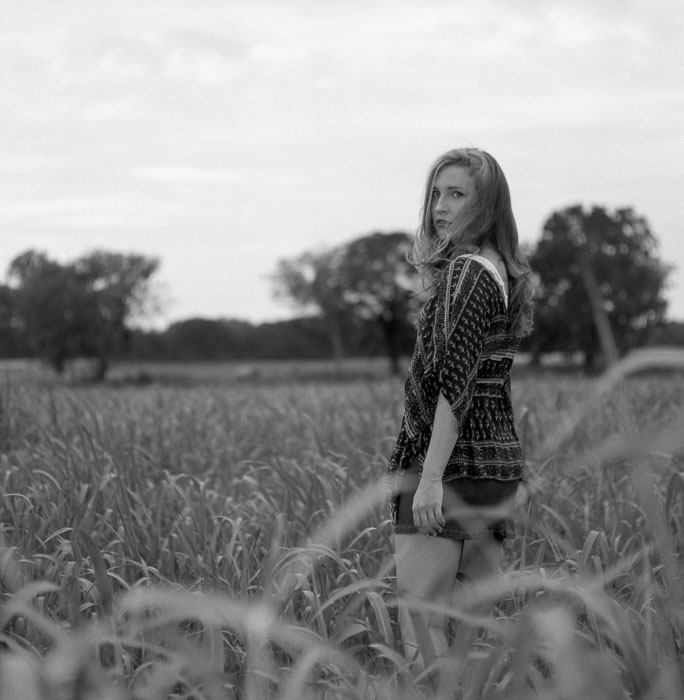

First time trying to shoot with fill flash on film and at greater distances I liked the results

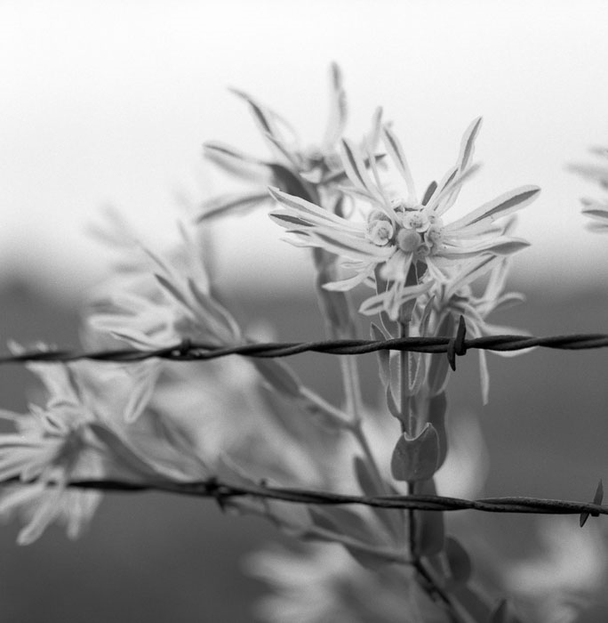

In Texas we may not have mountains, but we definitely have barbed wire

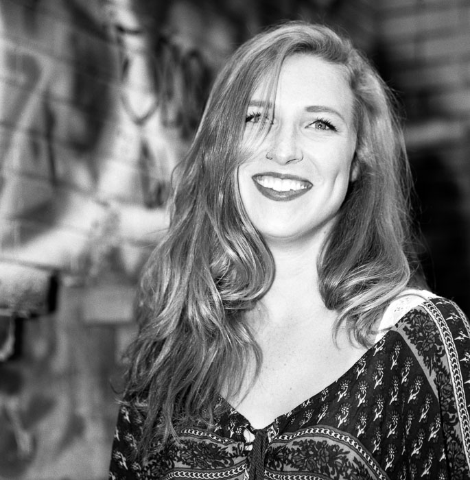

Now, photos I was less than happy with. At close distances, the fill flash was too much. I was using my SB-15 on auto and the indicated aperture was f/4, so I set my camera to f/5.6. This worked well at longer distances but I should have set my aperture to f/8 at this closer distance so the photo doesn't scream "HE USED FLASH!"

Any advice on how to improve my use of fill flash? I might post the same question in the lighting forum for more help.
I didn't use any filters for the shots which I think would have helped. There was a lot of texture in the sky with the clouds that evening but without a filter it was all lost in the negative. But, the step-up rings I ordered haven't come in yet, so everything is going to be un-filtered for now.
Tips for improvement are welcome!

Your fill flash problem may have more to do with the layout of your subject than anything else.
The auto sensor on your flash might not be well suited to this sort of use. If the sensor is overly influenced by light bouncing back from the background, than a scene where your main subject is off centre may end up with too much light on that subject.
Also, be sure that the camera isn't blocking part of the field of the flash sensor.
In either case, the solution may end up being manual flash and guide number calculations.

Congrats Sam, you're entering the mid-format photography with a "pro" grade camera, very smartly chosen!
I like the first protrait you posted, the image cut is superb. The light in the background complementing the subject over the diagonal is lovely.
The picture of the barbed wire is also brilliant.
