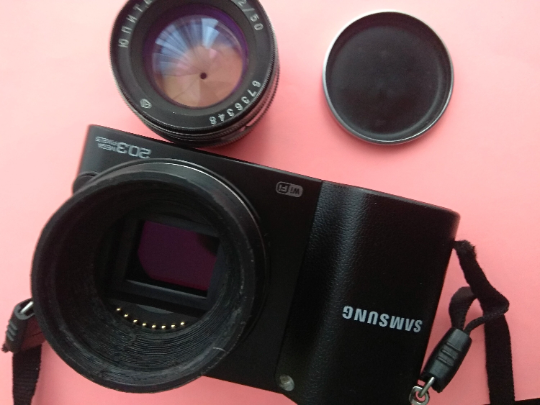

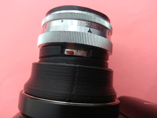

I had such an adapter Jupiter8 (Kyiv-Contax) / Samsung NX printed on a 3D printer. In theory, you can print any adapter, but a lot depends on which camera
