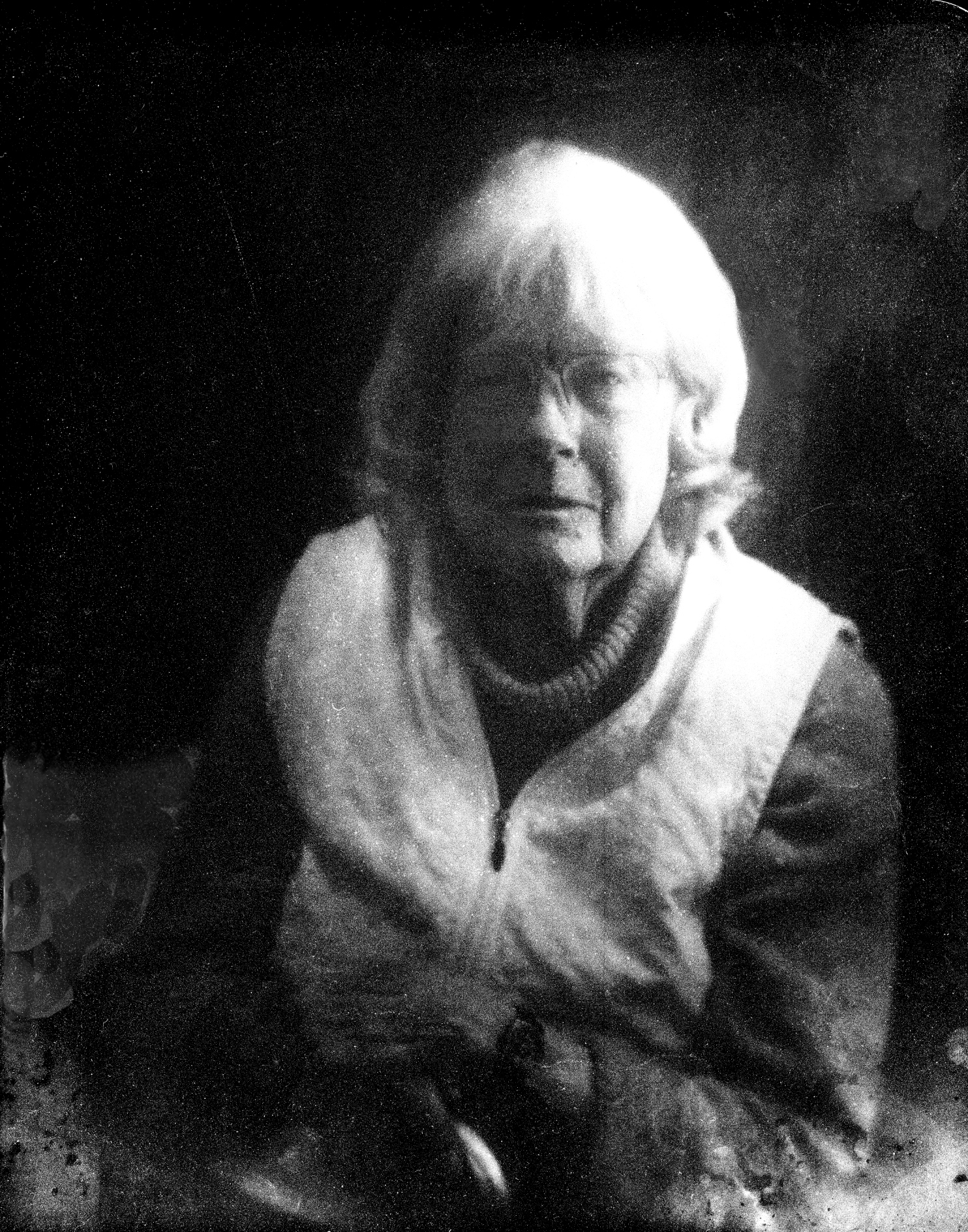

An experiment to develop X-ray film using Dektol as an aggressive film developer~
the Film…Fujimedical green x-ray.
the Lighting… A diffused LED “shop light” off the left shoulder, ambient room light elsewhere.
the Lens & Camera…A 250mm f 2.3 Wollaston meniscus, on a 4x5 Tachihara.
the Metering… Incident light, ISO 320, f:11, @1/25 sec.
the Developer…A Dektol/glycin blend, @1+10 dilution, @ 3min, 65º,= extremely dense negative.
the Reducer… Kodak T-14a formula reduced the negative to totally ”clear” in 10 sec, (oops!).
…after rinsing the almost invisible negative I decided to continue on…
the Scanner…Epson V700…the Software: Affinity Photo 1.8.4… I adjusted levels & contrast….
The strong grain pattern on the “soft focus” meniscus lens image is quite intriguing…
An ink-jet 8x10 test print shows promise despite my sloppy handling.
I’ll handle it more carefully next time…

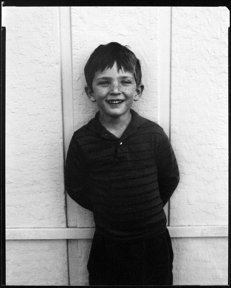

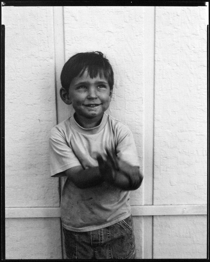

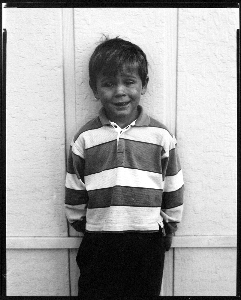

The images below were taken with x-ray film and processed at the hospital (the techs loved it!) Taken in open shade at ASA800 (I took one at ASA400, but it was a little thin. ASA 800 was a good exposure. Using the same film under the redwoods, the ASA dropped down closer to 100 (but developed by me). I believe it to be the same film you are using. The color of the light source seems to be a big deal with x-ray film!
[Edit -- I got it backwards...I did used the ASA 800 negs for printing -- the ones at ASA400 were too dense (but still printable). Thanks Don!]
Bryce, Calder, Alex
8x10 platinum/palladium prints
PS - I had no idea Calder had such freckles until this image. Calder's shirt and pants, and Bryce's pants were red -- thus almost clear in the negative.
