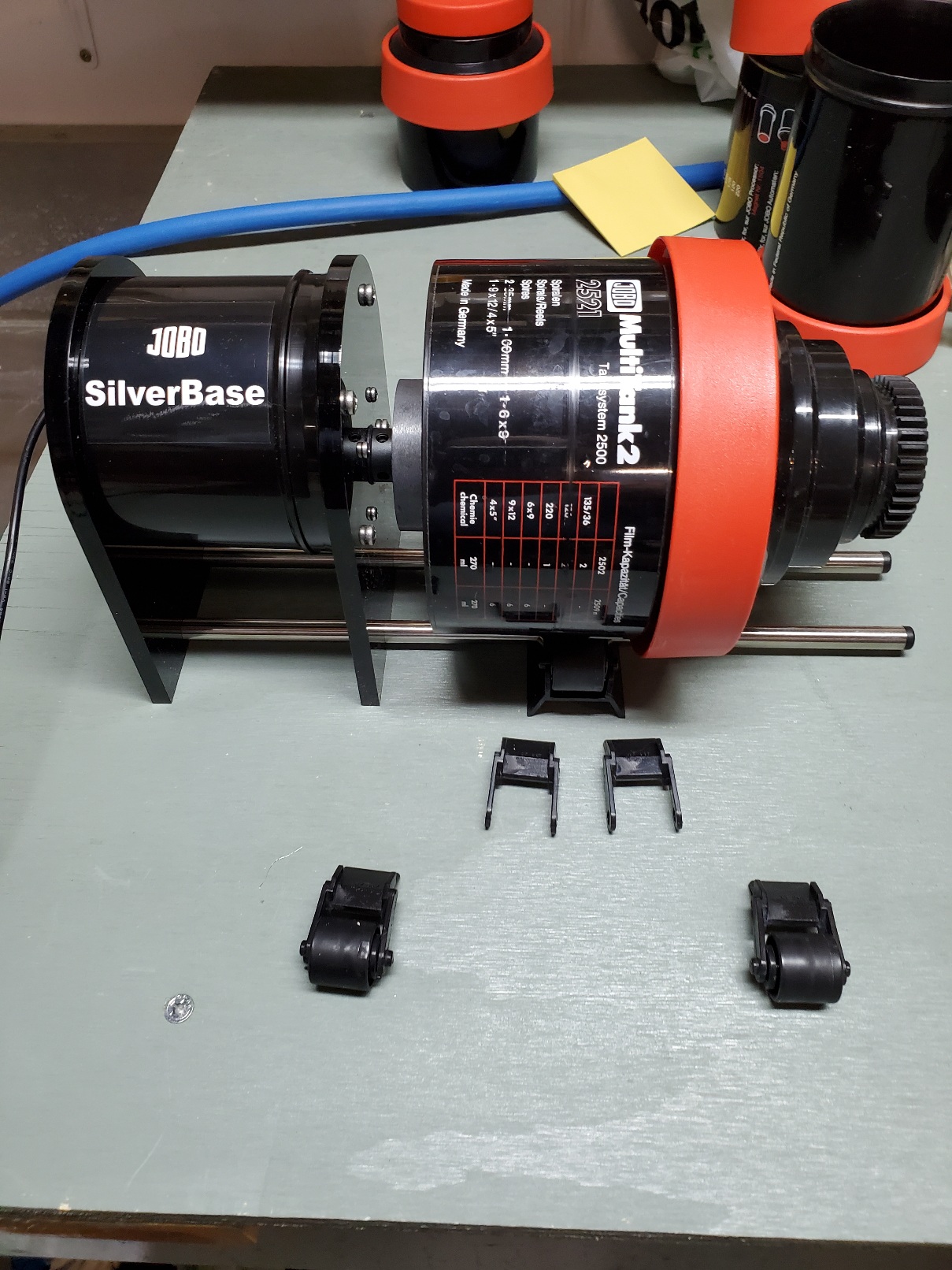

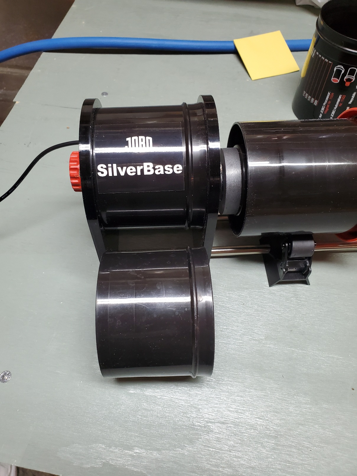

I received my new Jobo Silverbase today from Catlabs. I've yet to use, but overall first impression is it's built to Jobo quality standards. Made in Germany, by Jobo. The motor is very very impressive sounding, the main body outer shell appears to be a upcycled 1510 tank shell! That's impressive as creating an all new injection molding tool would have been crazy expensive. I bought the unit with a new 1520 tank, with the magnet (installed). Unit works with most 1500 series (1510, 1520, 1540 ) combos, limited to 2520 for 2500 series.
Tank reverses about every 8 seconds, perfect for black and white. Motor reverses a bit more gradually than my other Jobo machines, this is, I suspect, to maintain torque effects to keep it still.
Price is (right at) 400 Euro, 400 USD. Not bad for something that on first glance will last a long-time.
Best Regards Mike

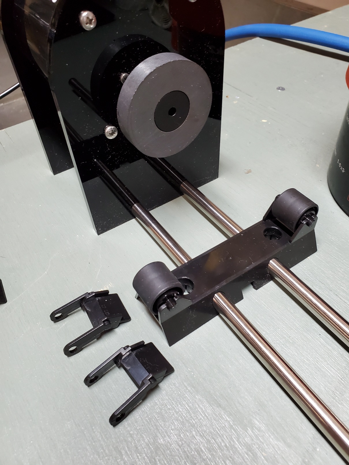

You can see the clever use of existing parts

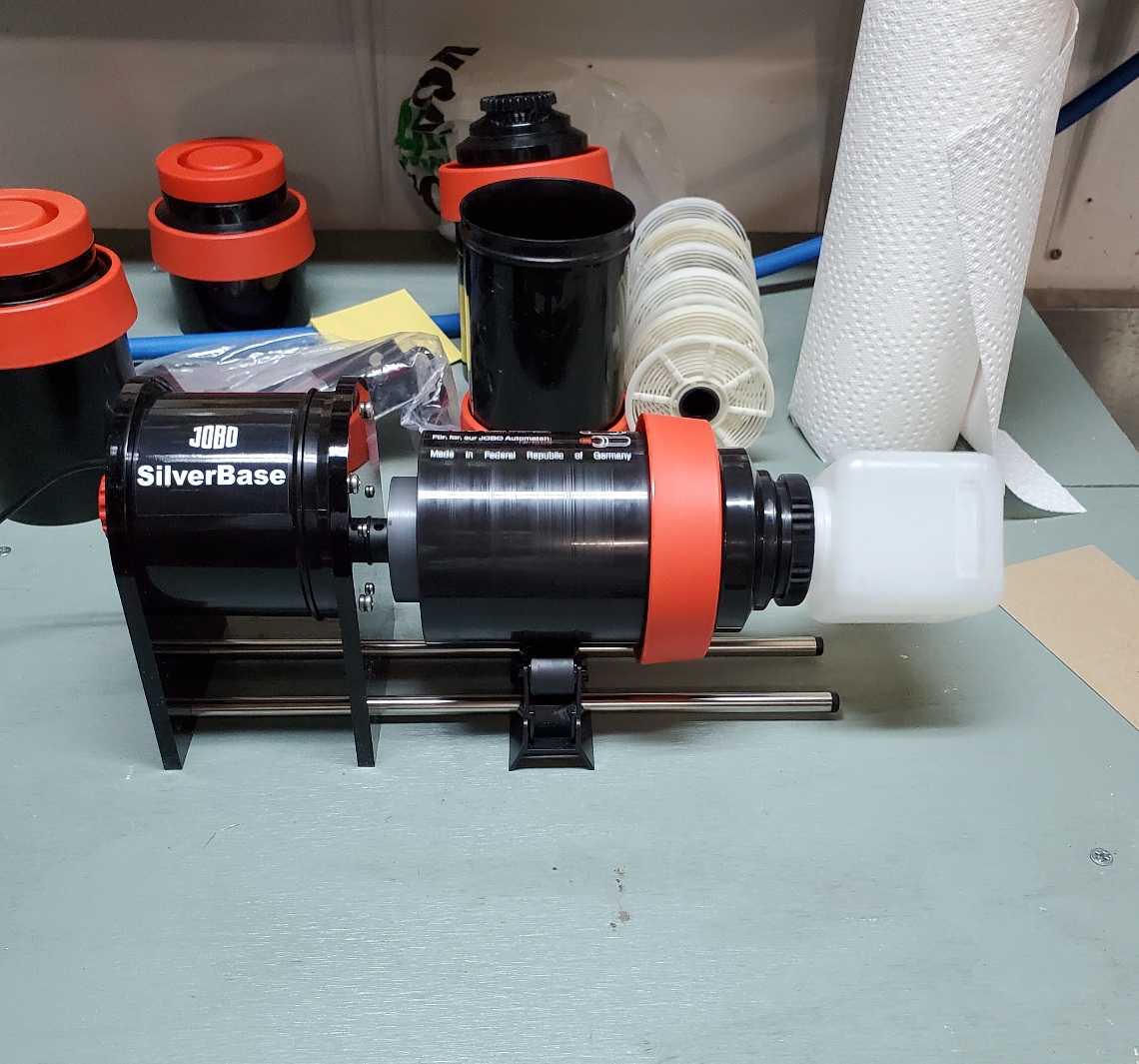

This thing is a blast. I'm using the Colorbase/Duolab cog to attach the small bottle (more fun)
Awesome. Awaiting mine from CatLabs, as well. Will use it with the 1520 included in the kits and a 2520, but it's not entirely clear to me whether I need another set of rollers for the 2520 tank.
Instructions don't really cover this. To use 2500 series tanks you need to (carefully) pry the roller from the roller clip. Then you fit the roller itself to the processor carriage. Same as any Jobo. I have a couple of the early white rollers that I keep ready.
You might want to check with Catlabs to see if they have a couple extra rollers.

Could you elaborate on the lid/bottle setup? I'd never seen a setup like that and I'm curious as to why/how/what having the bottle attached would do? Thanks!
Ha, that's the infamous Jobo "Duolab" and "Colorbase" cog with threads that accept all Jobo bottles (270mL, 600mL etc) it's a gimmick. The Duolab could accommodate 6 x 270mL bottles, the idea is it would minimize temperature changes. I got started in Jobo around 10 years ago when I bought a Duolab, and a dozen tanks for 100 bucks.
