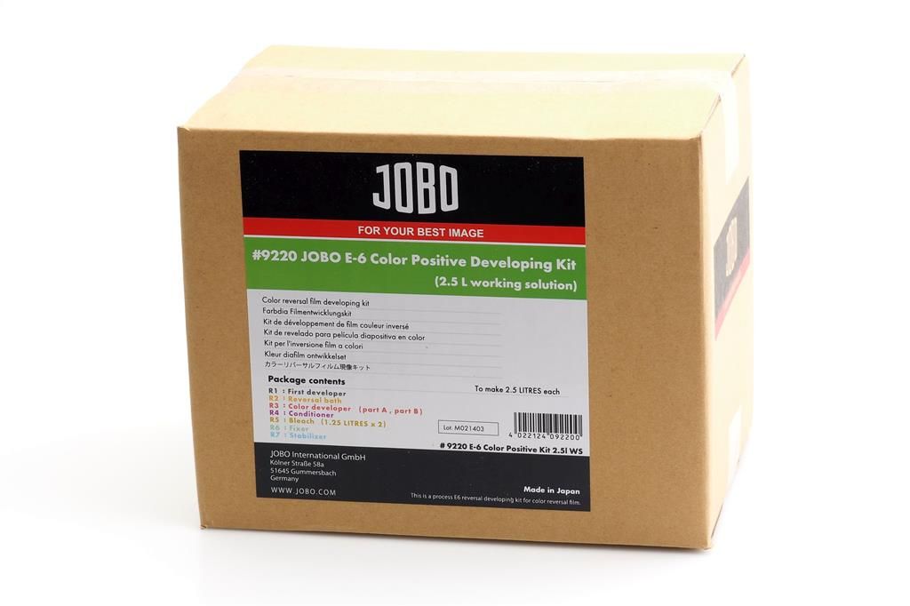

2110000851439_28536_1_jobo_e-6_color_positive_developing_kit_25l_9220_filmentw_61d35577.jpg
Genuine Made in Japan, fascinating
Yes, or at least the closest thing. Finally, I've decided to get it and I'll tell you my impressions after using it.
I think it is just ilford e6(made in Japan)
Exactly same package manual and bottles
That doesn't sound very plausible. If it were Ilford, it would actually be labeled Harman and made in the UK. Ilford as such doesn't manufacture anything, so if it were Ilford, it would have to be manufactured by someone else. Whatever's left of the Ilford company operates in Europe, so if they were to sell E6 chemistry (which doesn't fit their business portfolio at all), the likely supplier would be Fuji Hunt..in Belgium.
So Ilford manufactured E6 chemistry, made in Japan? That sounds really odd for several reasons.
Ilford do chemistry for color processes? This is new to me. I don't see anything similar on their site, but maybe the Ilford brand exists in other regions?
Actually ilford have sold their color business to Japanese company.Nowaday if you heard any of ilford color news, the product would come from Japan but not Europe
And in fact, according to the level of ilford's past color technology(cibachrome,color crystal enlarger paper, etc.)
this is possible:smile:
I think it would be very good if it was manufactured by Fuji hunt
But I guess they just repackages the machine-use chem used by ilford's processing labs in various countries and sells them as tank-use one
