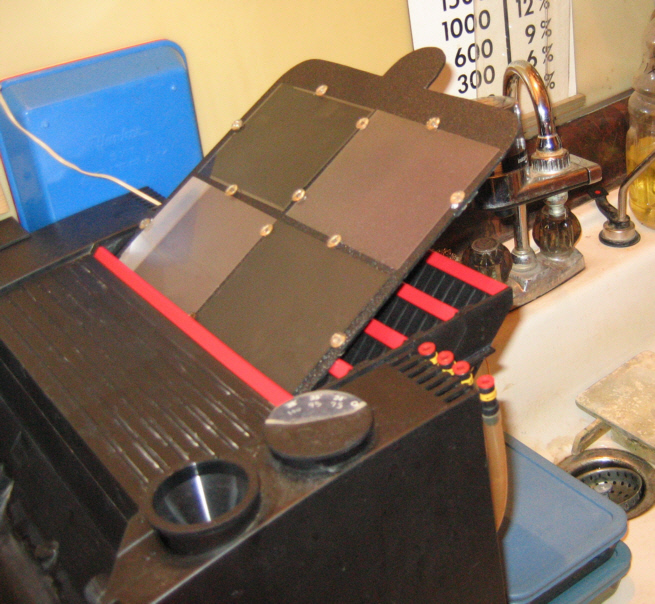

Dear Joe7;
I have a DuoLab and use the slots for processing sheet film. I made a film carrier that allows me to process four 4X5 sheets at a time or 2 5X7 sheets Or 1 8X10 sheet and the negatives have been the most consistent negatives I've ever made. Over the years I've used tray, rotary, BTZS tubes and unicolor paper drums but the DuoLab is cleaner, faster and temperature controlled for color film and I use the drum area for tempering color chemistry when I use my Unicolor film drum with roll film. I still prefer to do all BW roll film in tanks. I also use the slots for 8X10 color prints and for BW paper testing but I prefer to develop BW prints in trays. I find the DuoLab to be extremely versatile for the small darkroom.

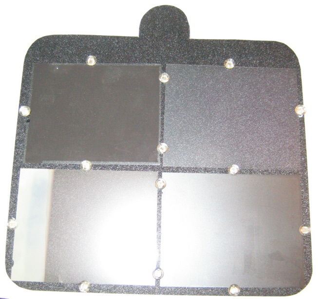

Duo Lab film holder
Babavaga;
Here is what the 4+ 4x5 film holder looks like. I have also one for 2+5x7 and 1+ 8x10. I hope this is useful. I use a textured grain ABS plastic sheet 3/32 thick and clear, pan head, lexan plastic screws.
