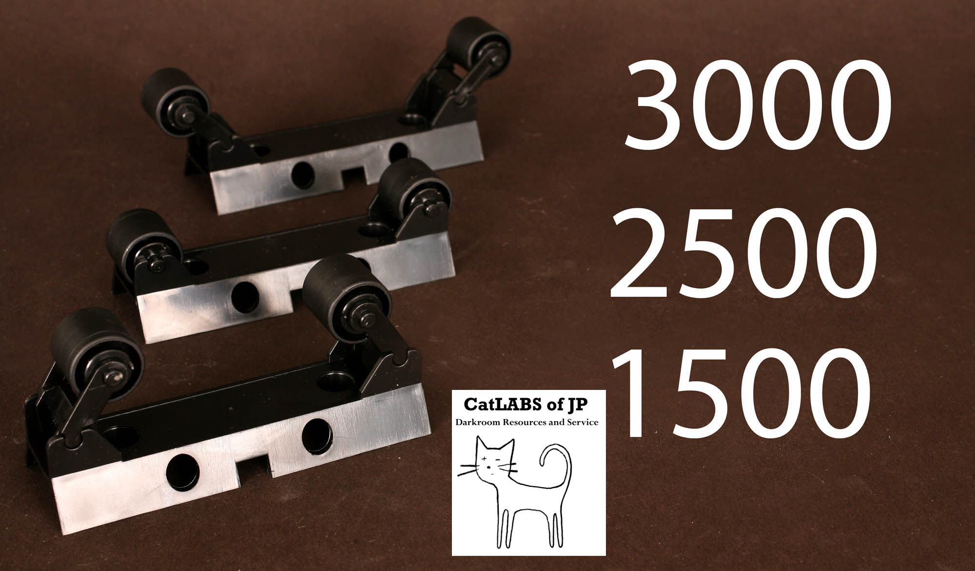

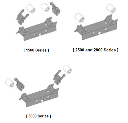

As for rollers, use this diagram:

Roller spacing is for different diameter drums so the stay level
