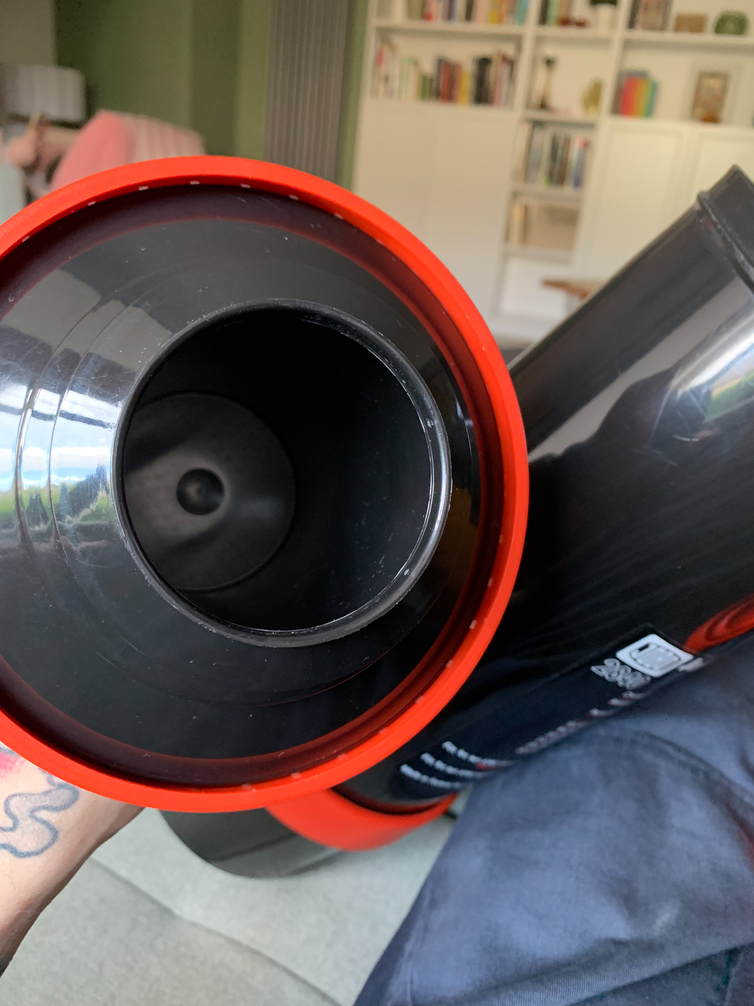

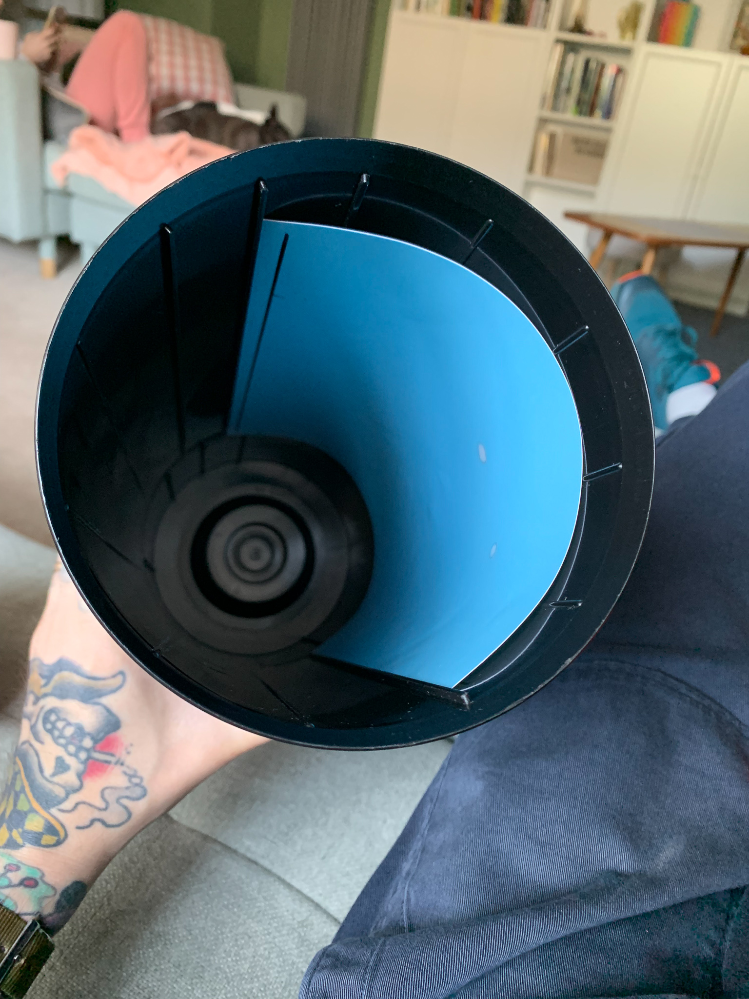

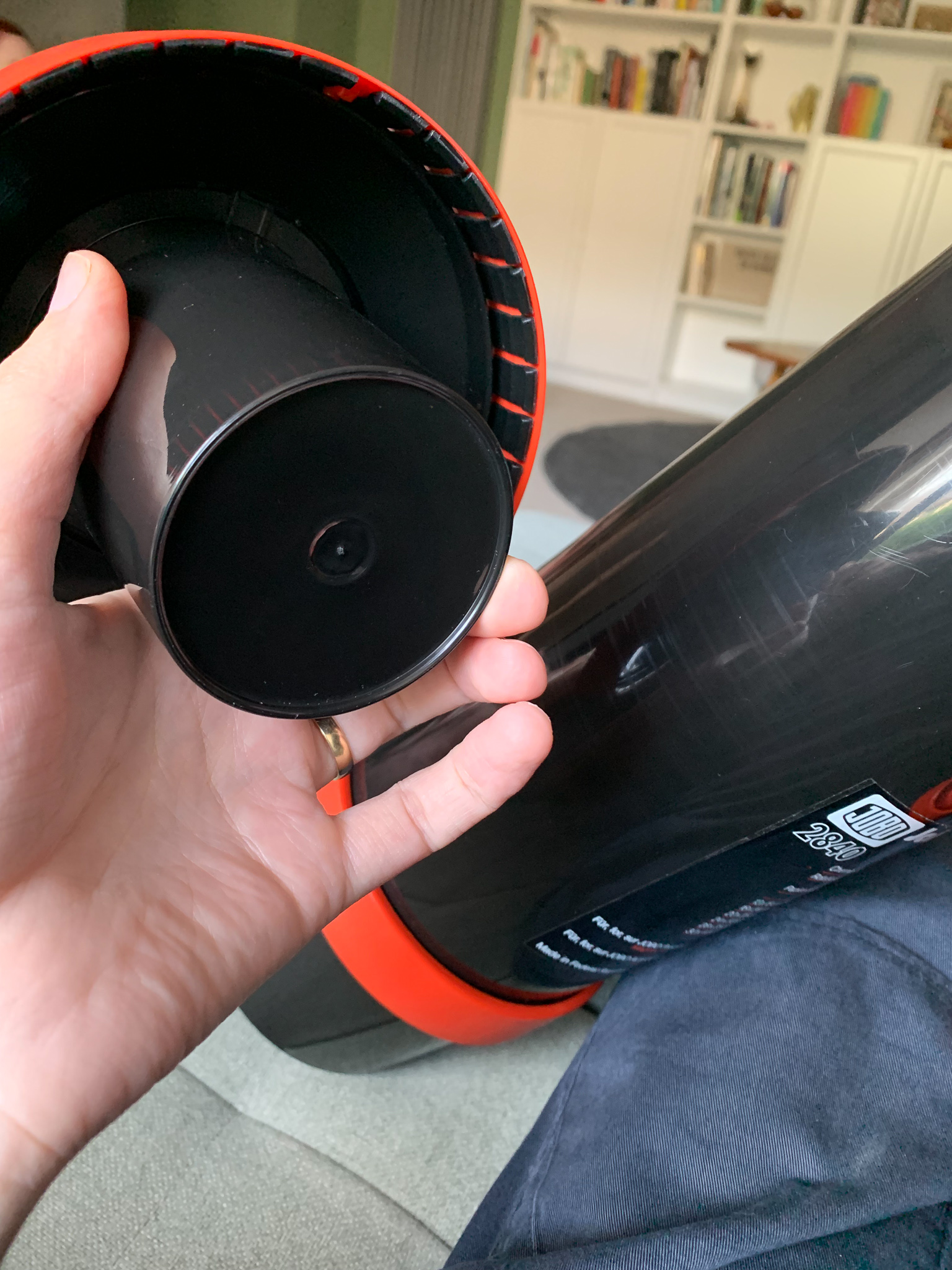

So excuse my lack of knowledge, just looking for some friendly advice. I had one afternoon printing with my nova but didn't have good results as I used badly expired paper. I got some new paper and when I filled the nova up, I forgot to fill the water baths and turned it on, when it started smoking I then added water and I've cracked the heating element, I am a student so I don't really have the money to replace the part right now but someone, somewhere likes me as I was gifted this Jobo processor this week and I've been led to believe it's much easier to print with. Anyway, does anyone here colour print with one of these that can tell me their steps. Do you give a water spin between any chemical processes? Also, once the paper has been put in, in the dark, can you turn the light on when the top is back on the big drum? I've never used one of these so any advice is welcome.
Yes, you can. It's the only advantage compared to trays, IMO. Make sure the top is seated properly and the beaker is attached to it as it's part of the light trap.

Nice set-up there, the large print drum bottom section, is the same drum that does 4x5" film, but without the film drum sticker. This may or may not help you in the future.
