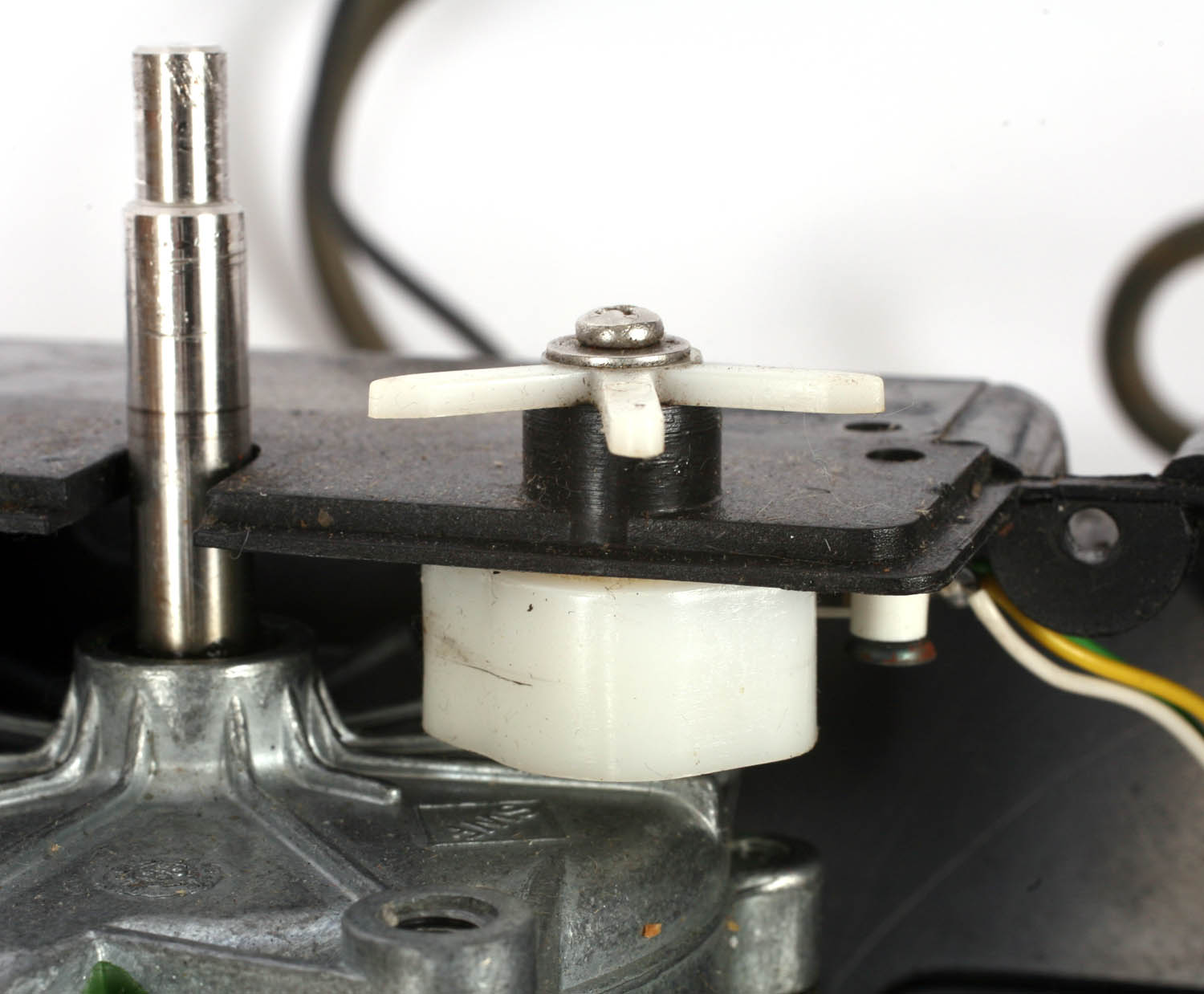

I got hold of a nice CPA2 recently as part of a larger darkroom outfit that I bought locally.
The unit is generally in good working order, but I have a problem with the three fingered white plastic fork that controls the reversal of the spinning direction of the engine. The screw that tightens this fork to the plastic cam on the inside of the unit has worked itself loose. Unfortunately, simply re-tightening the screw is not enough for correct function, it seems that the fork has to be tightened in a certain position in relation to the lobes of the cam which runs on the inside and activates the switch proper. I have been trying to figure out the correct position of the fork by trial and error for two hours now, but I have had little success and this is starting to become a big PITA. It would be great if someone who is more intimate with the unit or has gone through the same procedure before could give me some advice as to how to solve this problem ... A picture or a simple sketch that clearly shows the position of the finger in relation to the lobes of the cam on the inside might be helpful too.

There are only 4 possible options, 1 of which works.
The correct orientation is to have the middle prong aligned with the "bulge" on the cam.

Exactly what I had hoped for ... this is most helpful, thanks a lot!
