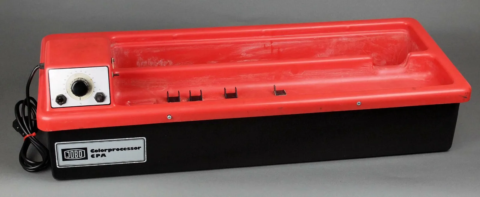

Hello everyone,
I have recently acquired an ancient Jobo CPA (of the first generation) with a bunch of paper drums.
My idea was to switch from processing sheet film in trays to rotary tank processing for a number of reasons.
I bought a Ro-Tank 4322 with it. It came with the following four reels: 2x 2003 (adjustable 35mm to 120 roll film), 2021 (6x9cm sheet film) and 2022 (9x12cm sheet film).
Of course, the 2022 reel's grooves are just a tad bit too narrow to fit my 4x5" sheets. It doesn't seem like the reel is adjustable in any way.
I have a hard time finding information online about which tanks and/or reels are compatible with the CPA and 4x5. Lots of solutions I found stated in forums were quickly refuted by other forum members for only fitting the CPE/CPP/what have you or that reel x doesn't really fit tank y and vice versa, etc.... it's really confusing and the fact that I can't find a scan of an old Jobo catalog of roughly the same age as the CPA doesn't help either.

Welcome - and an excellent first post as well.
Given the older age of your CPA it probably doesn't have the upgraded motor enabling it to easily handle the Expert Drums. You might want to look at the Jobo 2509n reel for the 2500 series tanks. See here:
Thanks! I very much doubt that mine has the motor upgrade.
So a tank like the Jobo 2520 (combined with a 2509n reel) should work for six sheets, right?
I have a new-in-box magnet I could attach to the tank if need be.
I don't suppose so, but would the 2509n reel fit inside my Ro-Tank 4322? That could – of course – save me some money.

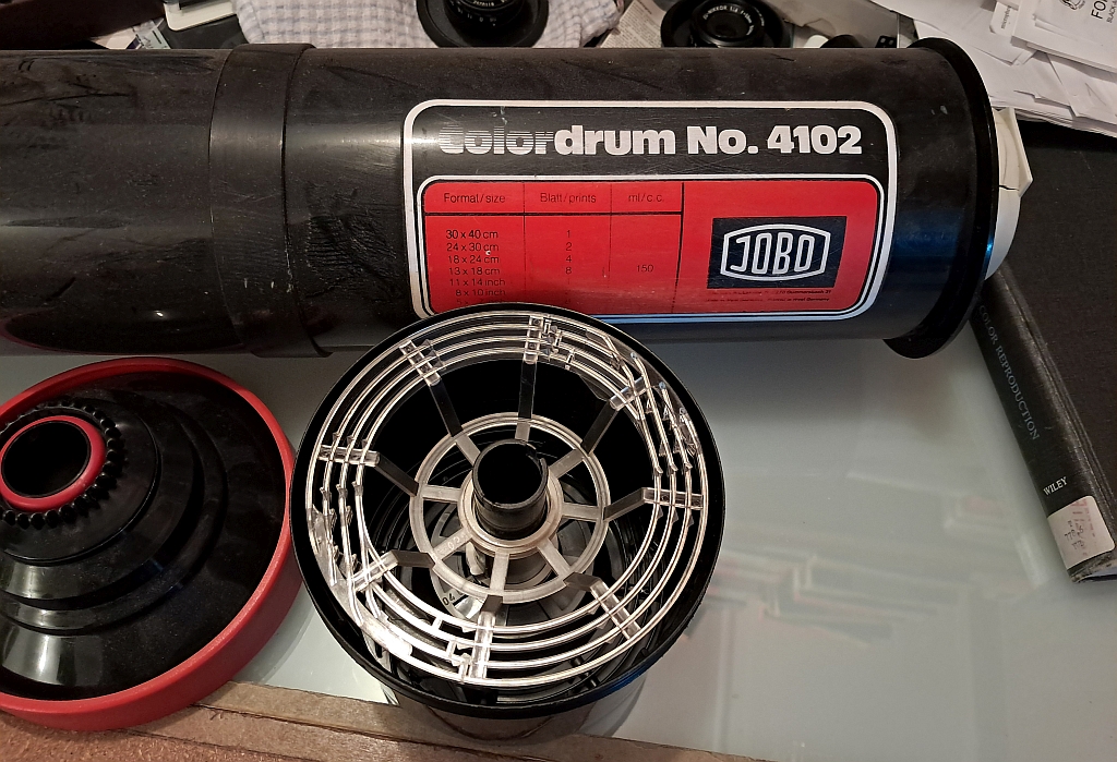

I wondered about the compatibility of the current 2509 reels in the CPA tanks, so I dragged out my remaining CPA print drum, which as far as I understand it, is the same diameter as the film drum(s) for the CPA; but I'm not 100% sure.
The 2509 reel is not small enough to fit inside my 4102 drum, in fact it is slightly bigger than the external diameter of the 4102 drum.
This means that anything related to the 2509 4x5" reel, is probably unable to be adapted or used on your CPA processor.

I have the 4102 drum myself (if I recall correctly; again, I acquired quite a few drums with the processor) and of course there's not much space around it when it's seated in the CPA. If the tanks to accommodate the 2509 (-n) reel would be even bigger, they likely wouldn't fit at all, you're right.
I guess my task is to find a reel that fits both my Ro-Tank (or a similar diameter one) and 4x5" sheets, then. Ugh, that's ugly!
I've done some research and tried finding a reel of the same series, only for larger film by guesstimating the product numbers, but didn't get anywhere thus far.
So, if anyone has any recommendations or pointers, I'd be very much open...

That's the same product family that @Mick Fagan showed you above. It won't fit your narrower drum. Yes, the 2509N reel works very nicely for 4x5", but it's of little use to you, I'm afraid.
