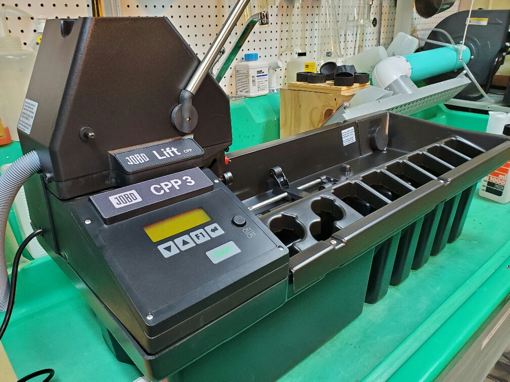

This came today, comes with 6 new bottles :laugh:
