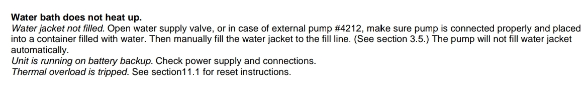

Is the water jacket filled up all the way? Or the water won't heat. Fill until the water is just above the fill line and make sure the unit is level. The sensor could be dead of course.

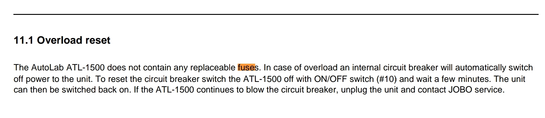

Do you have the manual and the service manual?
Good luck!
Yes the unit is running on 240v and yes it is filling properly and level.
Dave
