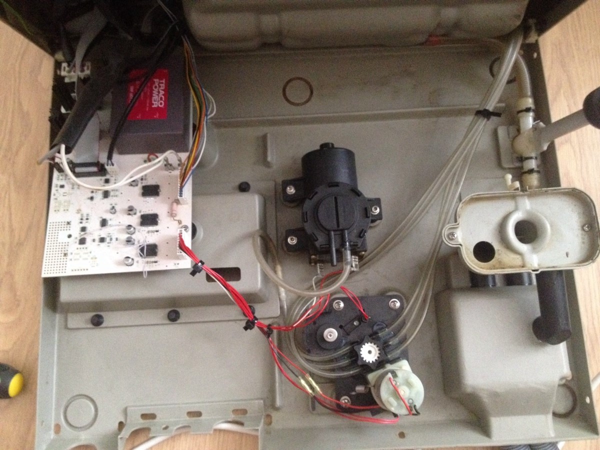

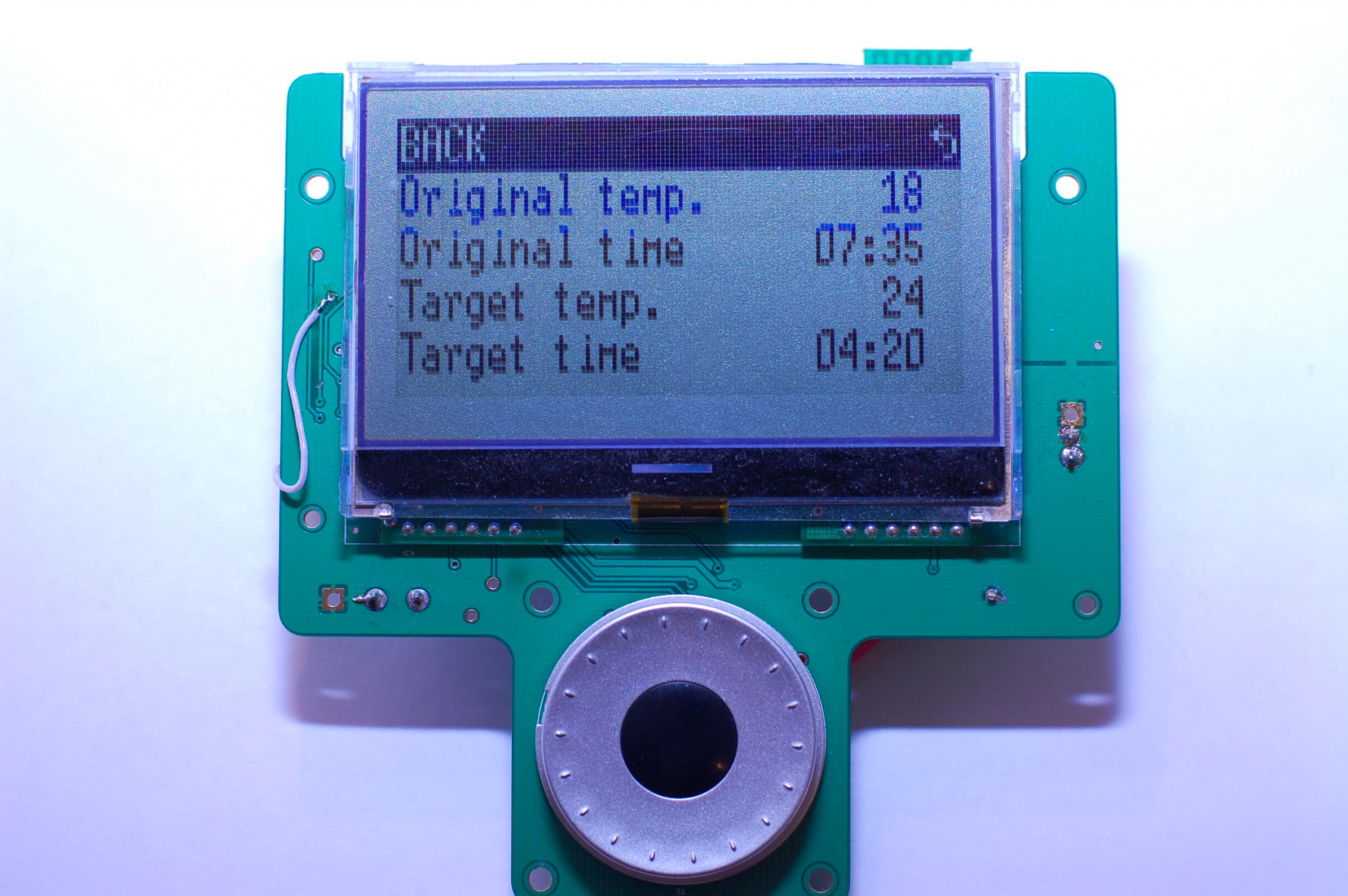

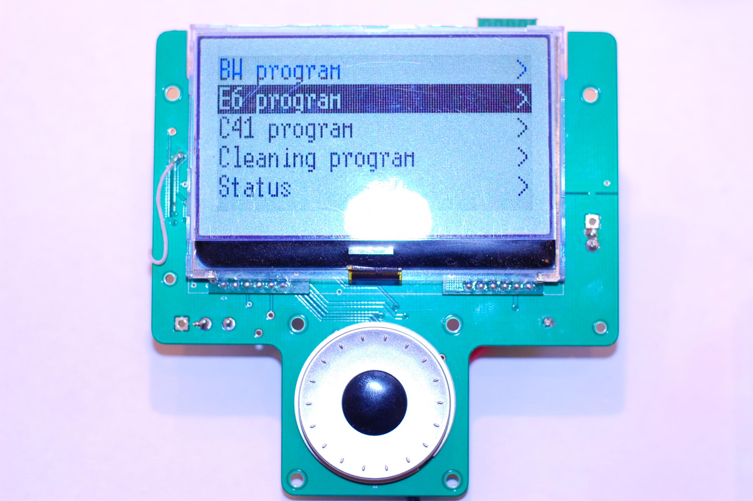

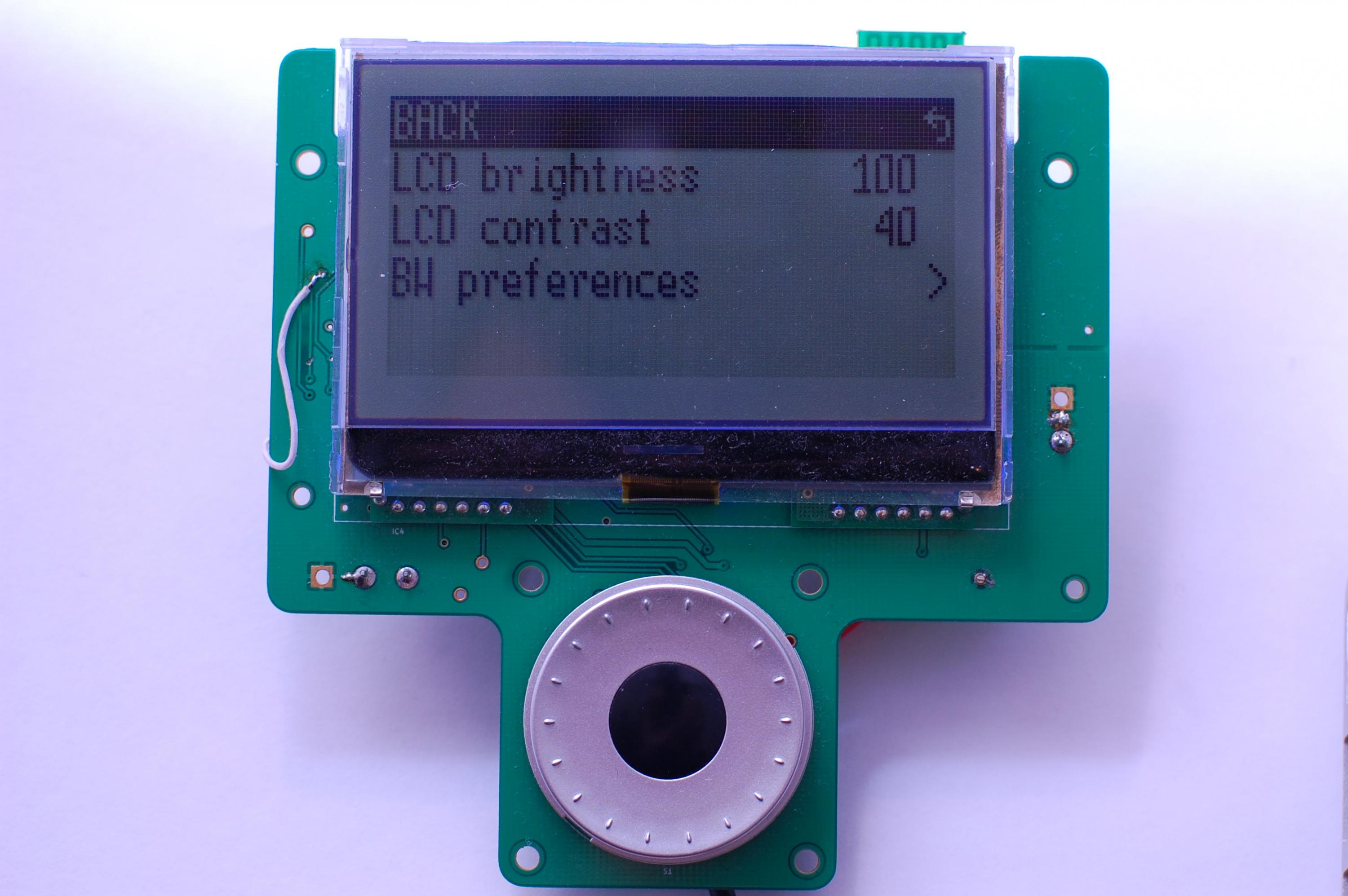

Those are pics of interface board, used phone to take them
That's main controlling PCB in place
sorry for the photo quality.
