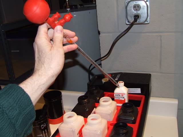

When I use very dilute Rodinal I divide the volume up into multiple bottles and then run the bottles through the Jobo one at a time.
The Jobo tempering box is nice in that it keeps all the bottles up the temperature until they are ready to be used.
What do you mean "one at a time"? To process one roll of film, you change the developer several times?

Dale,
Am I seeing that outlet correctly? You do want a GFI that close to water ....
Very clever observation. When I got my Jobo units, the manual indicated that they should not be put in a darkroom sink, so I made 'dry' countertops on which they are placed. So that 20A electrical outlet is actually on a countertop; following electrical code as in a kitchen. That particular JOBO unit (TB-12) is light enough, even when filled with water, to just carry to the sink to fill and empty. The bigger JOBO is filled and emptied using hoses that run to the sink.

Yes, REDSUN, the total developing time (say 15 min) is divided up into 5 or 6 steps of filling and emptying, each with a new developer bottle. I use a computer spreadsheet to figure out the start-stop times for each bottle and to calculate how many bottles are needed.
