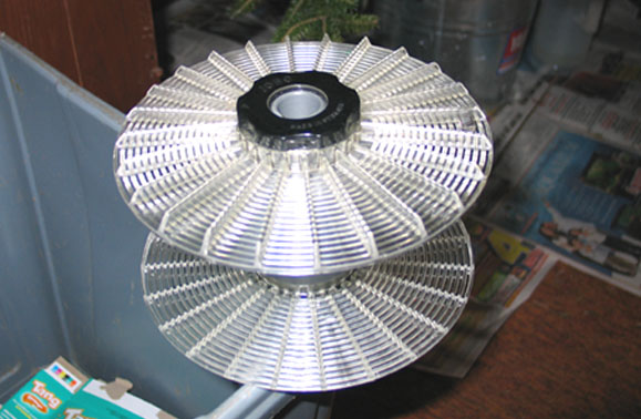

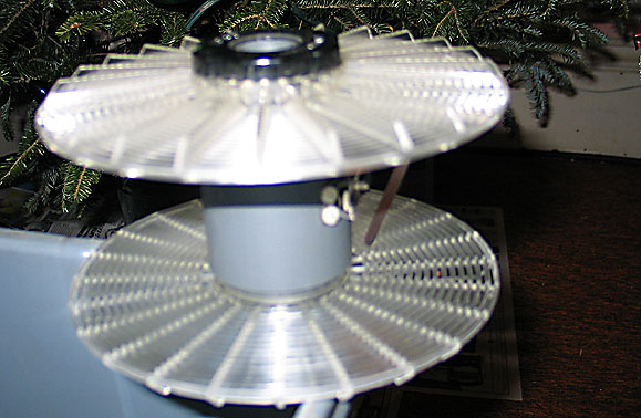

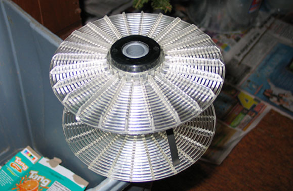

I just picked up a Jobo 70 mm processing reel, the one that takes 15 feet of film. The tank that it came in doesn't appear to be made for processing film in. What Jobo tank does this reel fit.? I have a CPE 2+ processor.

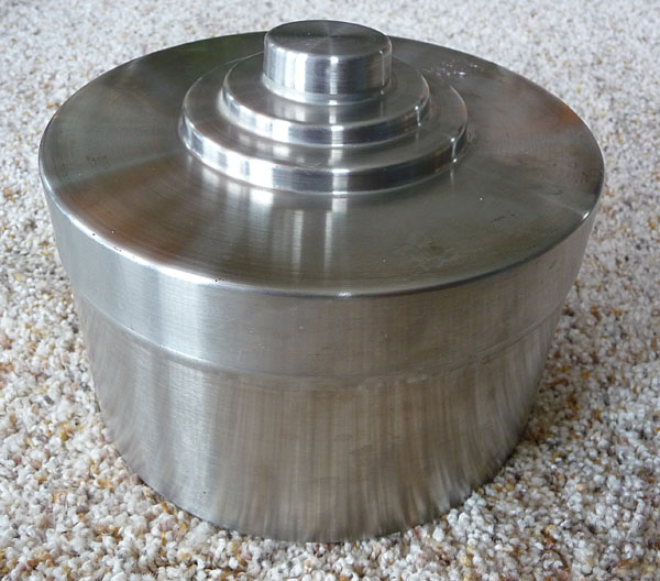

Here's the Nikor tank you need. Outside diameter 6.75 inches.View attachment 100302
This isn't even remotely what the OP is asking about, this is a hand inversion tank that will not fit into the Jobo processor, this requires 2L of chemistry, it's a great tank as I own it, but not what the OP is asking about.
Here are pics of the 70 mm reel I bought.
Doug
The O.D. of the reel is 6 1/4 inches.
Doug:smile:

I think you'll find some useful part numbers and pictures and info here:
Duncan
Thanks Duncan for this info. For me there is just one problem. The CPE 2+ can't handle these tanks. So I will have to do the old manual rol back and forth on a tabletop. Does anybody know if the 70 mm tank is available anywhere.
Doug:smile:
Doug:smile:
Just run out there and buy the new Jobo CPP-3 for a mere $3299.99US. Not only will you stimulate the economy, but also you will help Jobo amortize the development and start up production costs. You will be such a great guy and everyone in APUGland Jobo will appreciate you. Jes' sayin' :munch:
They do show up, that reel only fits in the 3000 series tank it was designed for, it doesn't fit in the normal tanks.
It will cost you about $350-$400 for a tank, reel, and reel loader which is really the only way to load it without skipping.
