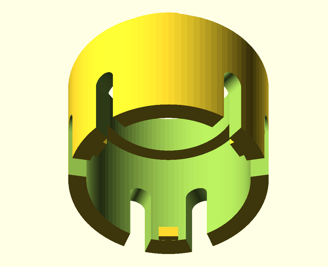

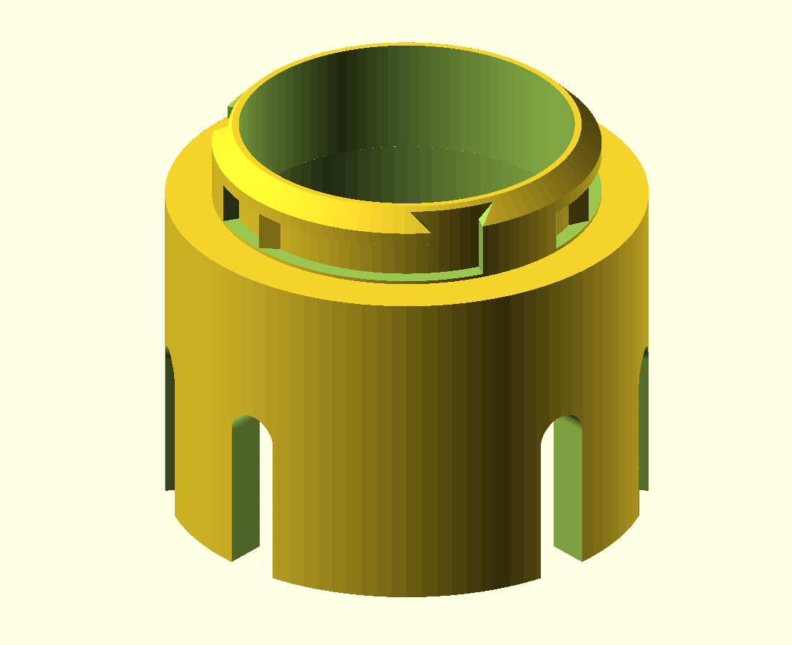

I've been saying for ages that I'll make up an adapter to more-easily allow development of 70mm in 2502 spirals. I finally pulled my finger out this afternoon and made up a design in OpenSCAD, see the attached renders. The idea is that the adapter goes between the two halves of the spiral, causing it to be 9mm wider than on the 120/220 setting.
The Adelaide City Library has 3D printers (a couple Makerbots) that are free to use, so I hope to get a prototype made up this week.
Edit: I just noticed that the teeth on the spirals are not 120-degree symmetrical. A bit more adjustment required...

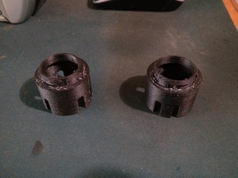

Progress is being made: my first prototype was too small in the female side due to a bad measurement I made, so it didn't fit over the male spiral. The second prototype fits both spirals, though it is a little too long and the throat is too narrow to fit the central core that holds all the spirals. I didn't realise that 120 sits so loosely in the spiral with about 3mm clearance on each side, so this adapter causes there to be that much clearance. I think it's a bit too loose for the wider format, so I've made the adapter a bit shorter to see if that works better - it might have been an error to do so though, I'm not sure.

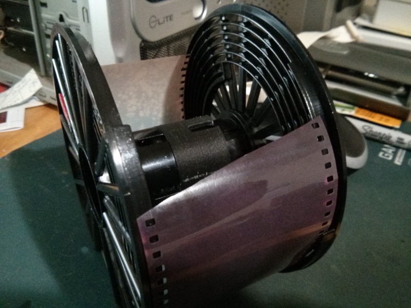

Fingers crossed for a 3rd prototype to be printed tomorrow morning before the loaned printer is returned. See attached phone-photos, showing the two prints and a bit of scrap 70mm 2415 Tech Pan on a Jobo 2502 spiral. Edit: ew my mousepad.

Revision C works perfectly! I'll try to get another couple of copies printed off today and I'll be doing a biiiiig batch of 70mm tomorrow; I have about 50 feet of it sitting in the cupboard, exposed. Being able to develop more than one spiral at a time will be a godsend!

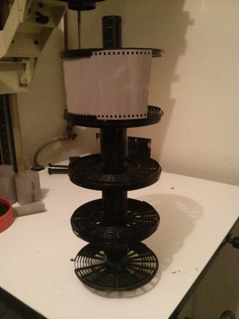

Anyway, I finally got off my lazy arse and used them to process about 3 months of 70mm backlog: about 6.2m (80 frames) of 2405 in one batch through the Jobo. You can see them all stacked up here on the core, with a scrap of film in one spiral for width reference.
