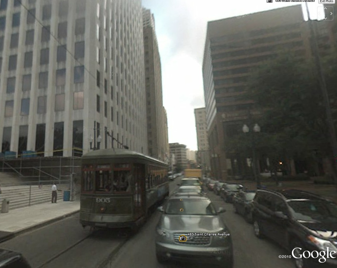

It's a street car cable, you can see it in google earth.
