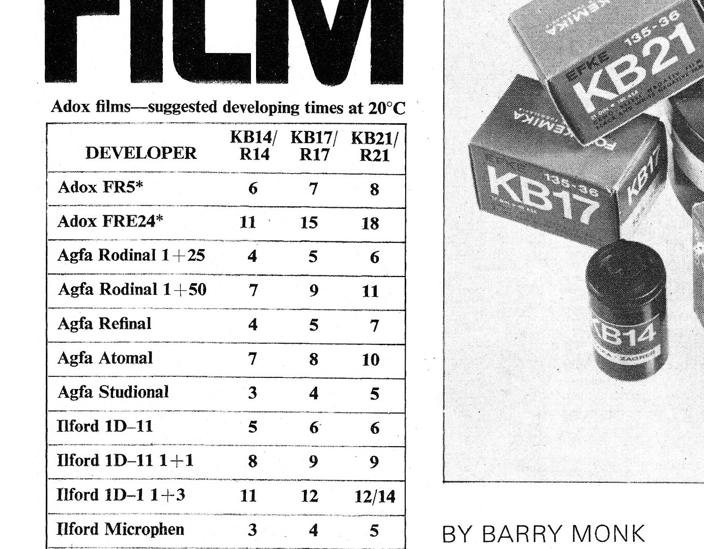

However I did find this:
Jessops R200 is R21
