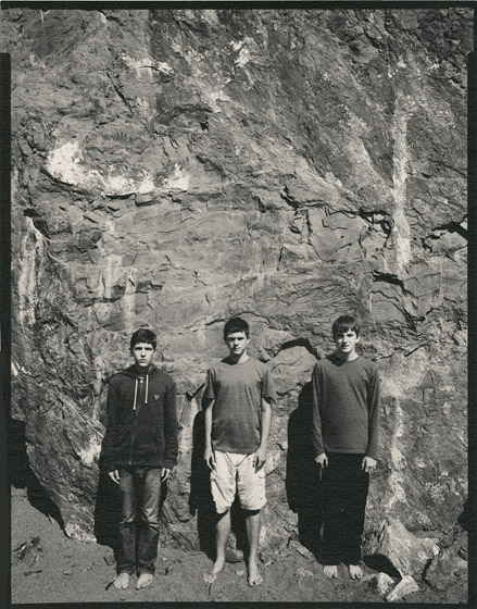

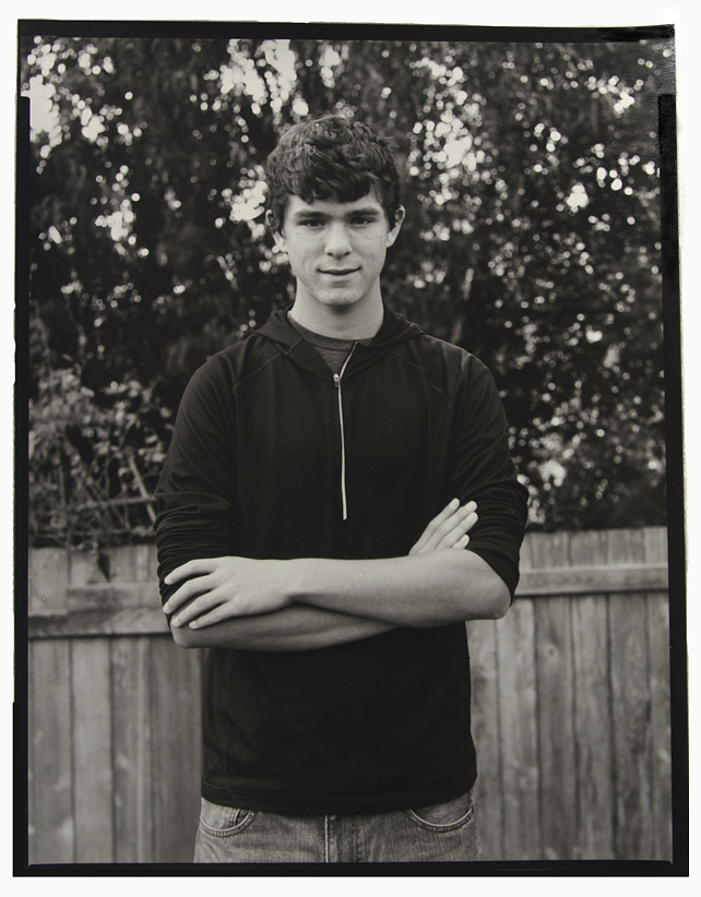

I've heard Ektalure kept amazing well. I have an unopened pack of 8x10 via eBay in my freezer. I'll get around to it and see.
That has proven true for me so far. A couple relatively recent 11x14 contact prints on Ektalure:
Was that the 'G' surface & toned? Have recently been given a pack of 16x20 from the last batch - was going to use it for 5x4 lith contact prints, but am now intrigued to see how it compares with Fomatone 133

I believe it is the K surface...sort of a glossy texture. It is a warm paper. My prints are untoned...I can not guarentee that my color reproduction is accurate for the Web, but should be close. I imagine that selenium toning of this paper could be beautiful.
I just found the paper package (actually a unopened package of ten 16x20 sheets!) of the K surface. The image tone is listed as brown-black, and the surface as "fine-grain, high-luster, warm-white (K)".
Cheers - another of the alphabet soup of Kodak's lustre bases...
Sounds quite close to what I'd describe 133's base as - 532 and 542 are lower lustre, 532 barely off white and 542 almost buff.
Looks like it's a bit more subtle & perhaps a hint cooler than fomatone - longer straight line, softer roll off in shoulder & toe?

...Looks like it's a bit more subtle & perhaps a hint cooler than fomatone - longer straight line, softer roll off in shoulder & toe?
Throwing a curve at me, eh? The stuff prints great if that's what you mean! :cool:

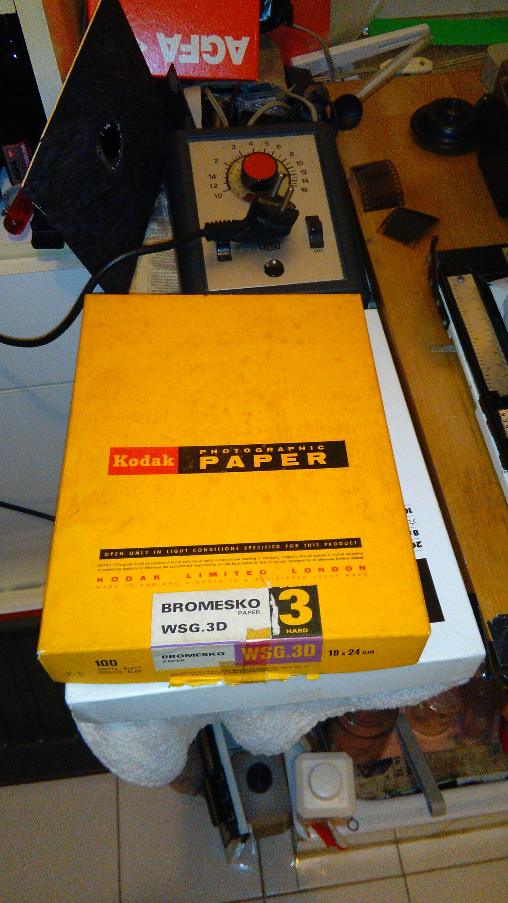

Sorry for the late post. This is the only kodak paper I have and used. Got it when the old photo lab of my course departmen was dismantled.
Love the tones and I still get good resuts, but unfortunatly, the previous owner choped the paper in 4x5 and small size!
Would love to use 8x10 or above of this paper!
