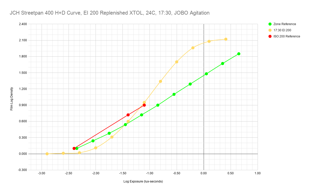

For reference, and if anybody wants to discuss.
I've made these exposures as carefully as I could and eliminated as many variables as I realistically could. While it is not scientific, and certainly not up to ISO or probably manufacturer standards, it is as accurate as I can make it with what I have available to me, and certainly accurate enough that I thought it would be share-worthy.
Each of the curves is from film base plus fog up to a correctly exposed 18 percent grey card in full stop increments using a studio strobe, and transmission rated lens set to infinity focus. The strobe was incident metered to 1/10 stop and varies less than +- 0.1 stops shot to shot. The intensity of the light to the film plane was controlled with the lens aperture, so once the strobe power was set, it did not change for the duration of the exposures. The 18 percent grey card filled the frame so there shouldn't be any flare.
The densities were measured with an X-Rite Densitometer.
JCH Streetpan 400 H+D Curve, EI 200 Replenished XTOL, 24C, 17_30, JOBO Agitation.png
Since the characteristic curve is so S-Shaped, I've centered the metered middle gray at the ISO 0.9 Density point. At EI 200, you have barely 4 stops from middle grey to film base plus fog, and just a hair over 4 stops over middle grey until it pretty much stops getting more dense in any meaningful way. If you wanted to center your middle grey in the middle of the s-curve, you'd be better off at EI 160-125.
A few observations: this is not a high dynamic range film. You're looking at barely more than paper DR at 8-9 stops. That might be a good candidate for reversal processing as the film base is very clear relative to other films.
I have not done the detailed analysis you have, but an examination of most of the images taken with this film rated at 400 show little to no shadow detail. Having evaluated a number of films using the zone system procedures, I reached the same conclusion as to its true speed. I've assumed that the 400 rating assigned to the film by its distributor is puffing to get it selling in the hot area of the market. I suspect that there are 20 rolls of 400 speed film sold for every one of lesser speed.
If it's a repurposed aerial film, it may well have an Effective Aerial Film Speed (EAFS) of 400, but your film speed at sea level is going to be at least a stop less or more. The steep curve only adds to the hypothesis that it's Aviphot 400S or something very close to it.
I suspect that the 400 rating is EAFS. By ISO standards that other films (like TMAX 400) are measured, this is nowhere near 400 speed film, at least not in 5500K daylight. From what I've read, it does have extended red sensitivity and JCH has stated that it's an old traffic surveillance emulsion that they've contracted to have coated for them. I strongly suspect that Harman is contract coating it for them as if you look at the inside lip of the canister where the barcode DX coding goes, on a significant number of canisters, there's a little overlap where the printing from other Ilford/Harman canisters show up. I've seen Delta 3200, HP5+, and the blue FP4+ colors/speed markings there. See the two attached images for the Delta 3200 marks on some of the recent JCH canisters that came through my lab. If that's not the purple Delta 3200 color and speed markings, I don't know what is.

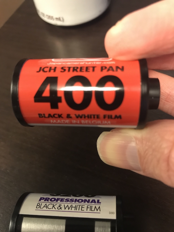

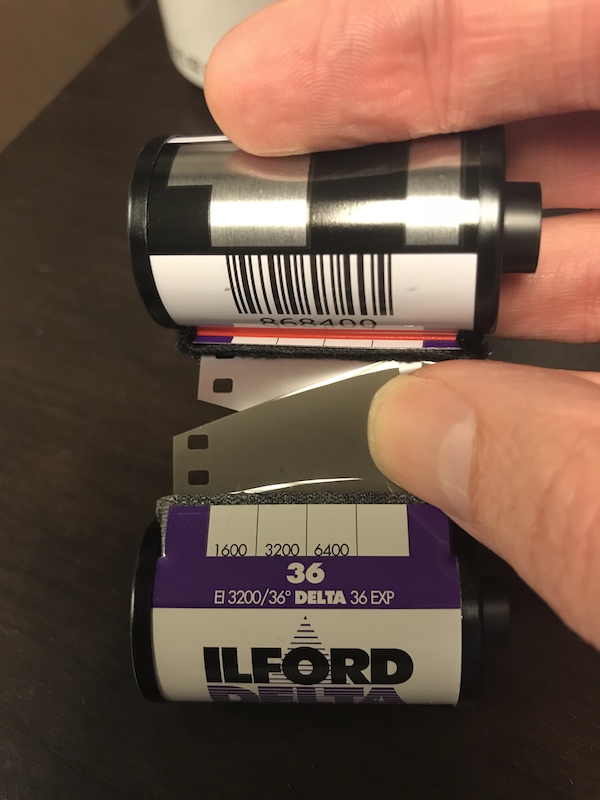

@Adrian Bacon Harman may have done the conversion to 135, the film itself is probably made by Agfa (Belgium).
That's totally possible. At a minimum the canisters are being printed on the same machinery as Ilford's are. I doubt it's old stock that they're pulling out of some deep freeze and converting as the halation layer has recently changed. It used to be a grey sediment that came out in the developer that I used to have to filter out, now it doesn't do that any more and instead stains the developer yellow. I suspect that JCH made that change because people didn't like that, it might have also been a more expensive halation and the one that stains yellow is less expensive.
The real effective / true ISO sensitivity of this film is in the ISO 50/18° - 100/21° range, dependent on the used developer. Your measurements at EI 200 with XTOL also show that quite clearly. It is typical for the (former) Agfa aerial / surveillance films, which this film is.
Harman has been doing the converting of this already existing film stock.

Does anyone know hoiw this film, with such a strong S-curve, would react to increased developing time? Does the maximum density increase at all of does only the middle of the curve go up?
I would think the maximum density would keep going up to a point, but don’t know where the upper limit is. I did a run at 12:30 and 15:00 and both of those had less density. I settled on 17:30 just so the total density range was right around 2.0-2.1. For scanning and prints, it doesn’t make much sense to go much beyond that unless you have a really good reason to.
I just think it would be an interesting option, a film that allows very high contrast in the midtones but rolls the highlights off gently, keeping them printable. It already is that to some degree, I was wondering whether one could get even more of that out of it, but if the highlights continue to rise in density with development, it won't be possible the increase midtone contrast more and print straight, keeping the highlights. Or not without giving away the increased midtone contrast again by moving to softer gradation.
Even at 17:30, you're already way over gamma 1.0 through the mid-tones. On a paper print that is going to be one extremely punchy print. I don't remember off the top of my head what grade you'd have to print at with a diffusion enlarger to fit a negative density range of 2.1 on something like Ilford MGRC, but either way, just expose to put the middle grey where you want it. Your range is EI 100 to EI 200 to put it roughly in the middle of the s-curve.

I have tested this film quite intensively when it was introduced in 2016. My tests of the chararcteristic curve and my comparisons to my former Agfa Aviphot Pan 400 tests showed me immediately that this "new" film wasn't new at all, but just former Aviphot rests.
The extremely strong and problematic S-shape curve you have got is absolutely typical for this film type. Very difficult to handle.
