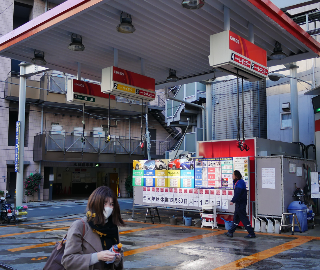

Take 28 mm and 105 mm and you are set. Tokyo isn’t all that different from other megacities, except for how surprisingly quiet it is for its size and how safe it feels. Those things inspired me so much that I ended up taking way more photos than I ever expected.
It’s also an incredibly photogenic city. I mean, have you ever seen a gas station flipped upside down?
I have not seen that before! Or
It could be you and others were upside down
