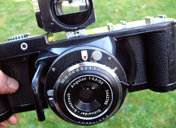

Angulon 90mm on 6x17
Well I tried it....I fitted the 90mm Angulon f6.8 to an old Linhof 617. No focus helical, I just made up an adapter and set the lens at its hyperfocal distance. Everything is razor sharp at f22 and f32 until we reach around inch from the edge, then it loses resolution considerably. No vignetting at all and it shows even exposure across the film plane. Mr Ham is correct, it will cover 5x7, but sharpness is strictly limited to 4x5 :surprised:
