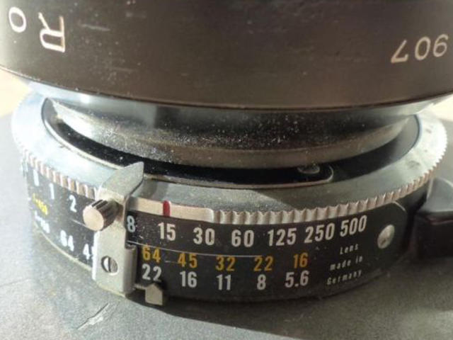

Something doesn't look quite right about that shutter (assuming I'm looking at the right auction). The aperture scale is not normally obscured by the front lens cell.
If it is an unmolested Sironar, it should perform reasonably well.

Hmm Paul.
Did some heavy digging then? Yes looks like the same auction image, just cropped a bit further. Interesting how you managed to dig that up.
Anyway. The guy reports that the timings are right. Out of curiosity. What exactly is it that seems wrong about it?
This would be my first LF camera. And the only experience i got with leaf/diaphragm shutters is on some old folding camera's. So dont really know what to look for aside from guessing the timing:tongue:
Sorry perhaps i should have shared the auction immediately. But last time i did that on some flickr thread, i ended up getting counter bid by all those that replied to my question:tongue:

Hmm perhaps i do see what you mean. When i Google on Copal #0. Which supposedly is the shutter on that board. It does look alot different. Kinda weird. As if someone replaced the levers and all. Then again i guess these shutters been made for such a long time some differences exist.
If you look closely at the little pointer, it should point to an F/stop scale that is just visible underneath the lens cell. It might be that the original shutter failed and an older one was substituted. Chances are, you will want to use different lenses once you get going, this one will enable you to learn the ropes.
Your auction wasn't that hard to find, but I'm not going to post a link to it here - You then have a fair chance on winning with your bid.
