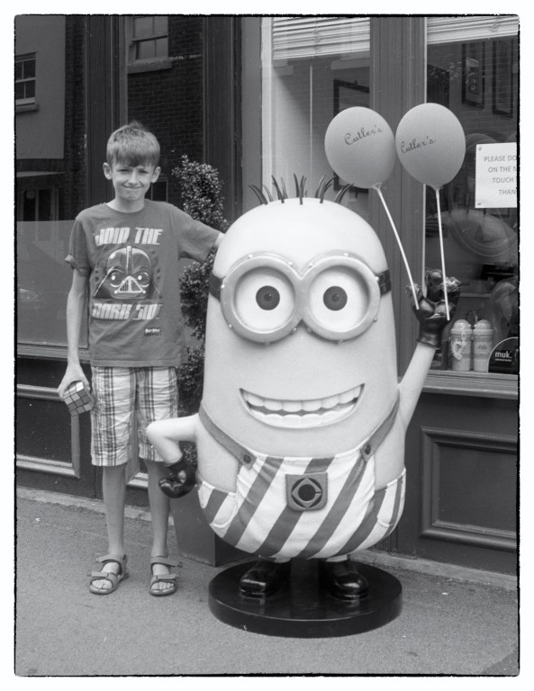

To give you an idea, here is a pic I took today:
attachment.php

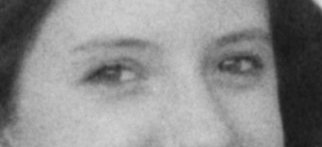

which looks OK enough, but the eyes of my son are like this:
attachment.php
which are, well, smudgy, lacking sharpness and detail. And although I hate to be a pixel peeper, I have to say I expected more from a 6x6 piece of modern film. I do come from a digital background, so this is my first year of shooting film, but should I be expecting better than this? This is rather indicative of the results I'm getting. I dunno, maybe I expected more.
I've cleaned the mirror and lenses (unscrewed and removed back and front elements and given them a good clean), the above image was shot (from memory) at ISO400, 1/500sec at around f10.
I have ordered a hood for the camera as this is supposed to help matters, but what else can you tell me? Or am I just awful at focussing (it's a damned hard camera to focus in my opinion). In all three or four films I've shot to date I can't say I've managed to get a single photo that made me go "wow, that's sharp" or "look at that detail".
Do I have a poor version of the camera? Needs a new lens? Needs a new photographer? Help?

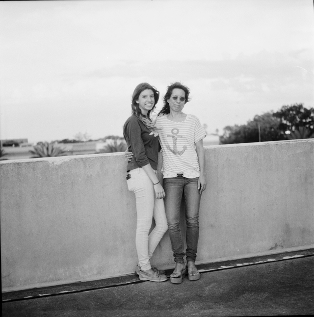

The below photo was done at a little further distance then yours (about 20-25 feet I'd guess), hand-held. Film was Arista EDU 100ASA, shutter speed and f-stop I don't remember, but it was definitely slower than 1/250, possibly lower than 1/125. F stop was most likely in the f/3.5-5.6 range. Scanned (Gasp!!!) on a Canon 9000II F at 2400 dpi (or maybe 1200 dpi). The crop is at 100% of my daughter's eyes, and I think it's closer to what you were expecting from yours.
If I were you, I'd probably burn a roll doing nothing but focus tests. Hang a newspaper (an ancient news distributing system used before the internet, but after town criers, and still available at your local convenience store), and do the test mentioned above. I'd probably do it both with the magnifier and without, as somewhat of an eye test. Really scrutinize the negatives with a loupe/lens, and compare what you see through the loupe with what you see on you computer screen after scanning.
