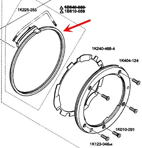

If your camera is broken the fix is to get a new aperture index ring, I think it is a common problem that seems pretty easy to figure out.

Turns out the AI tab was broken off, presumably by someone that tried to put a non-AI lens on it. It's manual forever.

Very much thanks for this! Looks like PN 1B610-059- Wonder if you need all three parts in the above pic to put it back together.

PN 1B610-059
I bought just that one part. It was something like $20 .After installation it has to be calibrated and that is reason why my regular tech could not do it. Other Achilles heel of F100 are plastic teeth of back door. Again wrong material was used. They are now super hard to find. Other that that, amazing camera!

I have a non-stop hour searching for this part all over the internet to no avail :sad:
I'm thinking I'm going to have to buy a parts F100 just to get this piece off.
