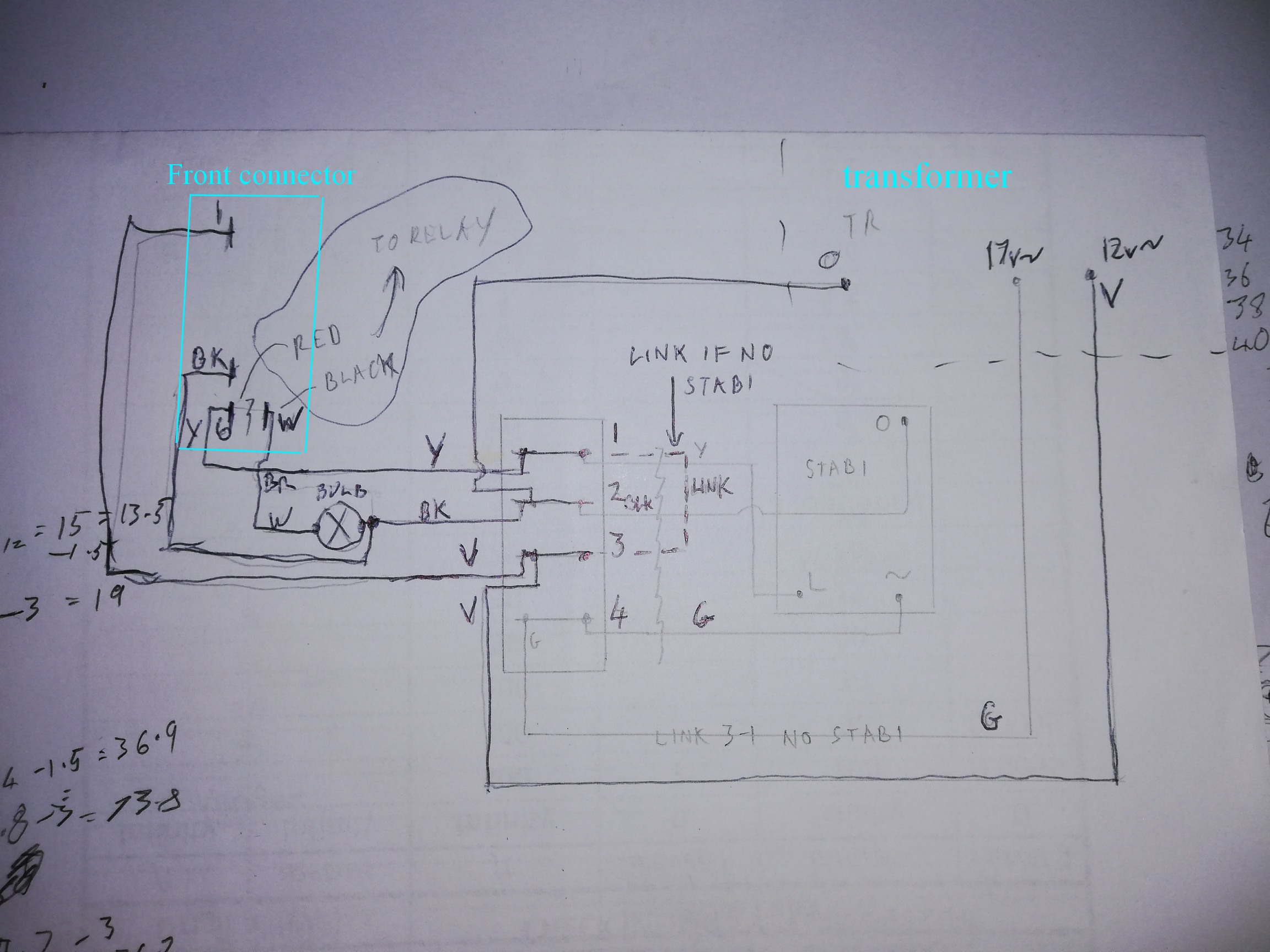

Fixed my stabiliser a few weeks ago by replacing a few faulty old caps.
If you want to take it out, remove its three wires (green. yellow and black) from 1,2 and 4 of the connector block, then place a link of equally thick wire between terminals 1 and 3 on the block linking the yellow and 2x violet wires still on the other side of the block.
FYI -
The transformer puts out 17v ac on the green wire used only by the stabiliser to provide regulated 11.7 v on the yellow.
12 ac is output from the transformer on the violet wire now linked to the yellow which goes via the multi plug in the front of the lamphouse back to the bulb (white wire). The other side of the bulb is directly connected to the black wire on terminal 2 of the connector block (transformer common).
Steve.

Hi,
FYI -
Steve.

Thanks for the step-by-step guide. As I have played around in the connector block myself, I don't know if my setup is the same as yours at the moment. Here is a table outlining what the connectors are in my setup. Texts in bold are the wire I unplugged and now trying to reconnect the rest. I tried routing the thick yellow wire to connect it with the thick green wire, guess that's why the lamp blew..
I am also using the M70 Micro, will the connections be different in this case?
Green (to stabiliser) empty Black (to stabiliser) Yellow (to stabiliser)
Green (from transformer) Grey (from transformer) Violet (to the bridge connecting M70 Micro unit) Black (to transformer) Black (from bulb) Yellow (from the bridge connecting M70 Micro unit)

Hi Steve,
I cannot recall a grey wire but there are a lot that come from the voltage selector IN to the transformer.
I do not have the micro unit but the only connections that need to be changed for the stabiliser are those as you stated, remove them and put the link to connect remaining yellow to violet. The violet also goes off to the front connector as does the black I believe to power the Micro if fitted.
The yellow goes to the front connector and comes back white through a link if Micro not there, this is removed so that the Micro can switch the lamp when it is installed. I use this as my timer connection in an attempt to shorten warm up as the transformer and stabiliser are always on with just the lamp being switched - as the Micro unit would do.
This is the diagram I drew to test without the stabiliser when I fixed it, Relay refers to my timer.
