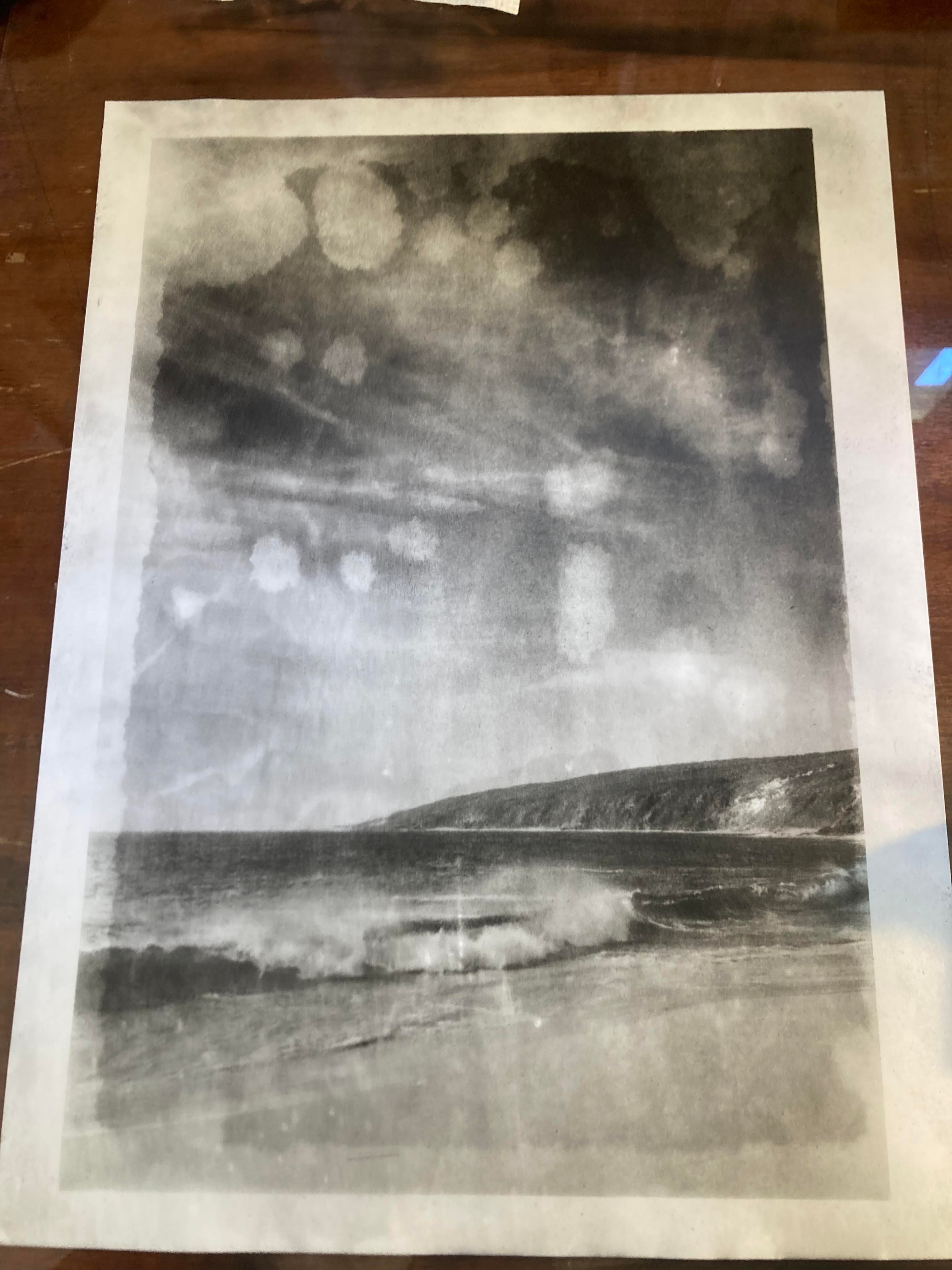

I'm edging close to insanity - I've been having constant issues making Bromoil prints. Simply put, the 'spots' that show up during processing (as a silver gelatin), refuse to allow ink to adhere evenly on paper.

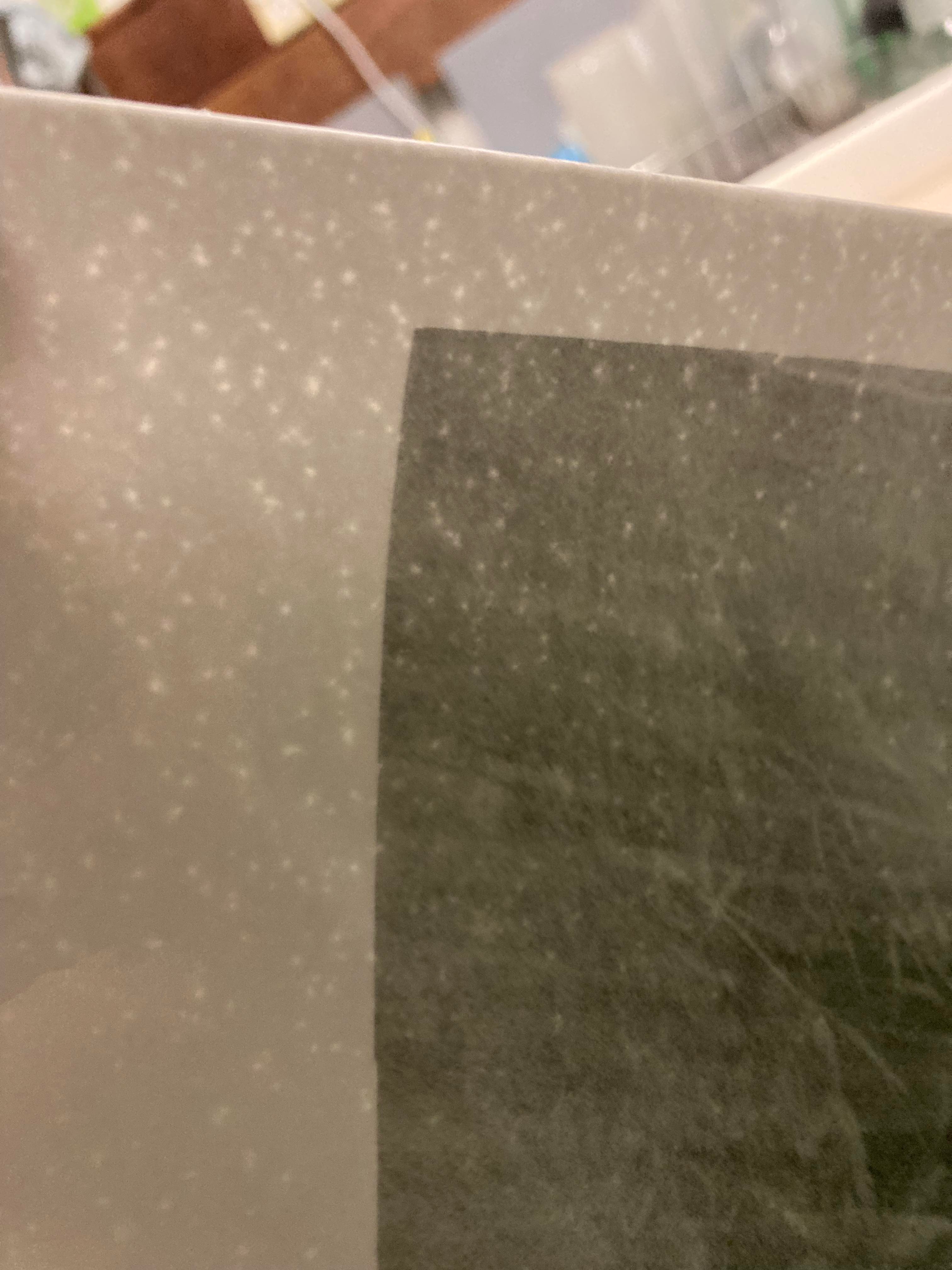

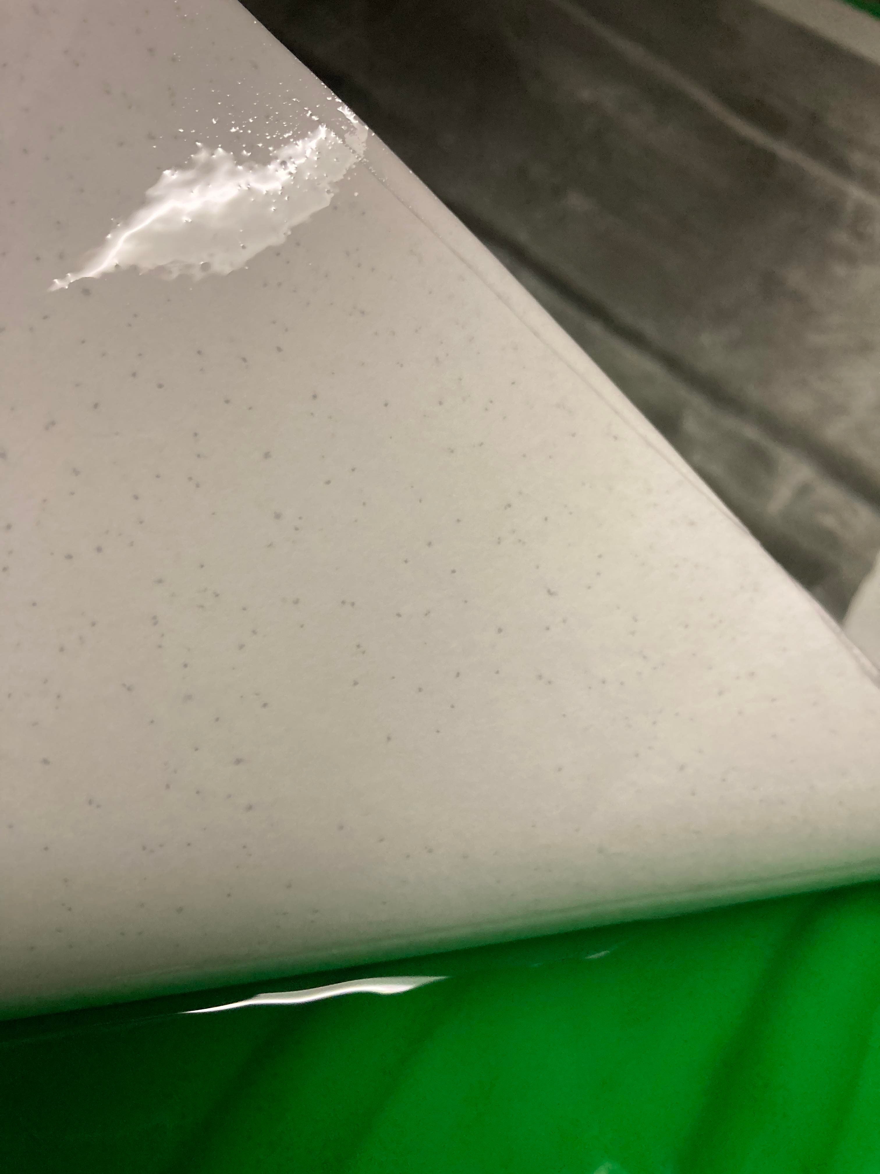

During processing as a silver gelatin, hundreds of dark/black 'spots' show up on the base (non-emulsion side) when the paper comes into contact with any form of liquid for a time longer than 5+ or so minutes (fix, wash etc). Spots seem to make the paper look translucent when paper is held up against a light source when looking from the emulsion side.
The spots go away when paper is dried... however they return as soon as the paper comes in contact with liquid again (e.g. for toning, or bleaching in this case for bromoils) and the size of the spots are larger than originally seen when first processed.
These (now large) spots end up being the exact locations where ink won't properly adhere in the final inking stage of making Bromoil prints.

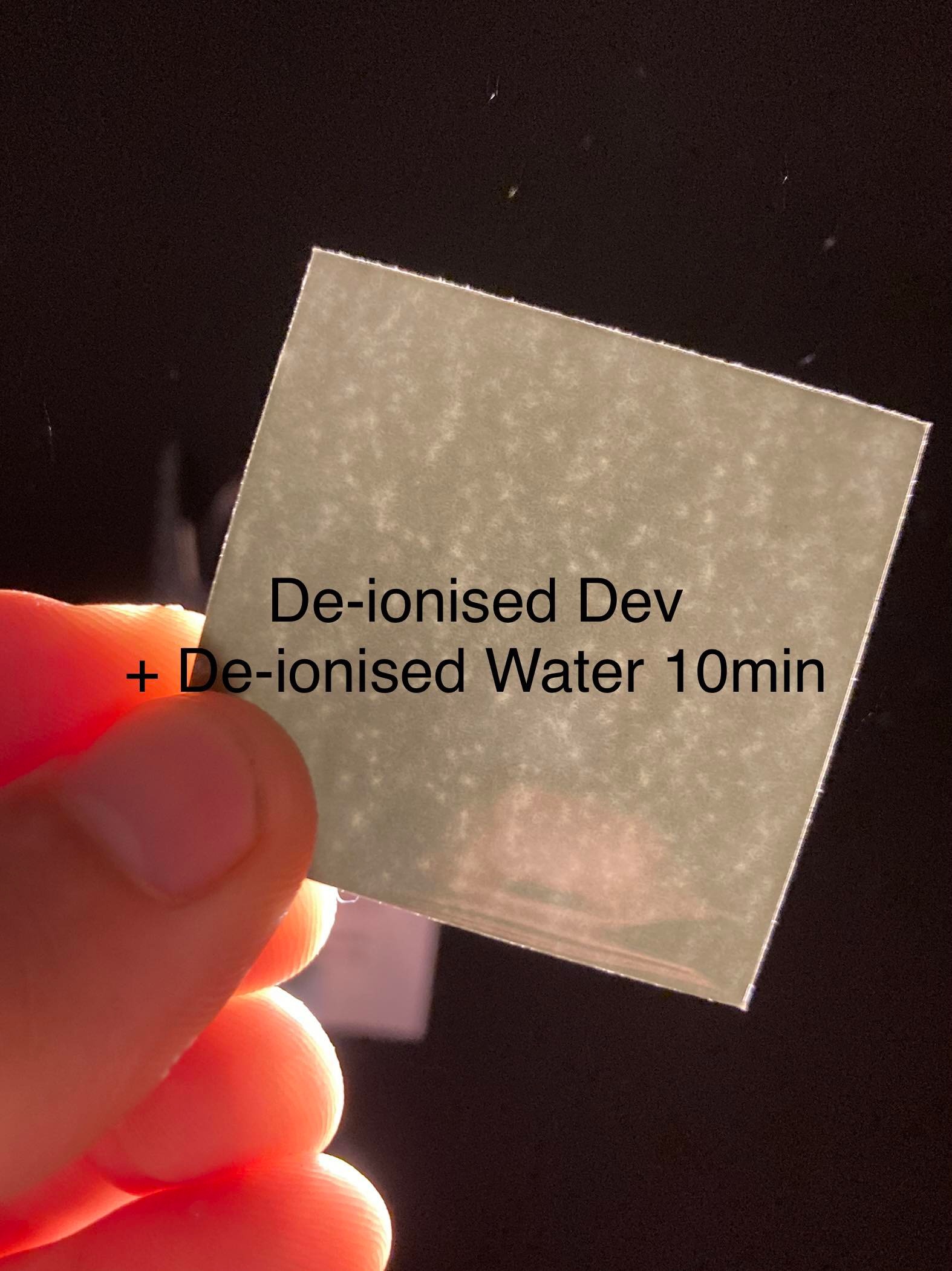

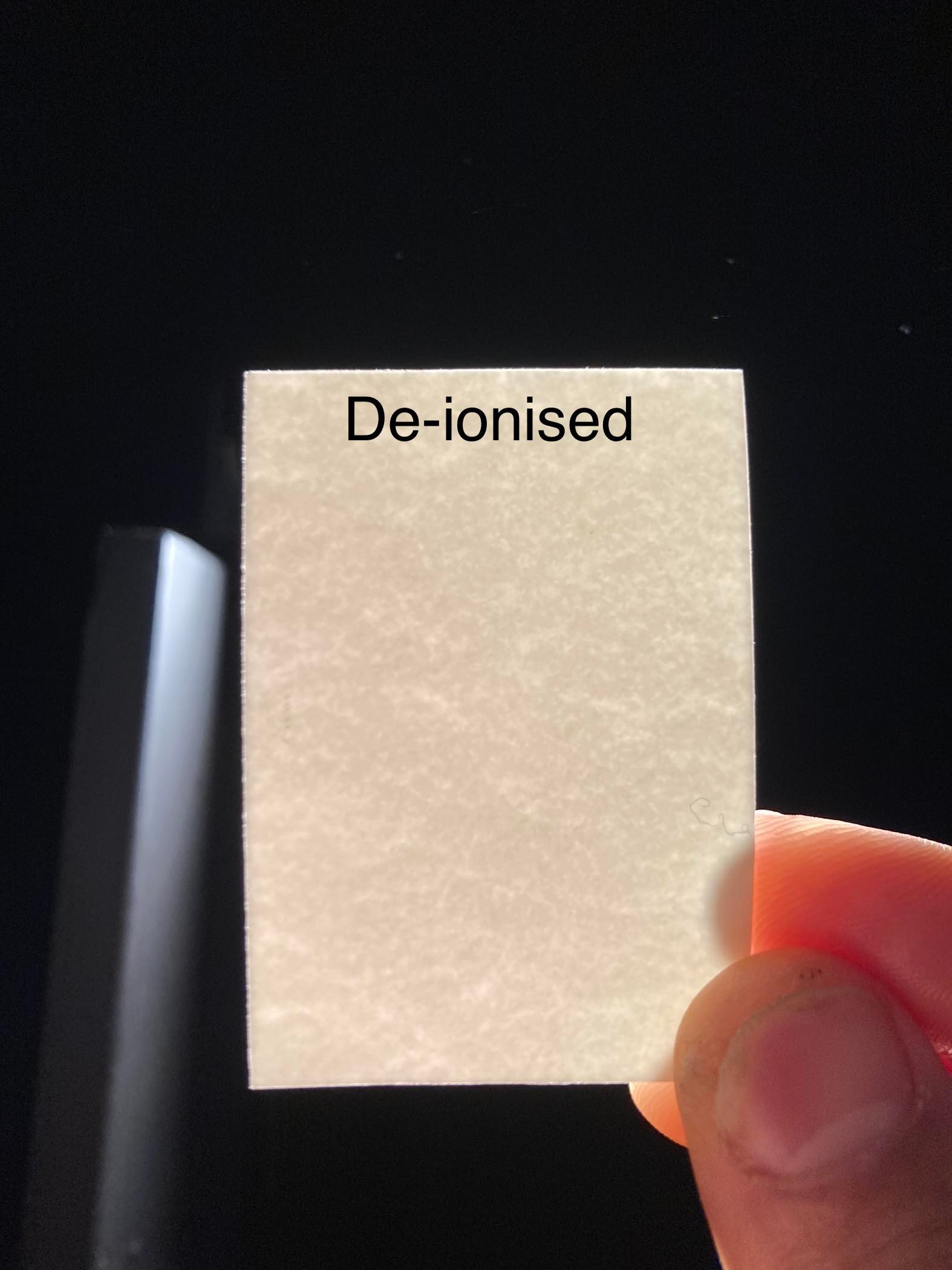

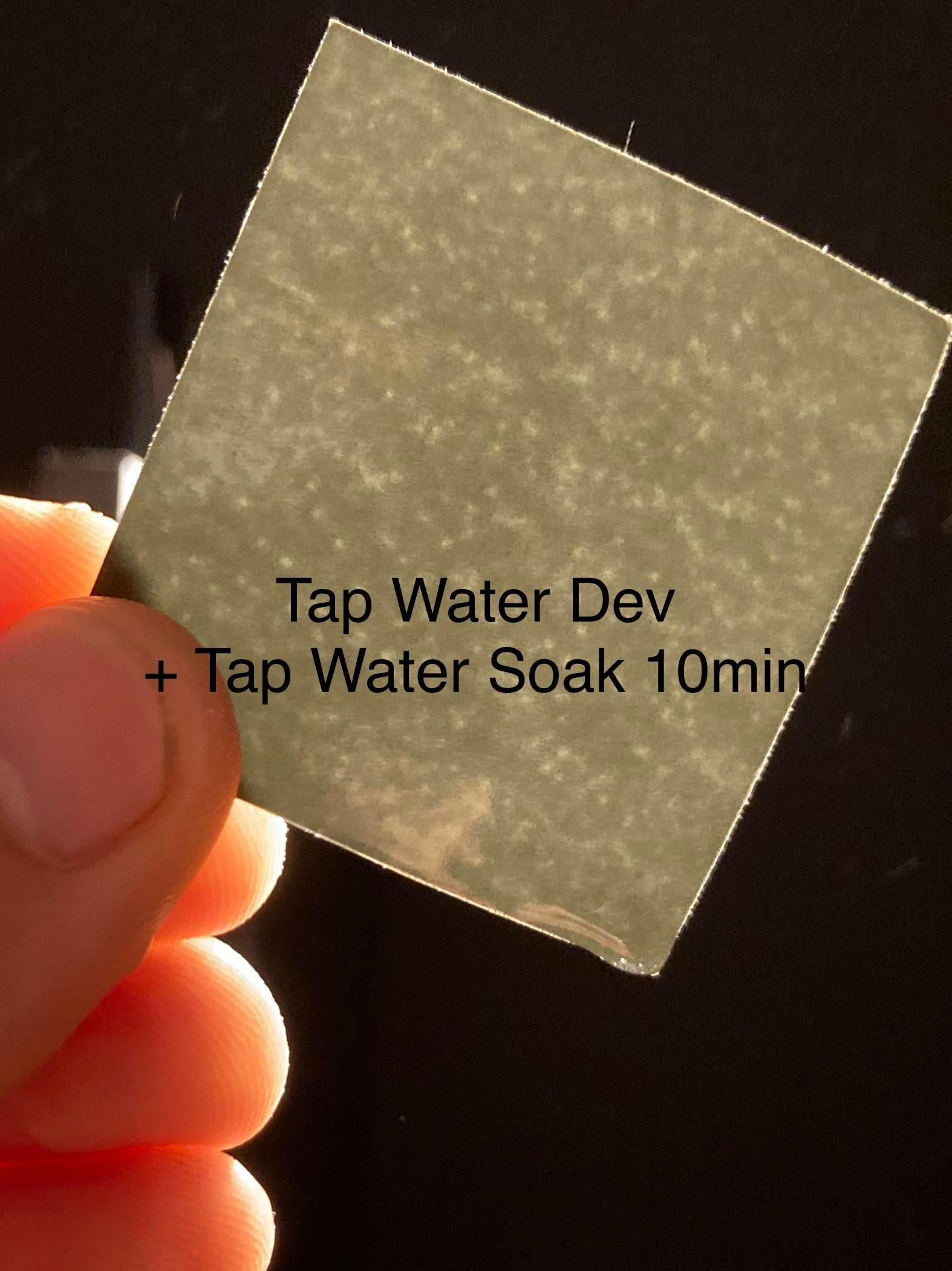

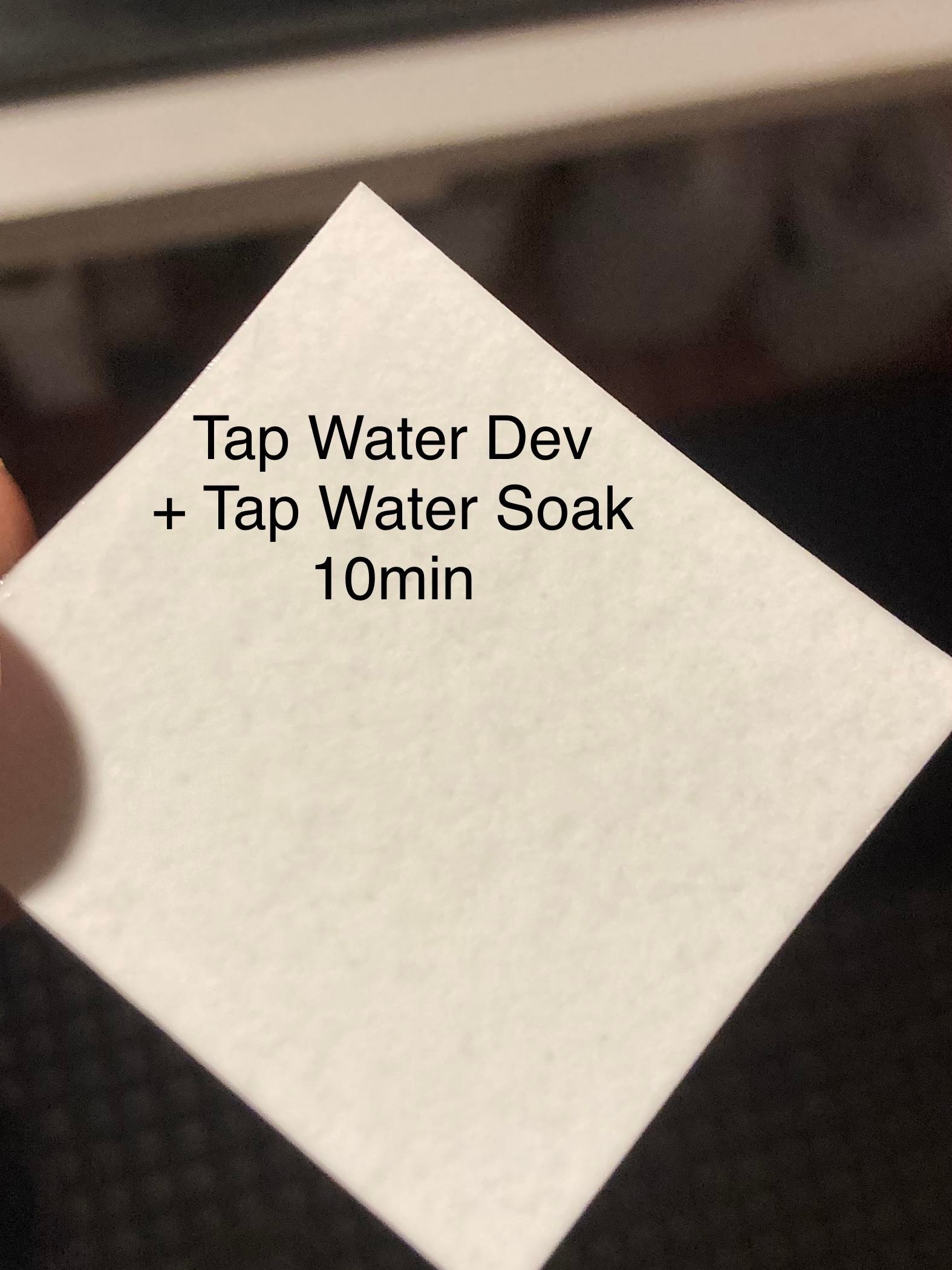

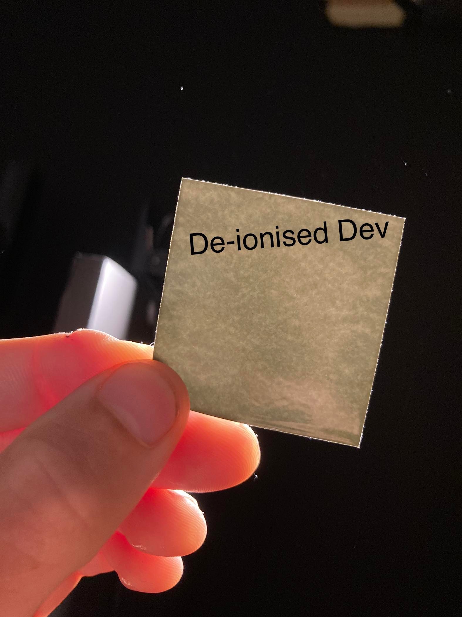

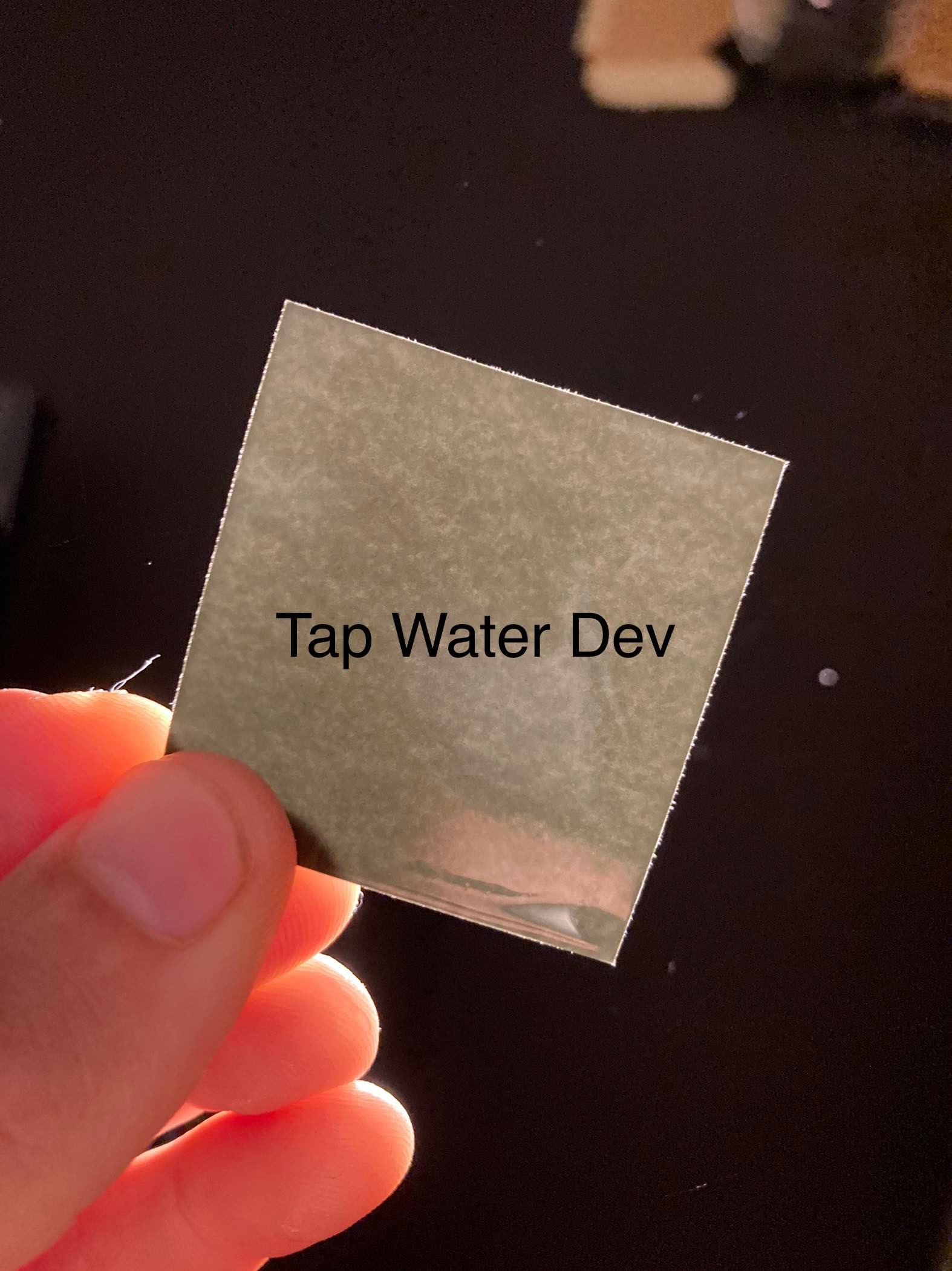

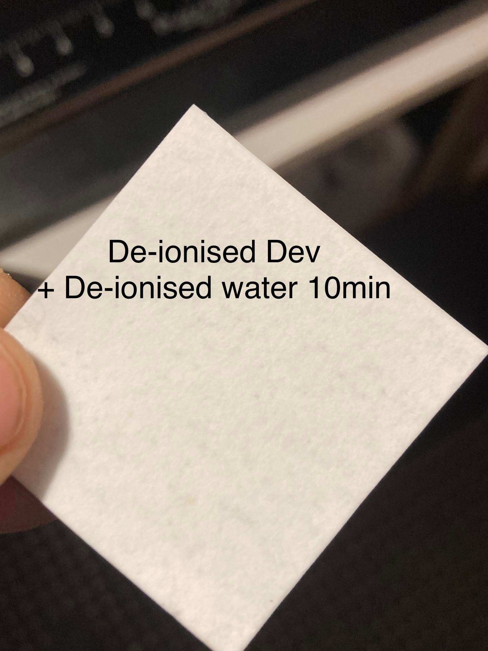

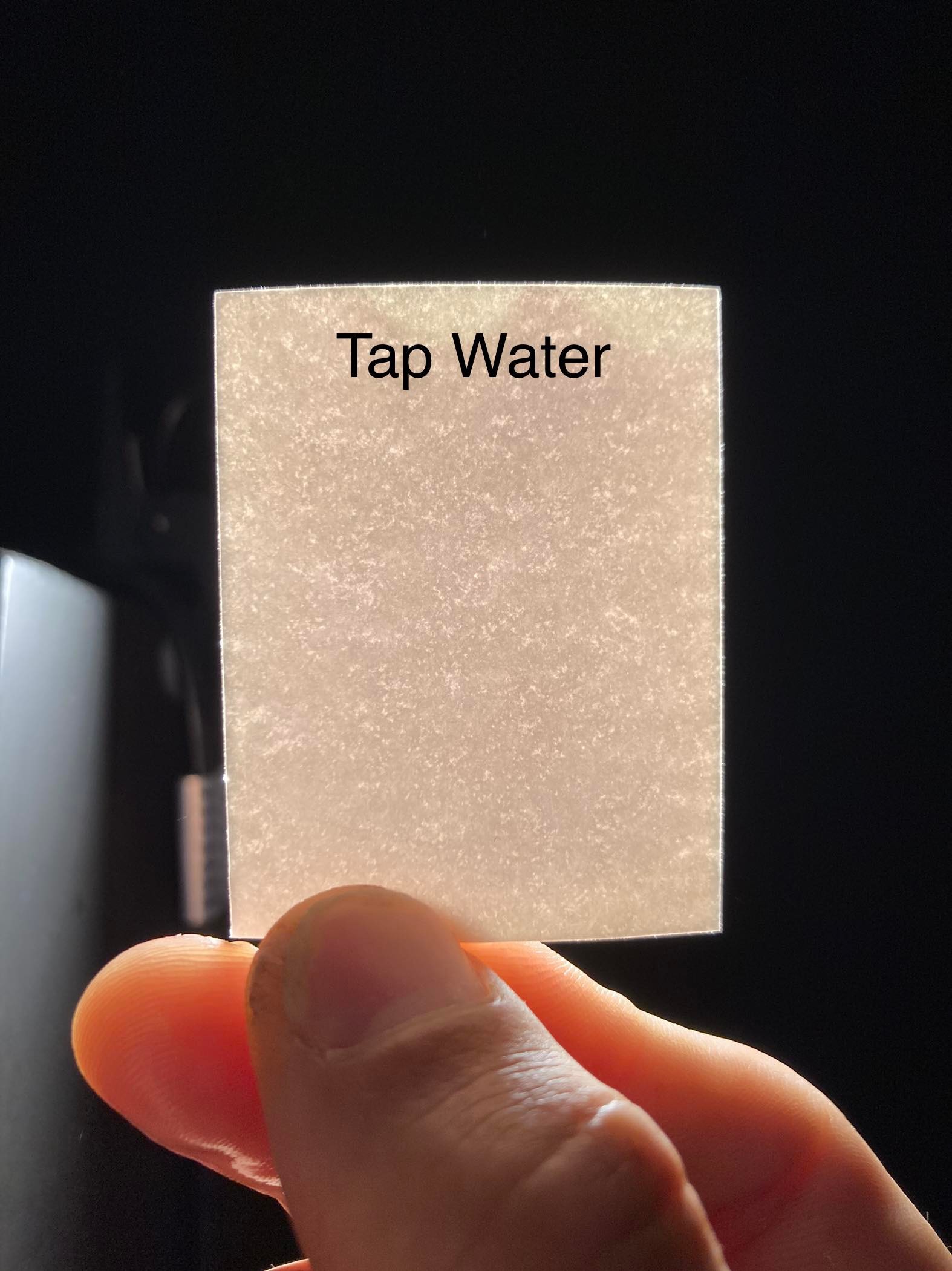

Thank you both for your input. Just went back to basics - dunked some bits of the same Ilford FB Matt paper in water vs deionised water, plus developer mixed w/ tap water vs developer mixed with deionised water. Slight differences observed when they were just soaked in the water baths, but the issue of the black pepper spots appeared when in the developer... Pretty much new MG developer, batch for this test freshly made.
Quite frustrating I must say! I've found a couple more threads on photrio regarding the same or similar issue, couldn't find a solution however...

Update: Issue solved (I think).
Blotches seems to be areas permeating into the paper through the 'pin pricks" (black dots on base side). The blotches become larger as time progressed, so I intentionally extended soaking time to have one large blotch covering the whole paper... and now we're all good!
