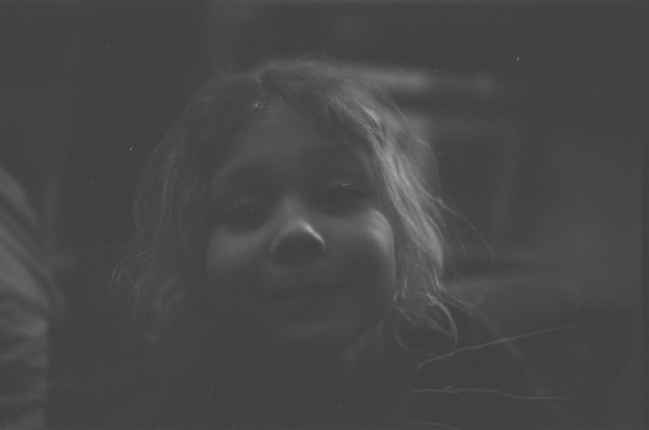

Hi,
I did develop my first film (hip hip hooray).
I noticed on some photos strange signes like the shadow lines or trees (see attached photo).
Do you have any idea what that could be, i.e. what I did wrong?
Jarek

Or a double exposure.

These do look like bare branches of trees. They seem to be spaced out as small trees would be if they were planted in the ground such as say small fruit bushes that have no leaves. It looks like an accidental double exposure to me. Can you remember having your camera outside and near some small bushes in the ground that had recently been planted where you may have accidentally pushed the camera's shutter button?

HI,
On other pictures there are just lines, see another example.

I'm with Matt dbl exposure. Need to see a photo of the negative strip. Did op remove a partially exposed film, then put film back in? Something is wrong. Unless this is trolling

Foma strikes again. With problems of Fomapan 400, Foma 100 R (there's a topic about) and whatnot, what is happening at Foma?

Static electricity which occurs when film is advanced quickly in very dry weather. Advance film more slowly.

No trolling. Neither double exposure. The film is Fomapan 100 shop loaded from bulk. (I used a cheap film for the film developmet training). This video describes such effect: .

It's virtually impossible to force this effect in-camera as a photographer. It's more likely caused during film confectioning.
I had it happen to me so I know that a photographer can force this. When it happened, it only happened that day on that roll when I advanced the film quickly, never when I advanced the film slowly. I was very aware when I advance quickly and when I did not. There was a very direct isomorphic relationship to the speed of advancement on a very dry windy cold winter day.

Two same identical problems on the same film can't be a photographer's fault. It has to do with Foma.

Those are electrical discharge marks, if you found it in several places it is a film defect.
This has been reported a few times over the years, mostly in Foma, Forte, etc. films.
Call the place that sold you the film and complain, they should refund you and send you a roll
