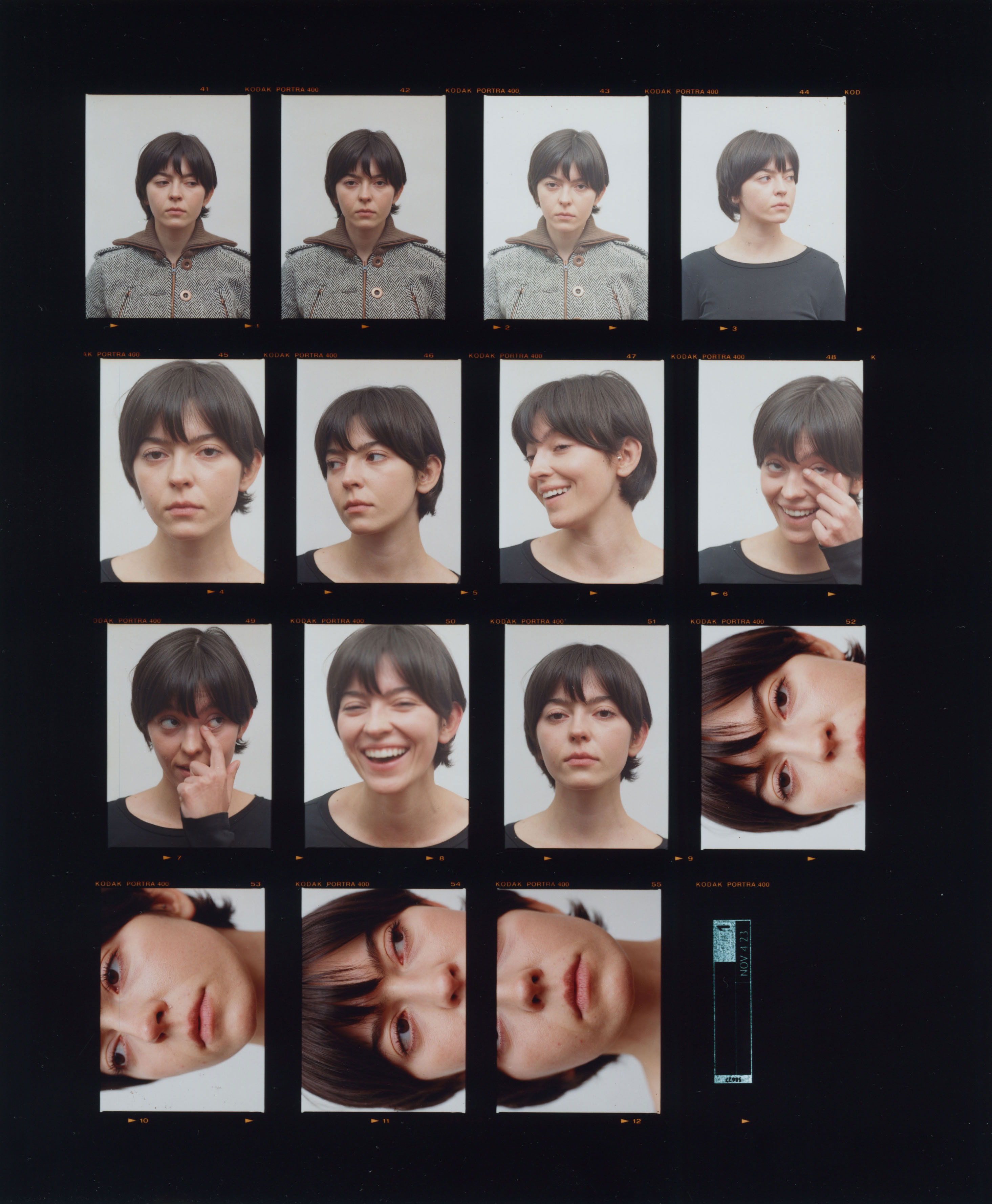

Contact sheet for reference. All photos were shot at the exactly same settings with the exact same lighting, however the portrait orientation photos are washed out / hazy / low contrast.
Thanks a ton in advance.

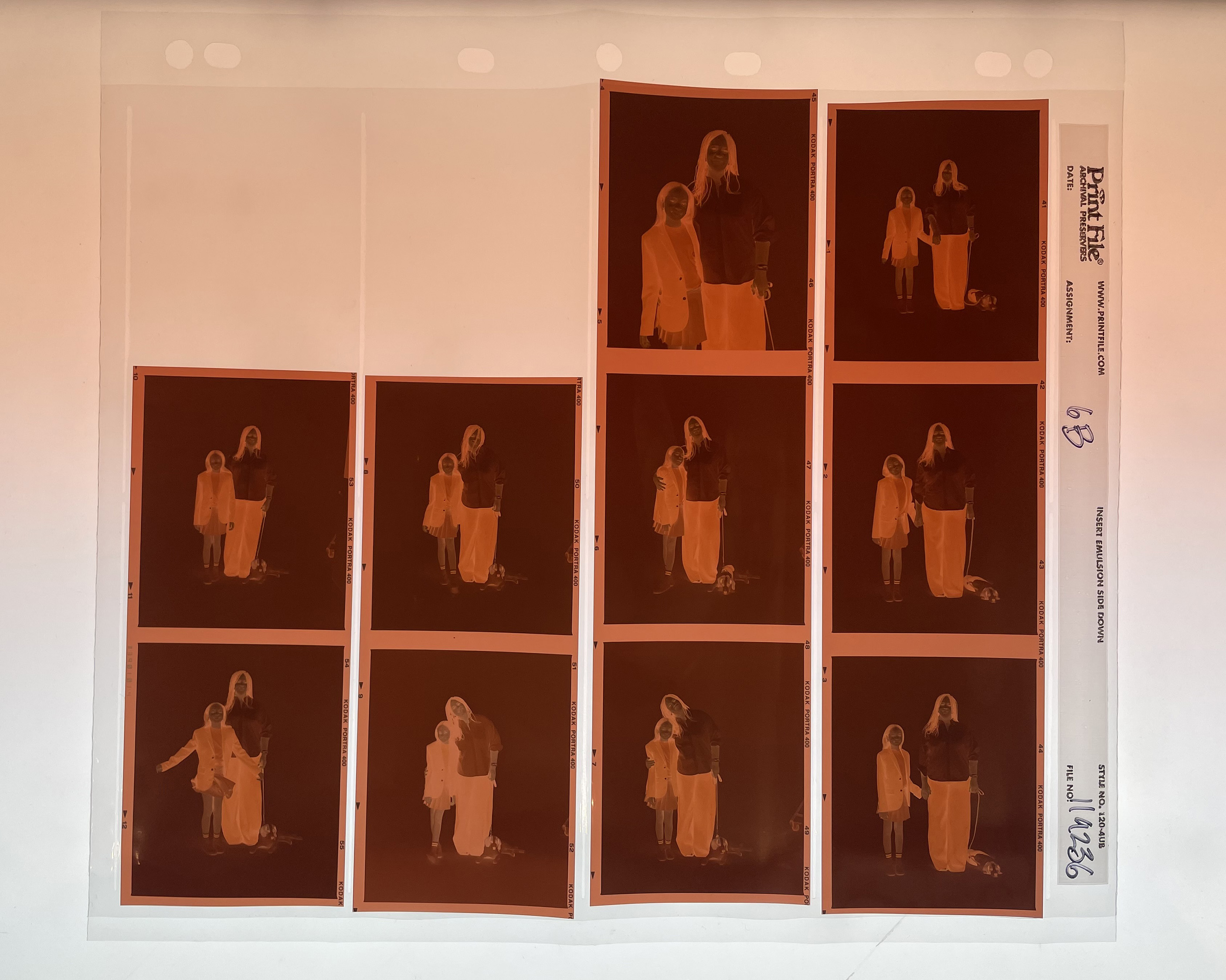

While I don't have one of the previous images shown, I do have some more recent photos where the exact same thing happened. Same camera, same settings, same film, same lighting — everything the exact same, except the result when using the 67 back vs. the 645 back. In the attached you can see how the images should look (on the 6x7 frames) a nice, dense negative. But on the 645 roll, the film looks quite low contrast. Let me know if the images give you any more insight.
Thanks again.
I note in the 6x7 negatives shown, there are significant differences in the exposure between frames 9 and 12 - with the less exposed frame looking more similar to the 645 negatives.
I think I see overall fog in the 645 negatives, which makes me think of light leaks.

The exposure next to the "9" marker on the 6x7 roll was a strobe mis-fire, so you can disregard that. The 6x7 roll is generally as expected. Still very curious about what is happening with the rolls shot on the 645 backs. Light leaks could be an option, but seems really peculiar given that I've tested it on 2 different "mint" condition 645 backs, with 3 different RZ Pro ii bodies and various lenses. Yet the problem only occurs when using the 645 backs.

It is difficult to see, but I don't think I see any sign of fog that bleeds into the area of the film outside of the image, which leads me to believe that it is something related to the interaction between the camera, the rotating adapter and the backs.

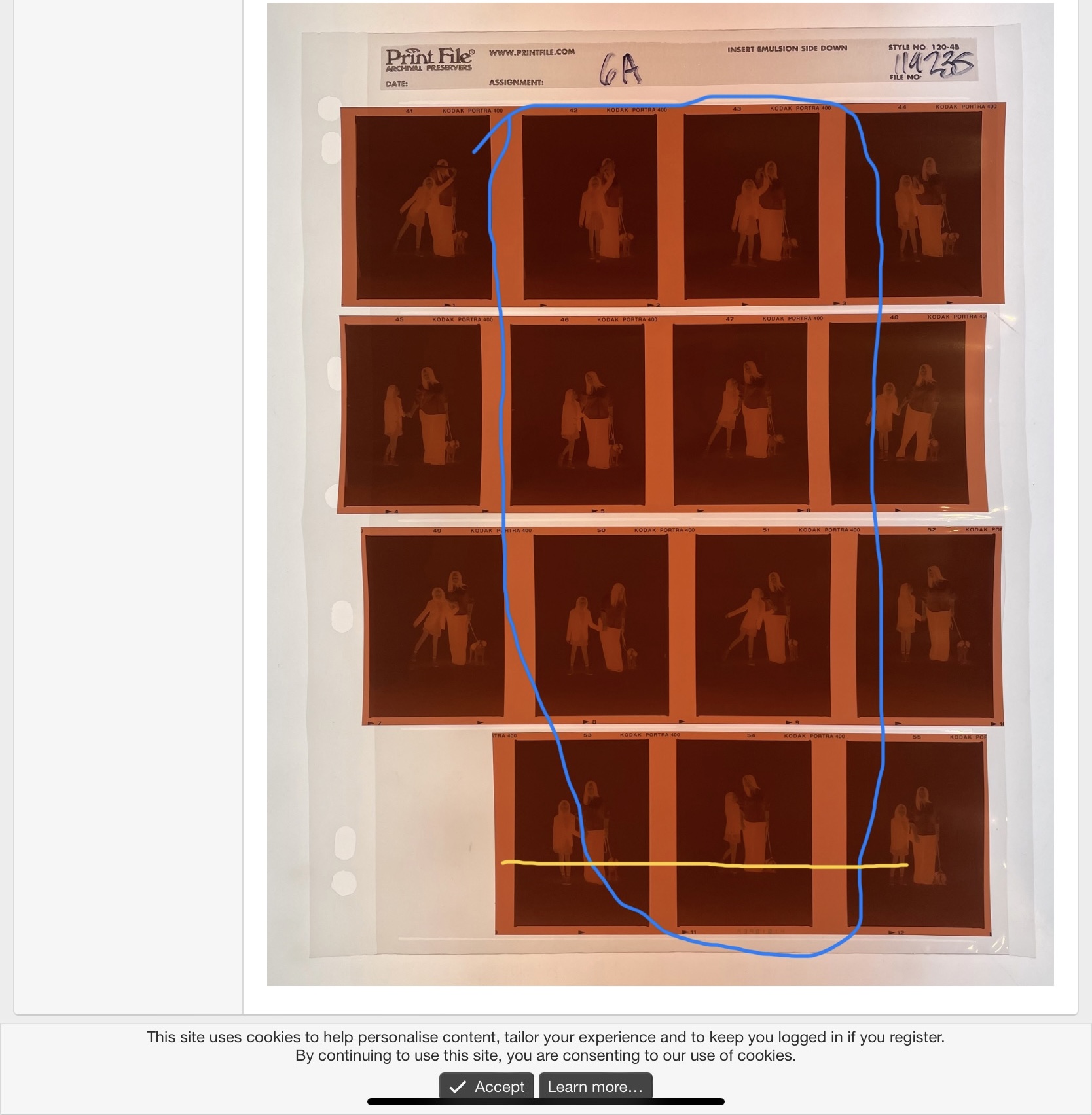

It doesn’t help that your light table looks all over the place exposure wise. For help with a question like this, the light on the negatives has to be dialed in over the whole roll, or else everything we can see/observe is faulty.

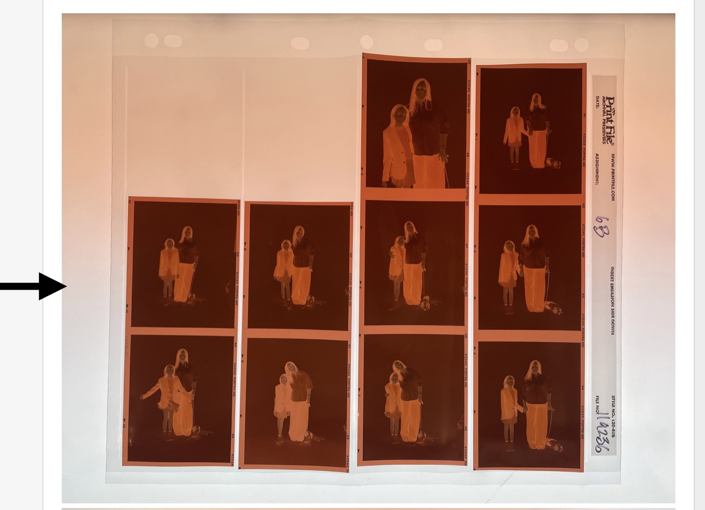

On the 6x7, look midway down the panel, where I have marked with an arrow. Exposure completely different, and I am referring to the whole thing, not just the negs themselves. The light isn't constant density.
The 4.5x6, there is a hot spot on the entire surface, and in the lowest row where I marked a yellow line, the frames themselves look like they change density midway down. I’m sure they do not, it is uneven lighting below the table.
I wish I could offer a possible answer to your question, but these add more problems than they solve.
