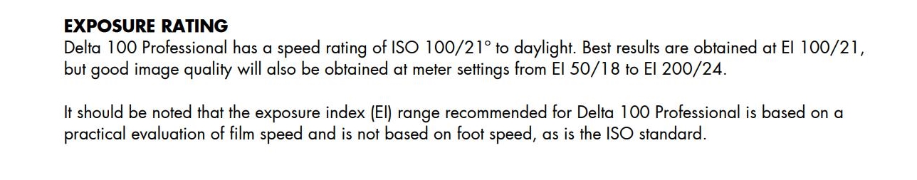

Hi guys.
The sensitivity of an emulsion must (should) be linked to the ISO standard which provides for:
ISO System (International Organization for Standardization)
The sensitivity is calculated on the basis of the minimum exposure E necessary to have a density of 0.1 above the veil, as in the DIN standards. However, the development, with a methol-hydroquinone bath, must be carried out in such a way that the density at the point Emax (such that LogEmax = LogEmin + 1.3) is 0.8 higher than the density corresponding to Emin. This ensures that the minimum density of the deepest shadow is well above the veil and that the density interval between the deepest shadow and the maximum light in a normal contrast subject is no greater than 0.8.
Because the producer Ilford in ALL film datasheets, writes this sentence ??? ""It should be noted that the exposure index (EI) range recommended for ... (all type film) is based on a practical evaluation of film speed and is not based on foot speed, as is the ISO standard.""
However, it writes on the packaging, for example, 100/21 ISO-DIN ... Isn't this an incongruity?
Many thanks.
Kodak had the ASA portion of the ISO standard loosened to allow more realistic practical testing when they introduced Tmax films because they couldn't pass the existing standard. The ISO is a combination of the ASA/BS and DIN standards.
So like Kodak Ilford no longer use testing based on foot speed, however that didn't alter the effective emulsion speeds.

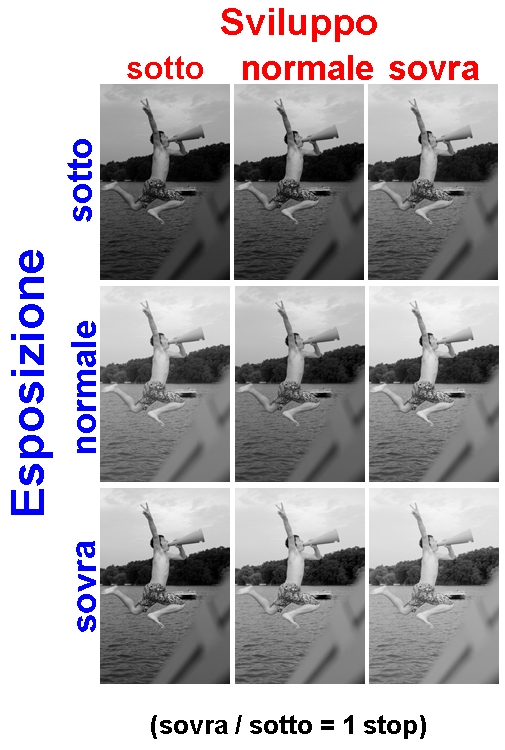

normally when I try a new film (or developer, paper, etc) I rely on the old ring-around system. It's always a great and easy system because my eyeballs will decide what I like and consequently the speed of the film.
thank you very much Jan.
Then I can behave normally and expose (reflected light) for the speed of the box; both for Ilford, Kodak etc. Taking into account that I will have an average gradient (G) of about 0.6 .
That will certainly give you very decent results!
Many thanks.

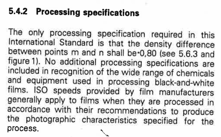

If you read it carefully, they are saying the film speed was tested under the ISO standard. When referring to the meter / camera settings, they use EI. It doesn't say the EI is the speed of the film. Just that the meter can be set to EIs different from the ISO setting. Ilford is pointing out there is a distinction between ISO and EI. One is the speed of the film and one is how the meter / camera is set. This way people aren't confused when they run across EI ratings in the datasheet. Notice the statement "Best results are obtained at EI 100". In other words it means the film has an ISO of 100 and the best results are when the meter / camera is set to EI of 100.
The contrast parameters from the ISO standard is part of the Delta-X Criterion which is a mathematical method to determine the fractional gradient speed point using a 0.10 fixed density point. The paper should be available here:
Most personalized testing will introduce known and unknown testing errors. Plus the majority of which have flawed methodology that guarantees inaccurate results even if the steps are carefully followed. The best best is to make sure the film is processed to the proper average gradient and field test the EI that suits your needs and approach.

You are confusing rating the film and using the film -- two different things.
One is how sensitive the film is to light and the other is how one uses the film's sensitivity to get what one wants on the film.

If all manufacturers recommend exposing for IE recommended, why is the old axiom, expose for shadows and develop for highlights a dogma? Why should I expose a 100 ISO film to 25 ISO (and under develop).
Well, the dogma works for many people. Look at the 'ring-around' above - I prefer the lower left image which is (photoshopped to look like it was) exposed at 1/2 box speed and developed for 75%(?) of the datasheet recommended development time.
I look at box speed as 'the most underexposure you can give and still end up with a good (though not necessarily the best) print.'
For art photography it's all a matter of taste - and there is no accounting for taste. Expose and develop as thou wilt.
