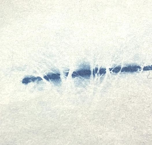

My first attempt at pinhole in-camera cyanotype. 12 hour exposure.
Well, you've got something other than just the sun trail itself, so I'd say that's a good start. Traditional cyanotype? What size/distance pinhole?
