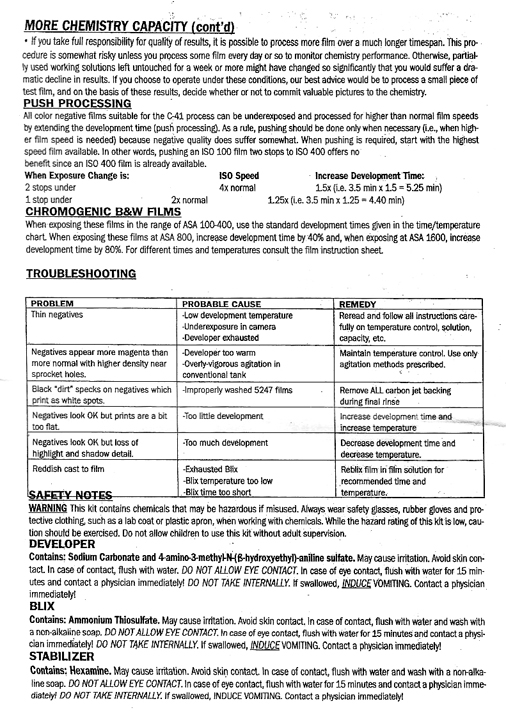

Superia is color print film. Color print film is processed in C-41 chemistry. The development time for all color print films is 3 minutes 15 seconds @ 103°F. Pull (under development) for over exposure is 3 minutes at 103°F, push (over developing) for under exposure is 3 minutes 30 seconds at 103°F. 3 or more stops over exposed or under exposed will require push or pull processing.

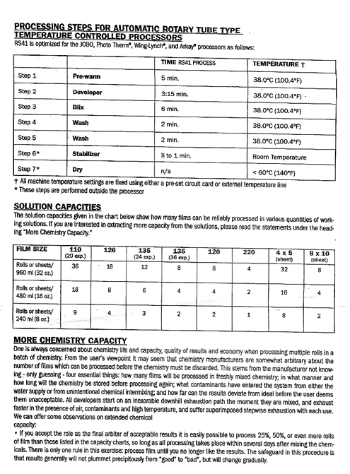

The correct temperature is 100F, not 103F.

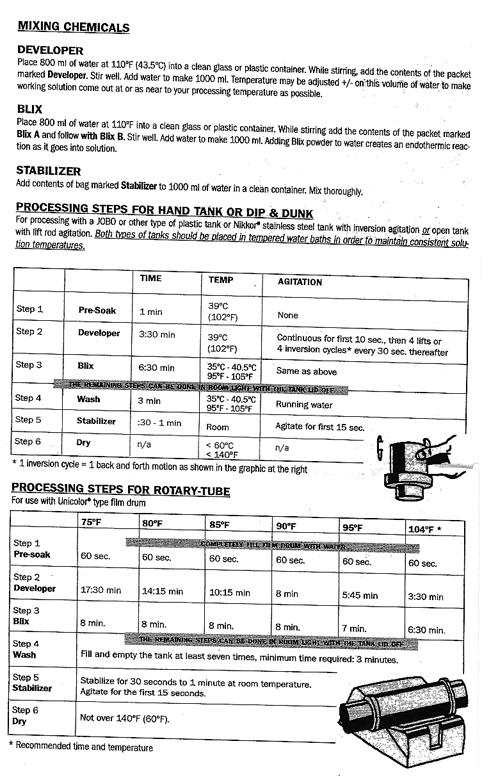

I have a Technal kit that states 103°F. I don't know what Fuji Hunt kit requires. The tolerance is ± .5°F.
Kodak invented the C-41 process and they have always said 100F. That is the official temperature. I would not trust a process that used anything else to give proper results.
The "killer" experiment here is to keep your 103F that you process at 103 then show us your prints over a period of weeks in the gallery but say nothing and see if anyone notices a problem with them and if they do how many mention that your processing temp was 3 degrees F too high
Kodak says, I think, that the tolerance for temperature is plus or minus about 0.4 F so 103 F is way over and should be noticeable I'd have thought but is it?
I remain intrigued about the famous 100F :smile:
pentaxuser
If nobody says anything that doesn't mean a difference isn't there, and scans and internet reproductions cannot be trusted to judge technical quality.
One could run a better test by doing a side-by-side comparison between the standard and non-standard results or better yet judging the quality of a gray scale, and see if any differences are acceptable to them.
Temperature can make quite a difference with color developers, as I personally have observed, and for someone to say 103F is the correct temperature for C-41 must be challenged.
I'm guessing that the 103F recommendation from Tetenal reflects the fact that many users are working in a home environment rather than a commercial environment, and many home environments mean there will be some downward temperature drift. A 103F starting point may be an effective way of dealing with temperature drift.
