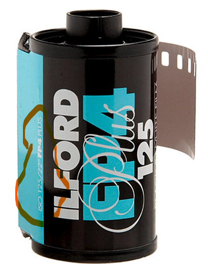

No film manufacturer uses, or has adopted the ISO standard that I am aware of.
Kodak and Ilford and Fuji don't count?
For example:
I'm not aware of any current film that isn't using the ISO nomenclature on their current data sheets.
For example:
The mention of ISO on their datasheets does not prove their adaptation of the ISO rating of their film stock!
ASA is the standard of which film sensitivity is rated, with zero reason to change.
ISO has replaced ASA when it comes to film sensitivity (in 1991 I believe).
The American Standards Association no longer has any involvement in the film speed standard, even if the organization that took over responsibility, the organization responsible for ISO standards, originally adopted the ASA standard and DIN standard as the combined ISO standard, using the ASA numbering.
Show me a film emulsion that is ISO rated.
ALL OF THEM.
Every single datasheet says "ISO <X>/Y°" where X is a linear value and Y is a logarithmic, with the log being offset by 3° for each stop.
It is true that the ASA scale translates 1:1 for the ISO arithmetic scale, but the ASA log scale (which was dropped) is different, in that it uses +1° for each stop.
ALL OF THEM.
With the exception of the Ilford and Kodak 3200 offerings, which are intentionally referred to with non-ISO nomenclature.
There is a reference though in the materials for them that relates their effective ISO speed.

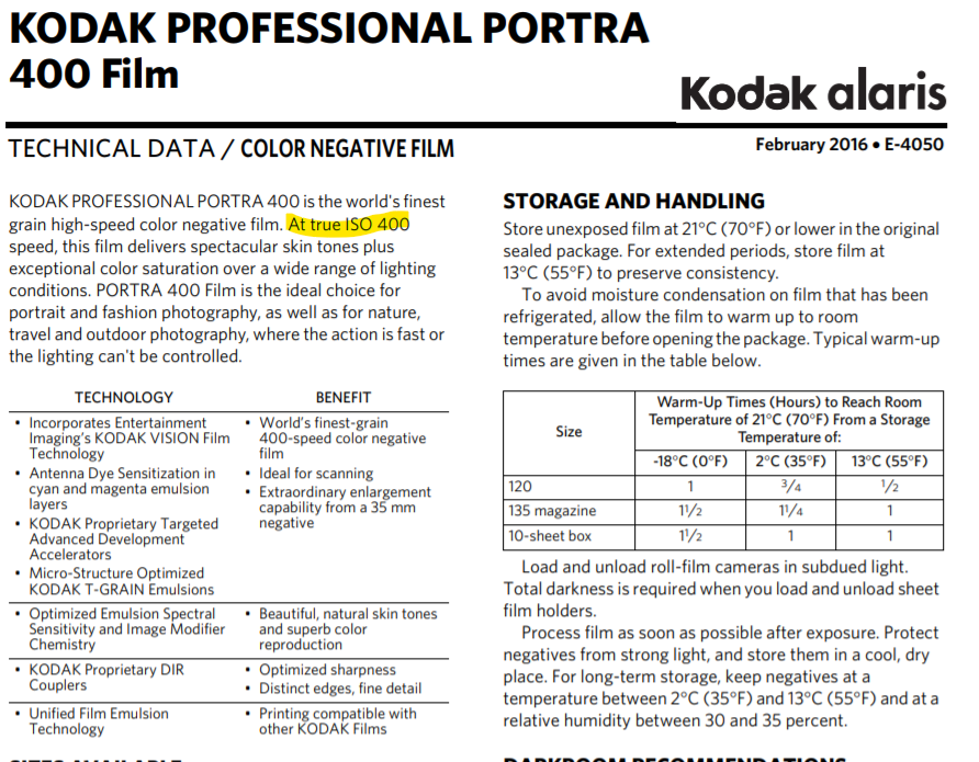

Actually, Kodak refers to an actual ISO film speed rating in the data sheet: ISO 1000... then they round down to 800 for another processing regime and market up to 3200 under very specific conditions.
“The nominal speed is EI 1000 when the film is processed in KODAK PROFESSIONAL T-MAX Developer or KODAK PROFESSIONAL T-MAX RS Developer and Replenisher, or EI 800 when it is processed in other KODAK black-and-white developers. It was determined in a manner published in ISO standards. For ease in calculating exposure and for consistency with the commonly used scale of film-speed numbers, the nominal speed has been rounded to EI 800.”
https://imaging.kodakalaris.com/sites/prod/files/files/products/F4001.pdf
Until I see ISO on a film canister, my info stands as valid.

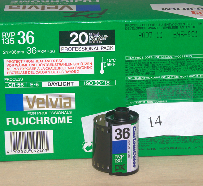

Some 2007 dated Fuji:
CustomColor was the combined lab and store that sold it with processing included.

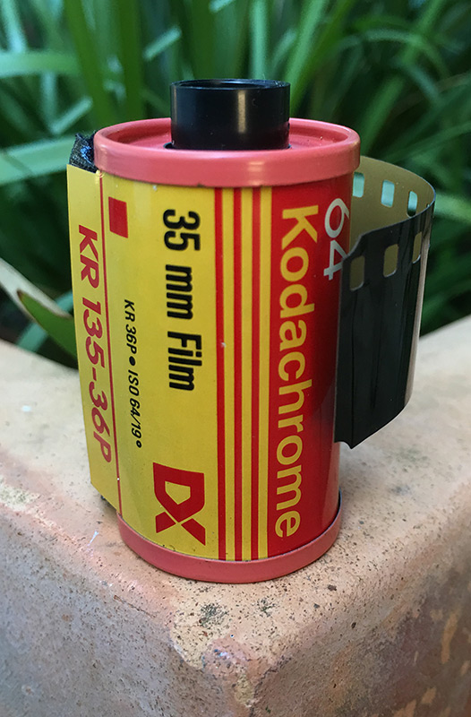

You won't see ISO on any Kodak film cassettes that I can find an image of - but you also won't be likely to see ASA or DIN on any cassettes from the era that predated the ISO standard. Kodak just put 32, or 125 or 400 or whatever applied on the film itself - no letters attached.
Note the lack of any ASA or DIN reference on a Kodachrome 64 cassette:
kodachrome-64-film-roll-picture-id458720391
And then, into the 1990s, we have ISO showing with (Australian?) Kodachrome:
