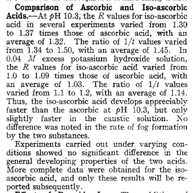

In basically all of the published Patents and MSDS's the isoascorbate vesrion or the isoascorbic acid is mentioned. There is a paper mentioning that isoascorbate is faster acting then ascobate. https://pubs.acs.org/doi/pdf/10.1021/ja01229a026

The above mentioned Paper sates there is a difference in acitvity at a pH of 10.3 yet none observed in more caustic enviroments.
My main Question is mostly: Is this difference neglactable. And the main reason the Iso product is used in commercial developers is the lower price, while the higher activity is mostly a a welcome side effect. Or is it integral for Formulas like XTOL, Wich Im trying to mix myself from raw, according to the Patent.

This is btw. the part of the paper mentioned above, that compares the activity of the two forms

Tbh I don't think the paper linked in the OP is actually all that relevant, as they are testing the developing properties of ascorbate/isoascorbate in isolation, not as a superadditive mixture with a phenidone-type developer, as in Xtol. Also the working pH is very different (~8 vs ~10).
You'll notice in the patent they also list several formulations which exclusively use ascorbic acid, but the described testing is all done with the dry isoascorbate formulation. I suspect the reason for this is that in practice it makes little or no difference which is used in this case.

my though also was, that if one can't see any differece, then the superadditive effects may oversaddow the differenece in isolated activity. Also this might be a hint that the main development comes from the Dimezone, and the ascorbate 'recharges' the phenidone. Even though the XTOL patent says that they believed the ascorbate to be the main developing agent
Yes, the superadditivity is no doubt key.
