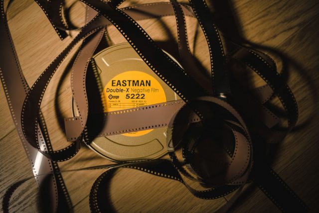

There's a pretty extensive thread on 5222 on rff: 5222 thread

Haven't shot any 5222, but Kodak disagrees for both granularity and resolution. TMY2 is superior.
Guess it’s going to be a matter of taste then, a question of whether the grain is more pleasing to me.
I have some limited confirmation bias that skin and wood look good on 5222 because a print of my daughter in a forested setting is pleasing to me. It was 120 Cinestill Double-X so not a confirmation that I am happy with it as a replacement for TMY2 in 35mm yet.
It is never hard to find examples where people look good on 5222 for example:
I suspect it's a nice, middle of the road film that could serve as a general purpose BW film. But this could be a weak point; not very good at anything. I've been tempted to try it in the past, but there wasn't much of a price advantage compared to other mainstream films.

Thanks for the link, Bill. That guy (Matt Osborne) sure makes 5222 look good. I notice he often rates it higher than ISO 200, and also, he likes Xtol, usually at 1+3. I also noticed many of those portraits appear to be studio shots, and the outdoor shots seem to be taken more under cloudy skies / subdued light. Whether I will like it as much in the contrasty daylight conditions I often find myself in, I will soon find out.
I took notice when Jarin Blaschke came to Photrio to ask about a filter that would make Double-X look orthochromatic for “The Lighthouse”.

An interesting read is Bill Burk's link with examples but what is the evidence for this quote: "Kodak recommend rating Double-X at ISO 200 in daylight but I have shot it at anything from ISO 100-1600 (I think) and still received great results. I feel it is much better in low light than Kodak Tri-X 400 film or Kodak T-Max 400 film and believe it should have a native ISO closer to ISO 640."
Also just a pity that from the myriad of fashion shots there weren't three of the same scene, model, clothes etc on the same day
at the same time or lighting conditions
640 is quite a jump from Kodak's 200. I wonder what his evidence is? I always get a little concerned when a review finds nothing to be critical of and almost everything to praise
I wonder who commissioned him write the review. It just doesn't sound as if either the commissioning agent or commissioned agent were entirely disinterested parties
I need to say also to avoid direct conflict arising that there is nothing wrong with the film and yes it much cheaper if you are prepared to buy 400ft and bulk load. It was just that the review reminded me of so may others whose conclusions always seems to be "it's the greatest thing since sliced bread" in respect of whatever it was that was reviewed

XTOL does provide a film speed boost.
I don't think bloggers and YouTube reviewers have much credibility. Here, Matt Osborne (aka MrLeica) says he "believes" Kodak Double-X should have "a native ISO of 640" even though Kodak rates it at EI 250 in daylight (he erroneously says "ISO 200"). How did he come to his belief? It is anyone's guess. He also says he gets "great results" with Double-X "from 100-1600 (I think)." So he thinks, but is not sure, that he shot it at those "ISOs". And who knows what "great results" even means. He then posts a bunch of mostly "glamour" shots exposed at who knows what EI, developed in who knows what developer, scanned, and edited with who knows what adjustments in post. So, all and all, a completely useless review. With a shameless plug for Cinestill at the end.
It you want to know anything about Double-X, shoot a few rolls yourself at different EIs and, if you are so inclined, develop them in different developers. Then you will have some worthwhile information.
I don't think bloggers and YouTube reviewers have much credibility. Here, Matt Osborne (aka MrLeica) says he "believes" Kodak Double-X should have "a native ISO of 640" even though Kodak rates it at EI 250 in daylight (he erroneously says "ISO 200"). How did he come to his belief? It is anyone's guess. He also says he gets "great results" with Double-X "from 100-1600 (I think)." So he thinks, but is not sure, that he shot it at those "ISOs". And who knows what "great results" even means. He then posts a bunch of mostly "glamour" shots exposed at who knows what EI, developed in who knows what developer, scanned with an V800, and edited with who knows what adjustments in post.
Yep, his scans are edited to death. I agree with @faberryman, I would ignore.
