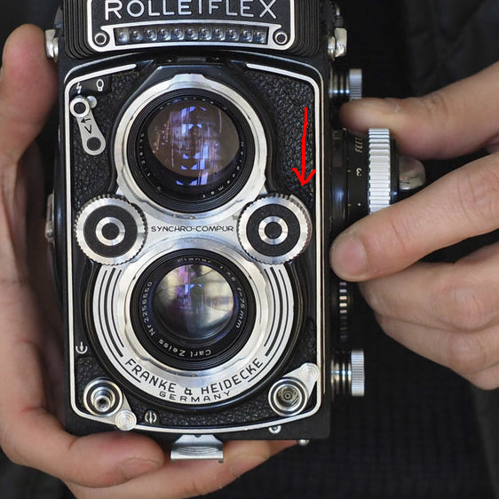

All of this Rollei talk made me go out and shoot my 3.5f and 2.8f together. My only complaint is the EV interlock on the 3.5f.
I thought the interlock was dropped on all the F models. Am I wrong?
There are some that have a 'secret' interlock. No EV scale and numbers like on the E. But on the rim of the aperture dial is a silver rim, similar to the lock on the 2.8C dials. This is the interlock release. I think it is what ags2mikon means? It sucks. Also it is not difficult to kill from the backside once the shroud is off.
According to my serial number it is a first series 3.5F. I used the Rolleigraphy site. That is as far as I looked.
It sucks! Yes it does. How is it killed?
Once you see the backside it should be come clear as you play with the mechanism. I think that it is a spring tab that slides in to lock the coupling.
