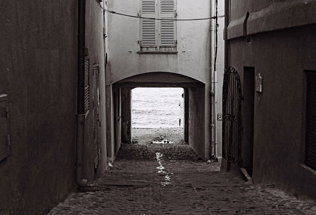

No, not what I'm getting from TRIX prints.

This is what I typically get from TriX:
and
