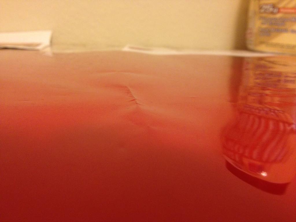

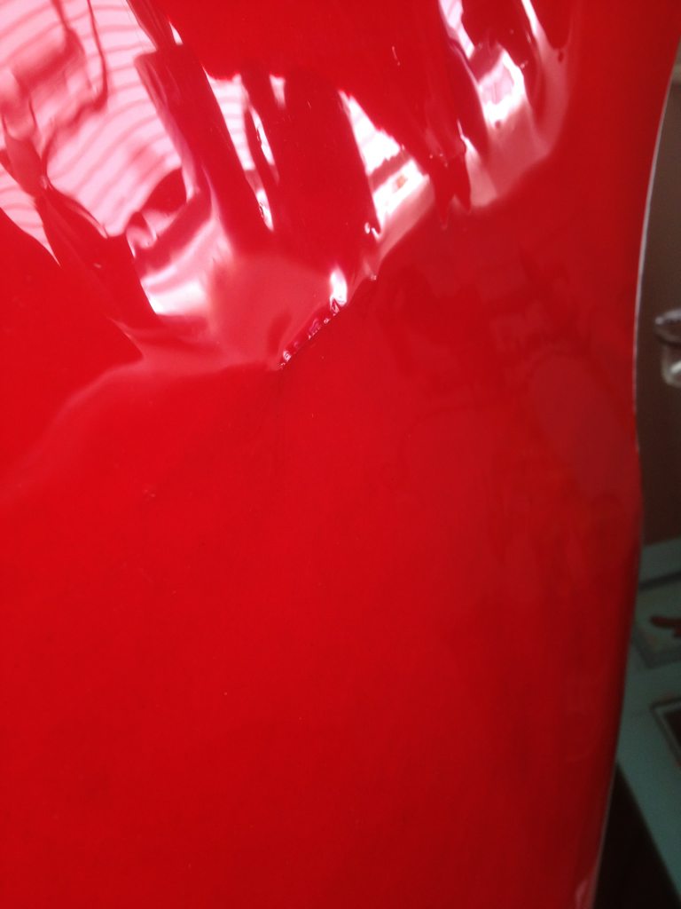

I ordered a 20x24 sheet of Rosco Fire #19 to repair the filters in my Thomas Duplex.
I just opened the box from B&H, and this is what I find. The entire filter looks like it was pressed between two nail beds, and there's a big crease in the middle. I can't photograph the spots, but it looks like someone went around the whole sheet with nails and made indentations with the point of the nail. There's no holes though.
Is it worth returning? Will the crease or dots affect the light?
I assume not, but want to be sure.

Usually comes out smooth, after being rolled in a mailing tube when we buy it straight from theatrical wholesalers
Rosco, Lee or GAM can all be creased if folded tightly. It does not affect the transmissivity of the wavelength in any substantial manner.
You are not trying to take picture through it, though. It is just to filter broad spectrum and emit only the specified red frequncies. I acknowledge that freqeuncy is not quite the right word to use here.

I'll just use it then. It'll cost me more to return it. Thanks Mike.

No, that's not right. It appears damaged. I got mine from the Pacific Northwest Theatrical Association. It came in a mailing tube. There were no cracks or creases, and no indentations. Not even any fingerprints.
I would think that if the material has not actually been penetrated, it should be OK. But given the smallish size of the filter material needed, I might just try to trim from around the imperfections, if possible. Just to be safe.

I figured I'd try to cut an edge along the crease if I needed.

Damaged goods. You should be able to send it back for free if you documented the problem when you opened the package.
Depending on how you intend to use it, the gel might be okay. If I was using this on a stage in a spotlight, I am pretty sure it would burn through prematurely. Gel has to lay flat in the holder in order to resist the heat. Air flow is key in that application. In a regular light fixture with glass to shield it from heat it might be all right.
The decision is yours but, if it was me, I'd send it back.

It was $6.95/sheet.
It would cost me more to drive to the post office. As long as it will function properly in the safelight, that's all I'm worried about.
I'll cut around this crease and avoid using it between the glass plates.

Question for you: Is the tissue paper backing also creased and pocked?
If so, that indicates to me that somebody tossed that sheet into a pile of junk on a table then stacked other junk on top of it. I see this, occasionally, at the theater where I work. It is a movie theater and a legitimate, stage theater. We use Rosco gel in the spotlights. When the gel gets tossed into a pile, this occasionally happens.
We keep scraps of gel and crinkled up pieces for use in small, non-critical projects but we won't use them for big shows. They'll often burn through. When they do, it is always when it is least convenient. Like right in the middle of the big finale number.
("Paging Mr. Murphy! Mr. Murphy, please pick up the white courtesy phone!")
Long story short... Somebody probably tossed this gel in a pile, wrinkled it up then stuffed it in a box and sold it to you.
It doesn't matter to me whether you think the goods are fit for your purpose or whether you want to take the time and trouble to send them back but the seller should know that somebody in his Shipping Department is slacking off. I would complain or at least send a note.
